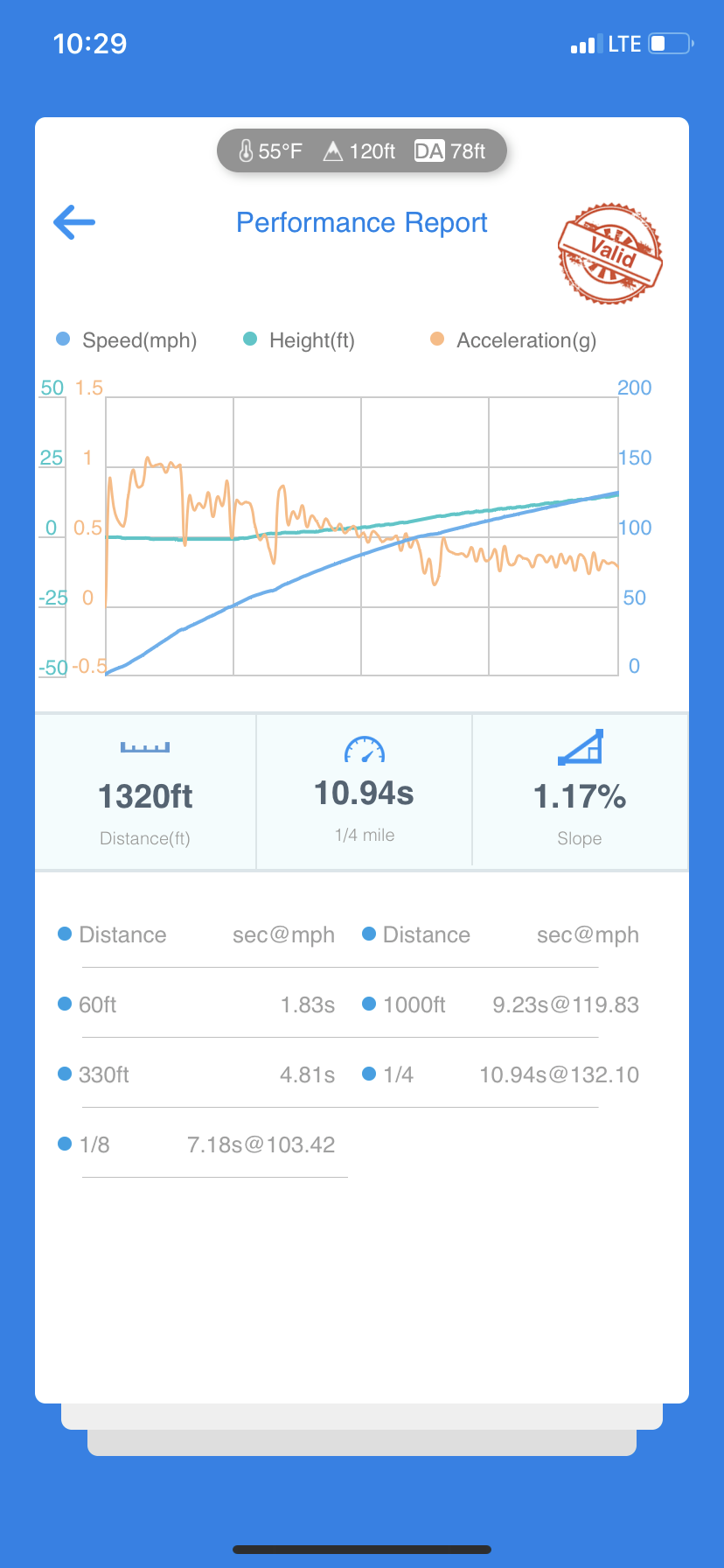

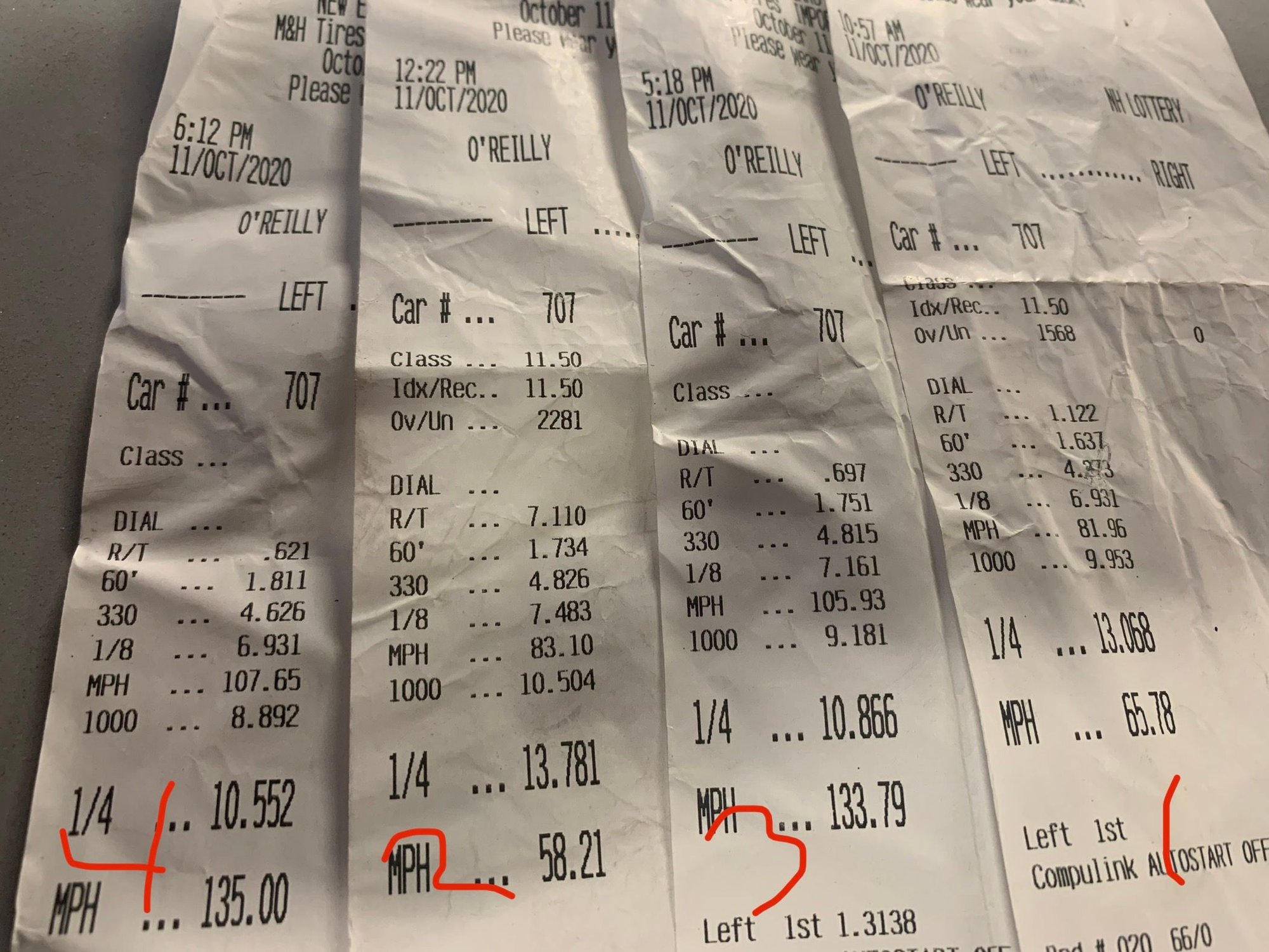

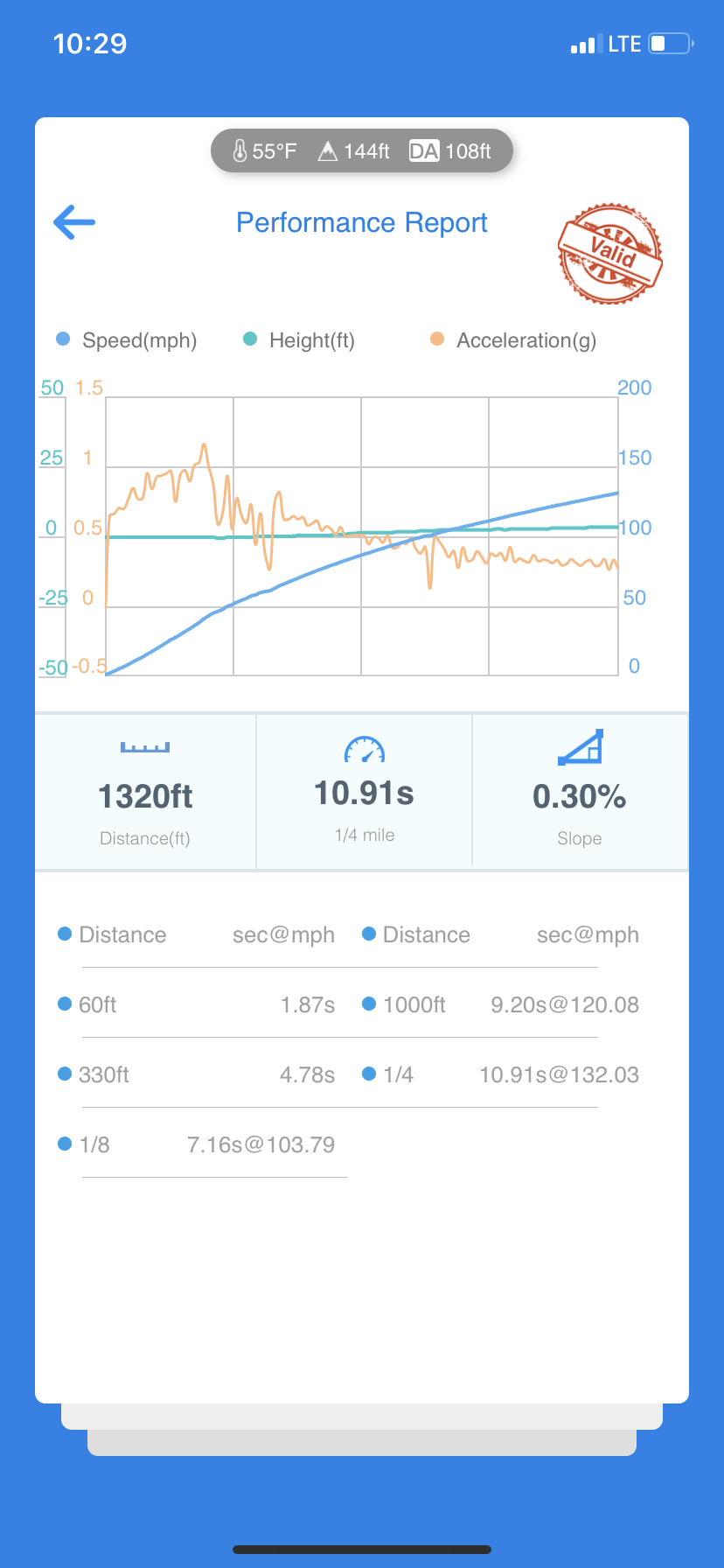

ok first time to track I had a best time of 10.55 @135 with a 3.37 gear. Issue I had was going into 3rd gear it sat on converter until I finished the 1/4mile and I lost my power all that time in 3rd. ignore slip 1&2, practice launches.
so I changed the gear to a 3.54, went back to track again. Now the car came off the converter in 3rd gear and can hear rpm rise above converter before finished 1/4 so that’s good. However, car ran consistently slower somehow.
on bright side, cars very very consistent lol. Times are almost identical.

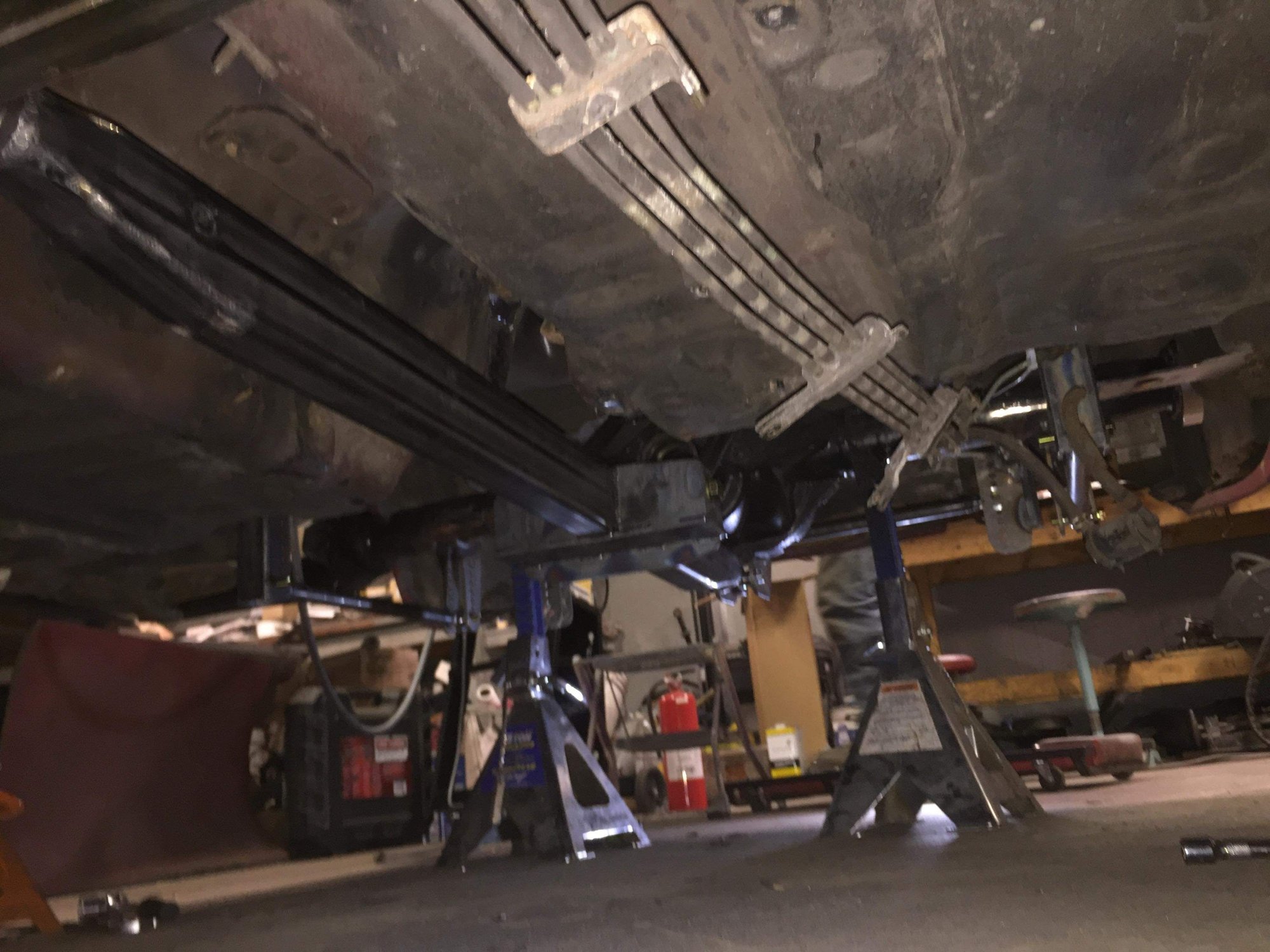

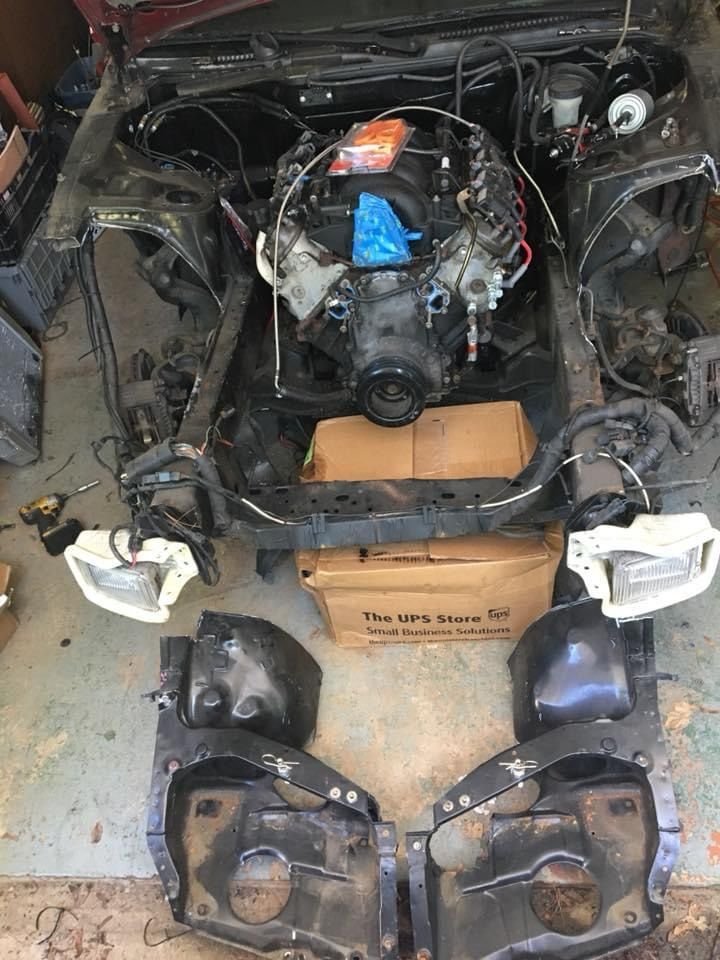

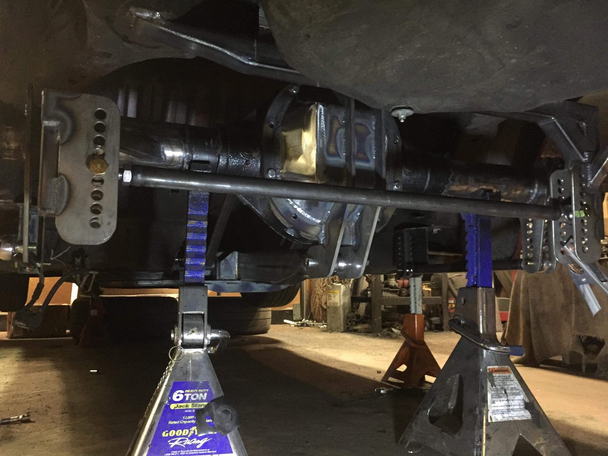

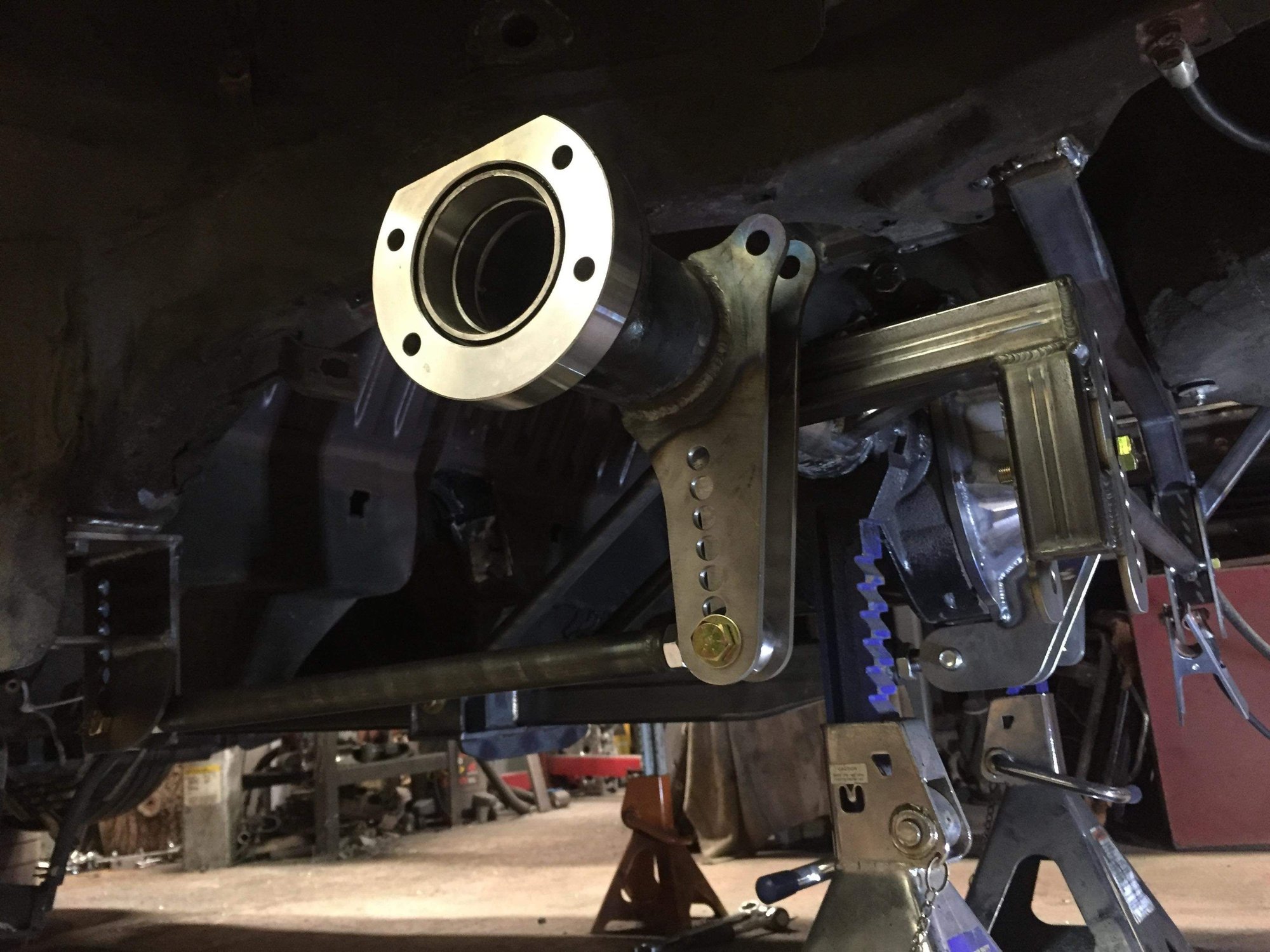

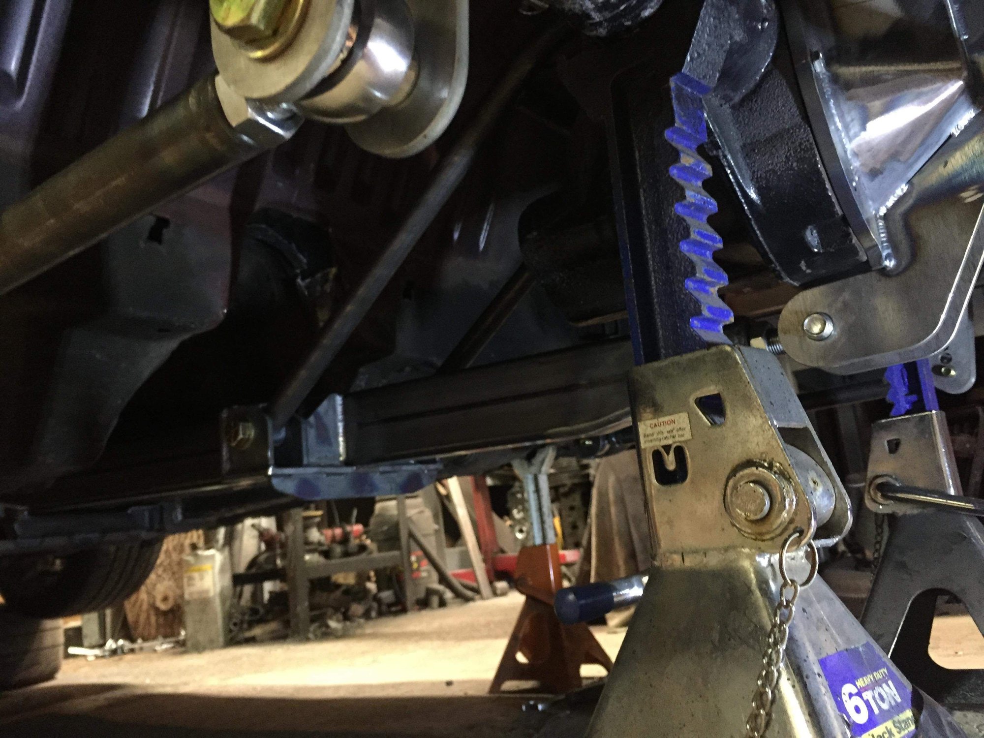

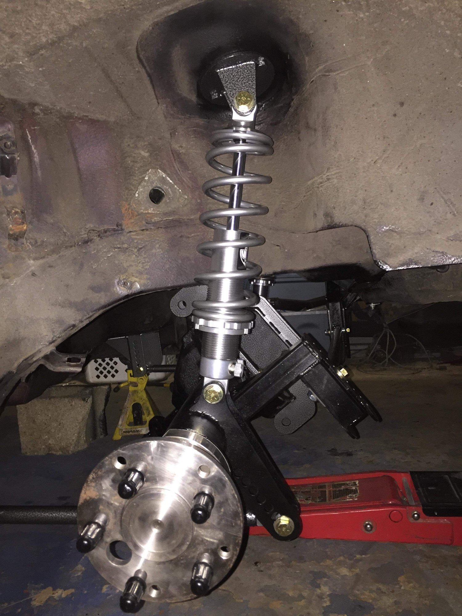

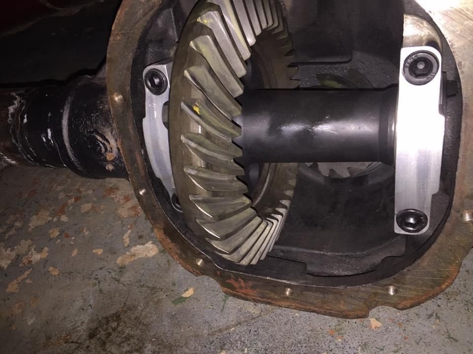

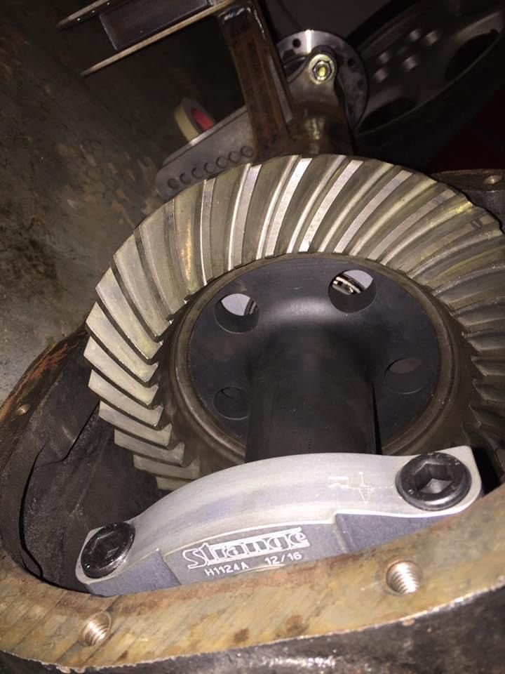

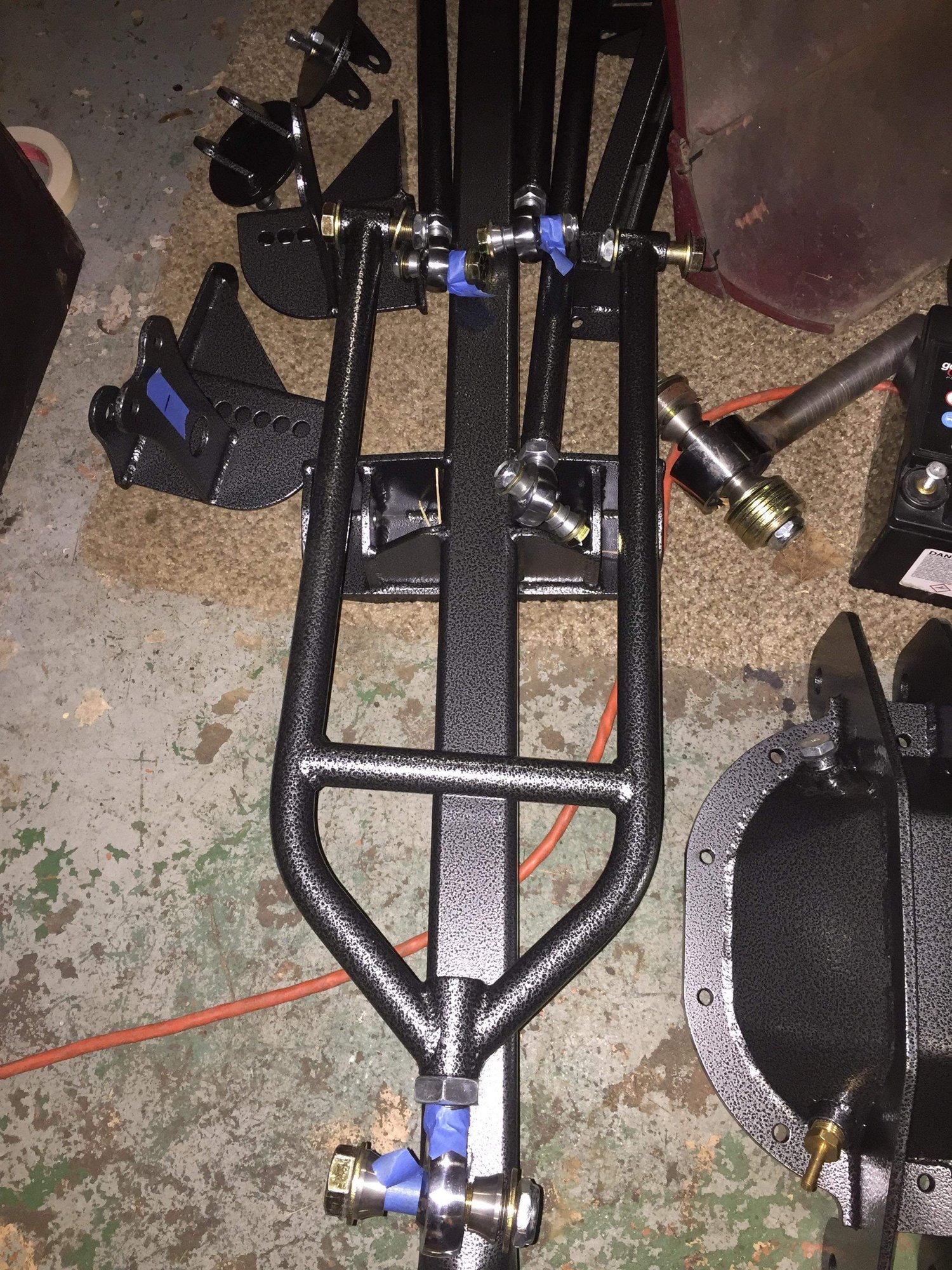

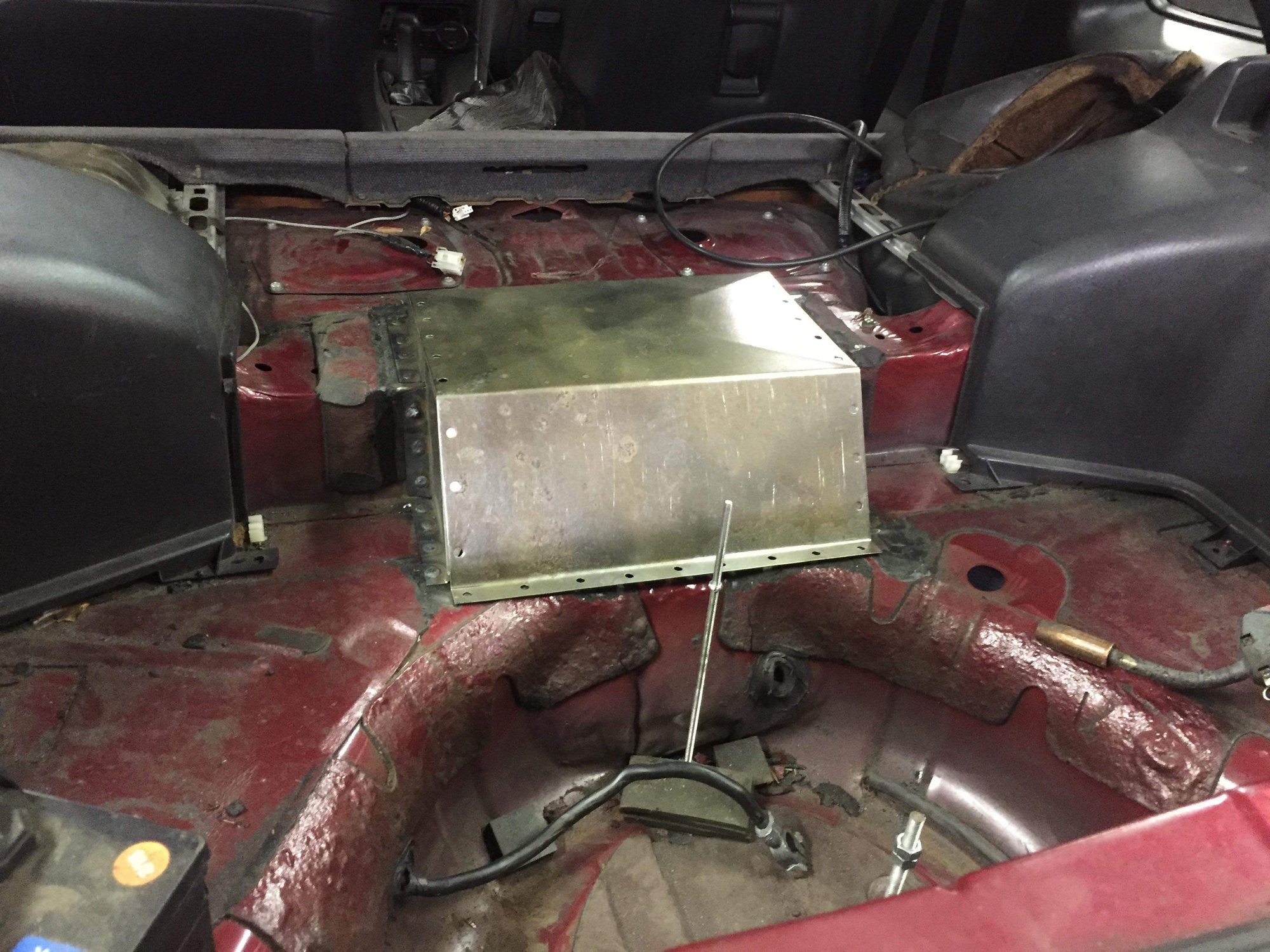

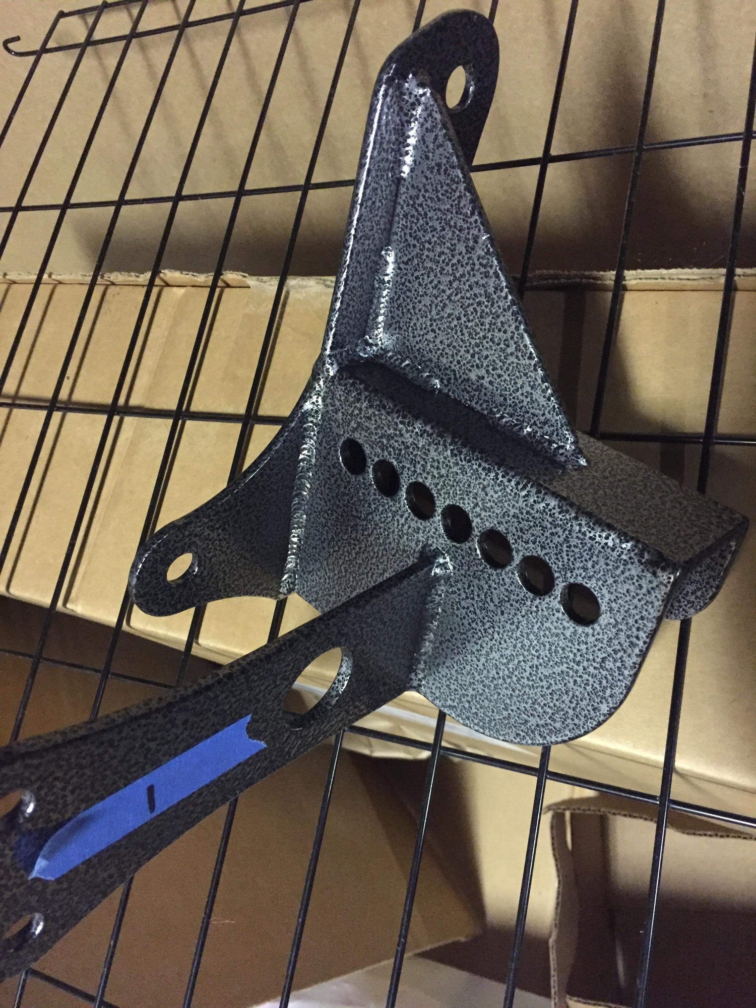

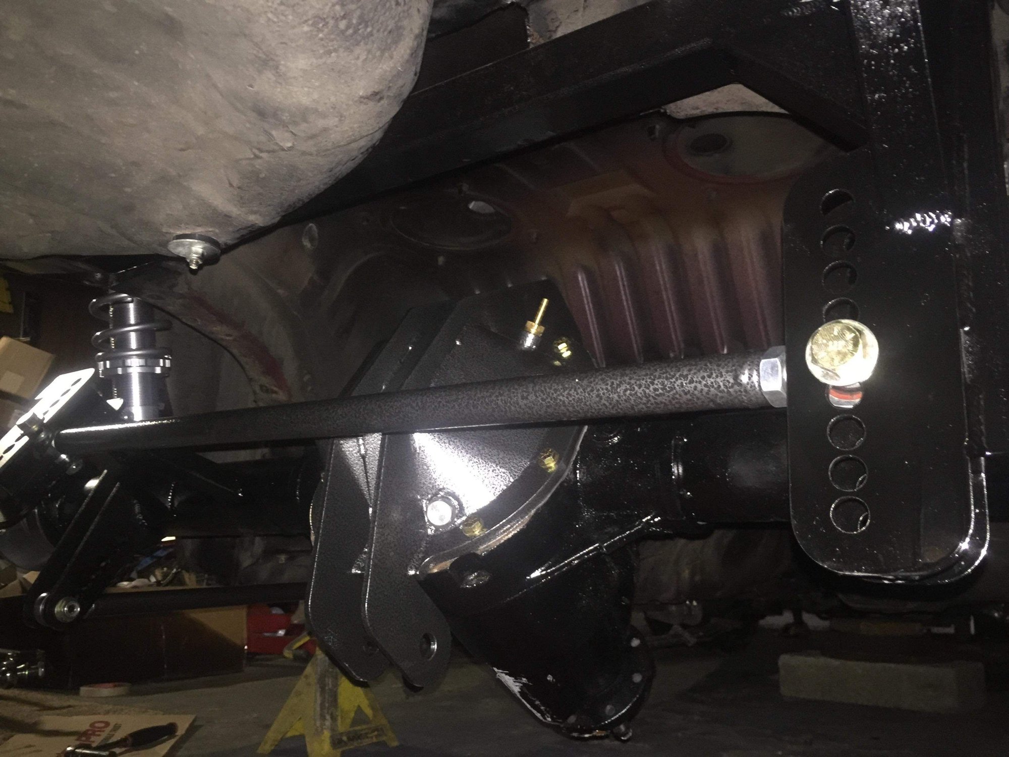

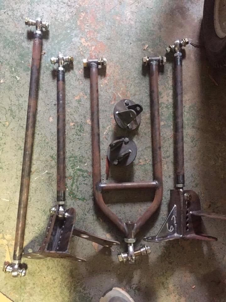

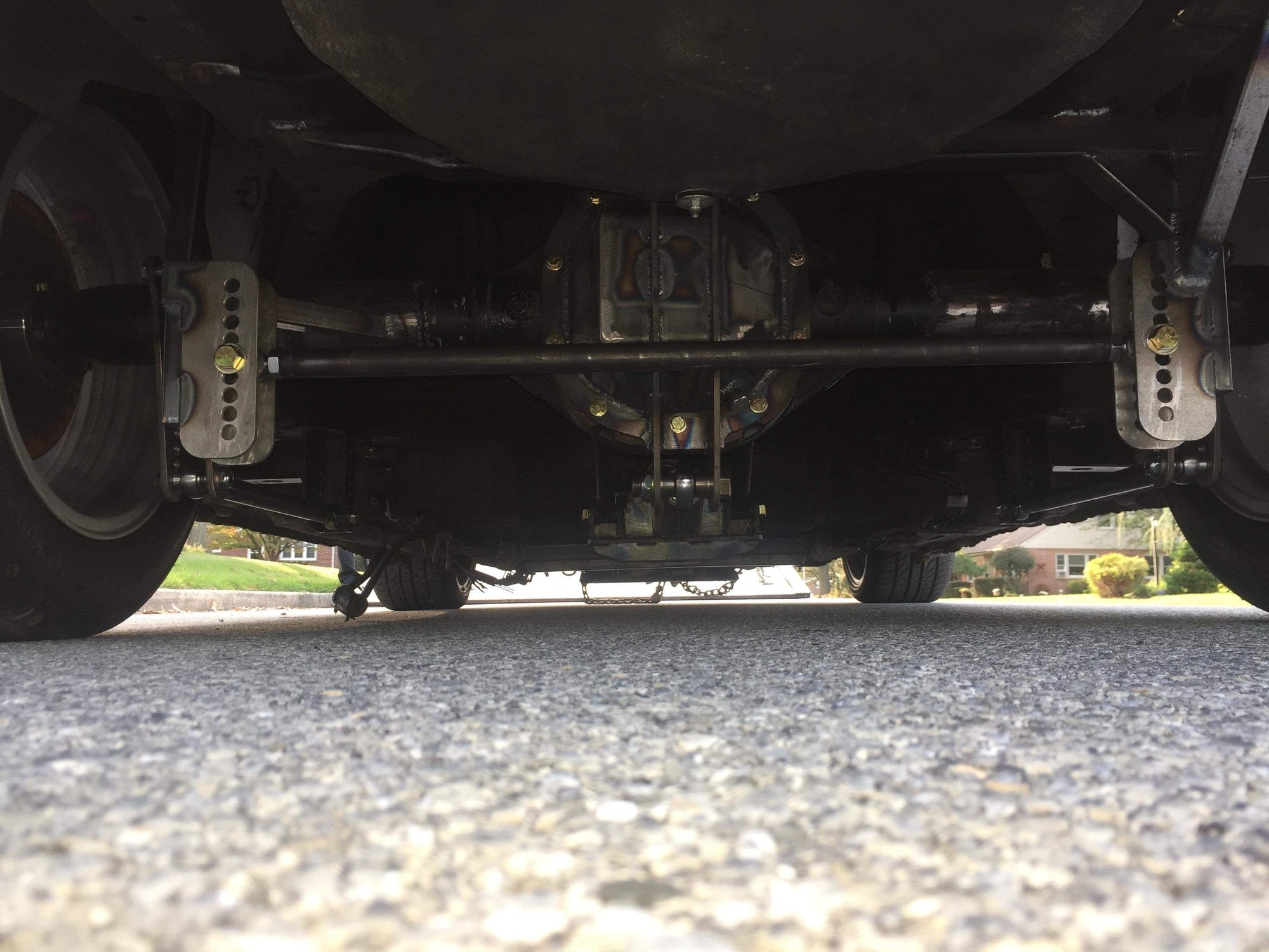

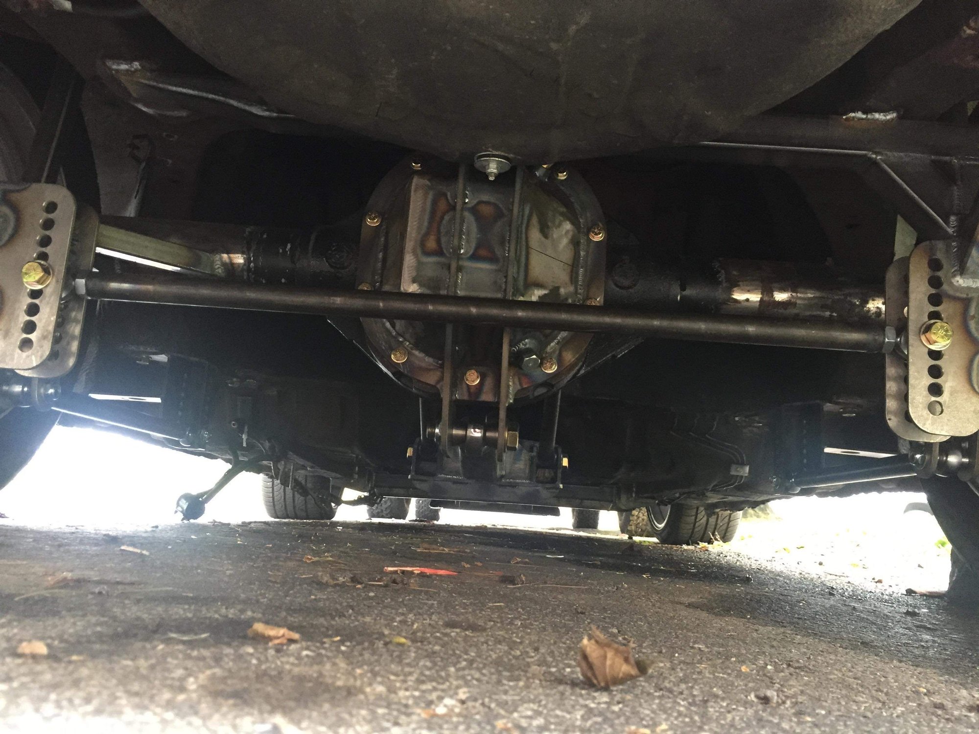

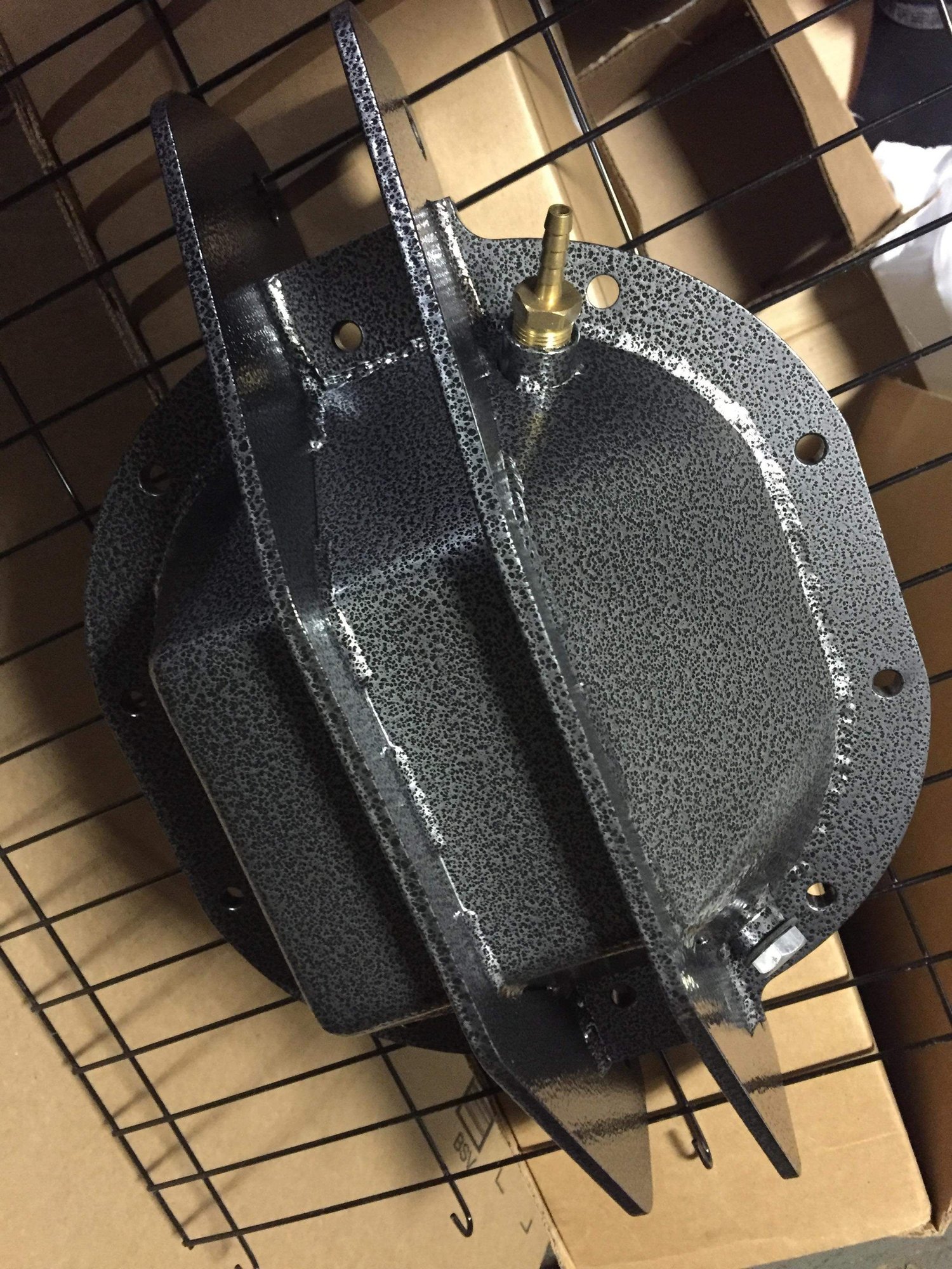

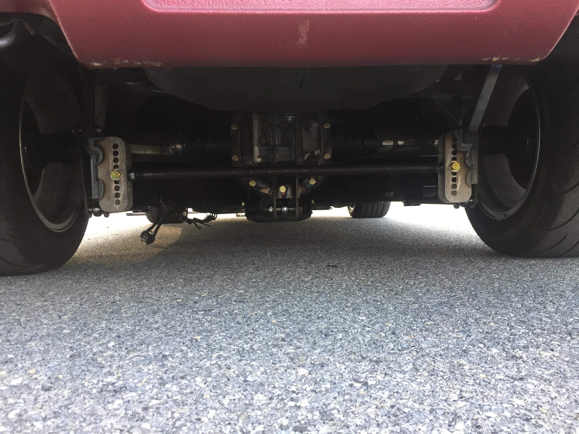

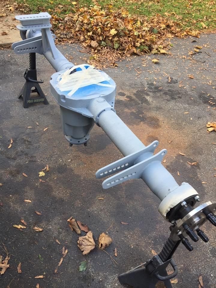

what do you guys think of this setup for a drag car? Using same body car but this one has a solid 8.8 setup for $5000. Not sure if that’s expensive. Essentially just shell with stock lq4, need front tubed/cage but whole rear suspension is done.

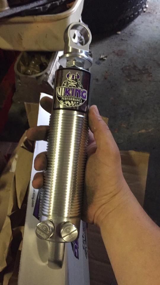

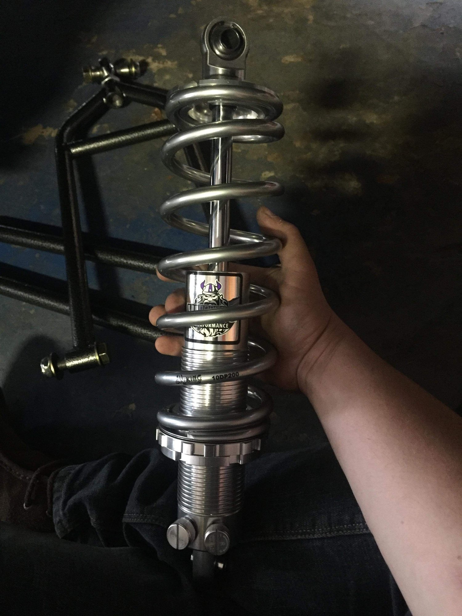

Narrowed 8.8 with 3.27 ford racing gears and a Yukon spool. 31 spline Yukon axles with C clip eliminators. Viking double adjustable coils spec’d by Viking. Trans member setup for th400

.2 is not a big change in gearing. I'm surprised it acted any different honestly. What was it trapping B4? The ET issue is your 60' for sure. You change to an auto to get rid of things like 1.8 60' times. That's pretty terrible for an auto car. Once that's addressed and sorted out it would be a whole new car. Get it in the 1.4x area (not unrealistic at all) you'll drop 8 10th's off your slip! That's 9.7x ET's. As a comparison I was running 1.8 60' times on street radials. A good Tire makes all the difference.
You really need some sort of traction management. Its a ton more work to swap it back to a manual. Buy a good ECU and be done. You'll be light years ahead of where you'd be with a manual on the street and the track with much less breakage and headache. The reason you spin is because it's applying power in a less leniar fashion. You dial that in with boost by speed and traction control and you'll be set.

I can’t take credit for those pictures at end, the 8.8 is actually inside another shell that the person wants 5000 for it. I didn’t know if that’s worth the money.
