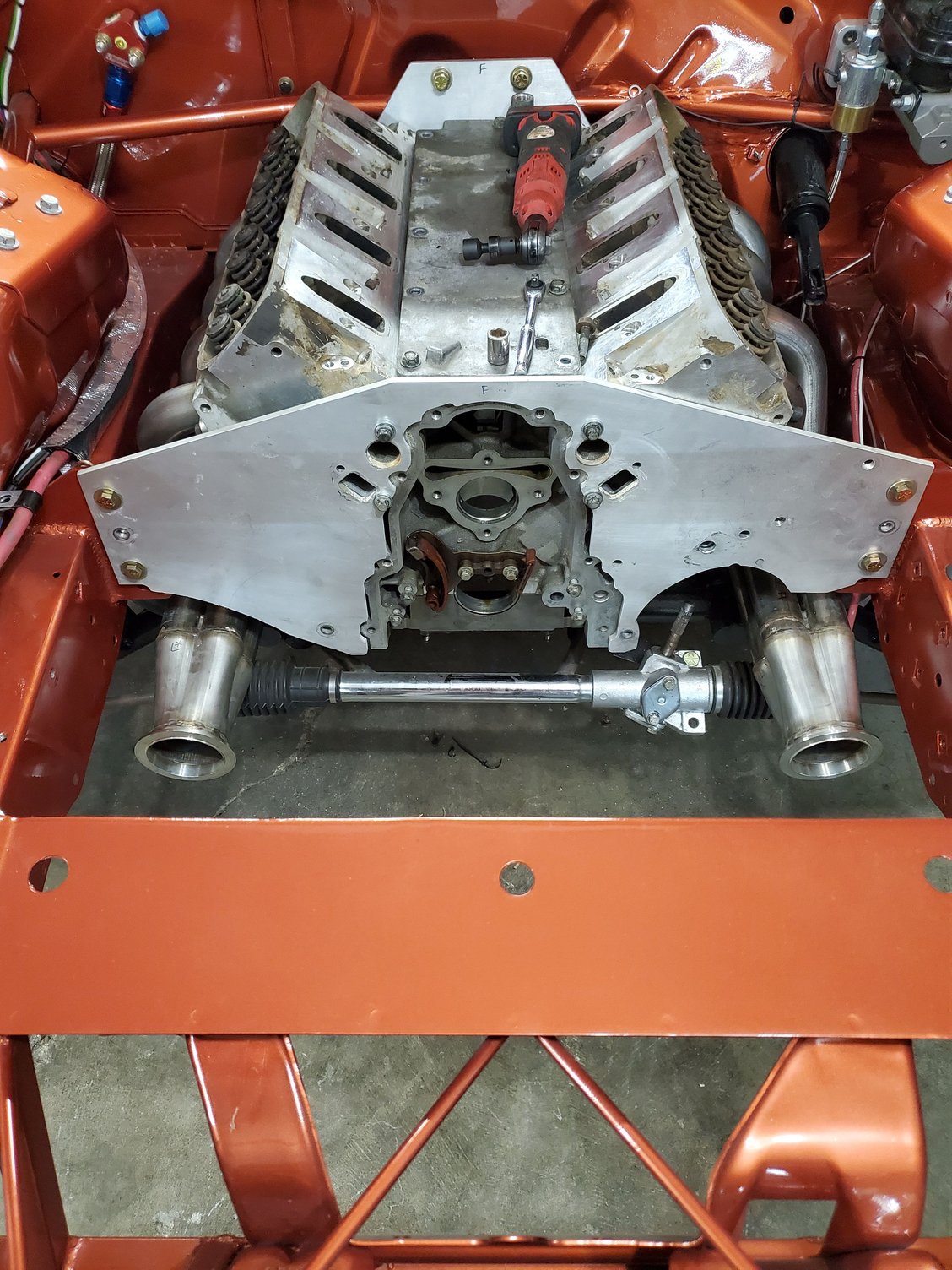

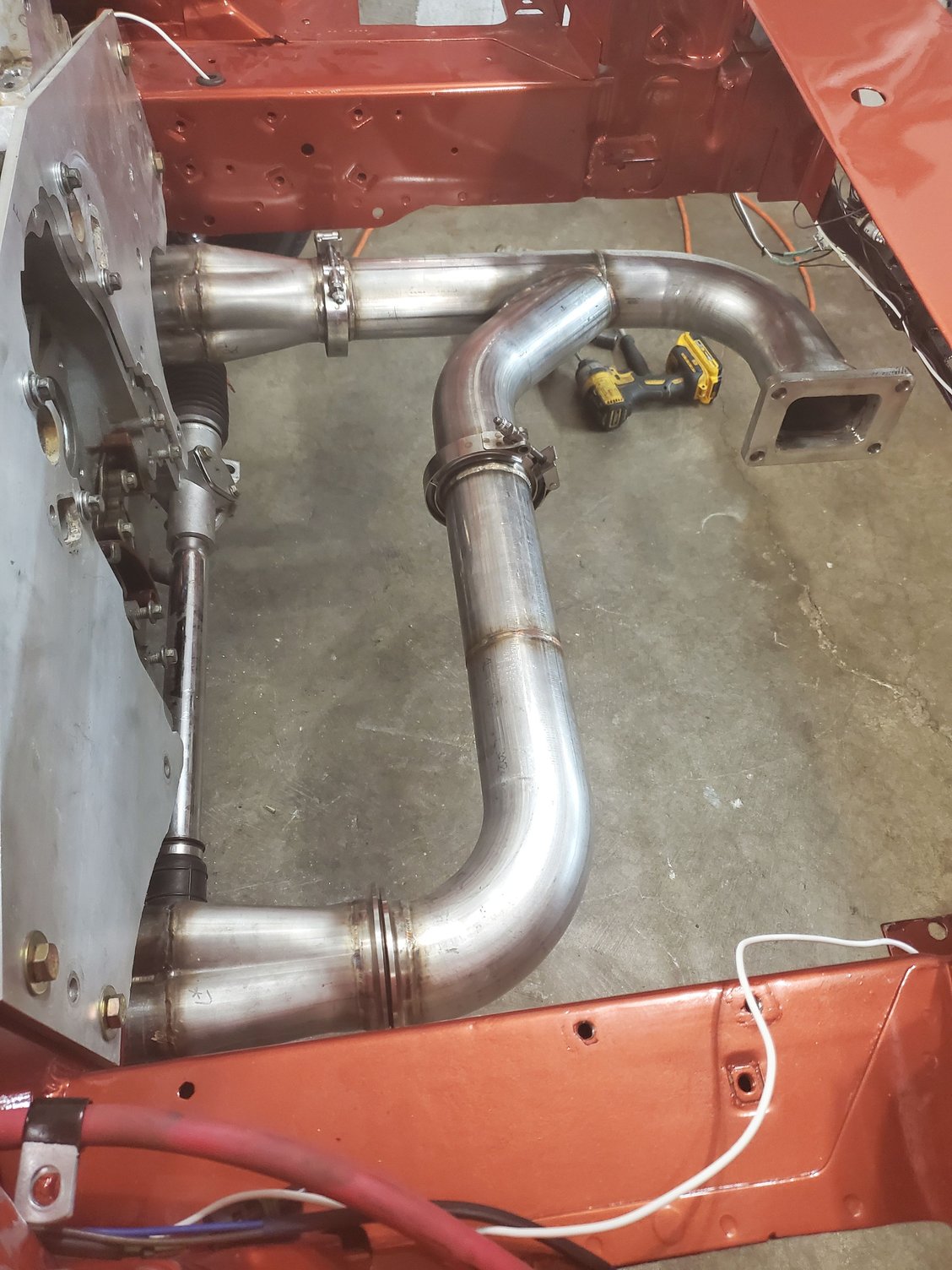

Ok guys I have a
som trans am
416lsx 6bolt motor 9.5to1
Glide 1.80
Precision x275 85mm with 103 wheel
3300 lbs
holley dominator efi
Options for a/r are 1.40 or 1.25
I was thinking twin 50mm bov
And a single 66mm precision gate
Any info is appreciated and why you choose that. added a few pics just for the fun haha

Gate placement it critical. You don't need a 66mm WG to control boost. A 50-60mm would work just fine... Hell a 44mm would probably be fine. Place it right at the end, inline with flow before the 90 bend and you'll be golden IMO.
Go with the larger housing. The only reason to go smaller is for improved response at the cost of more back pressure. You shouldn't have trouble getting that turbo into boost on the brake with that motor. No reason to go with the smaller housing IMO.
