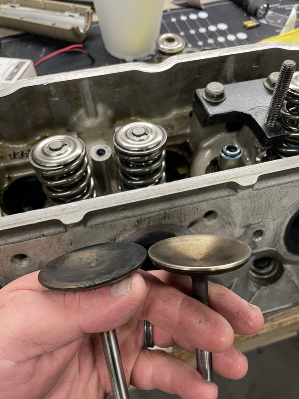

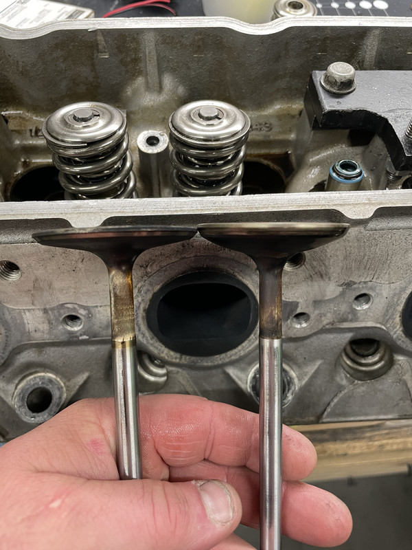

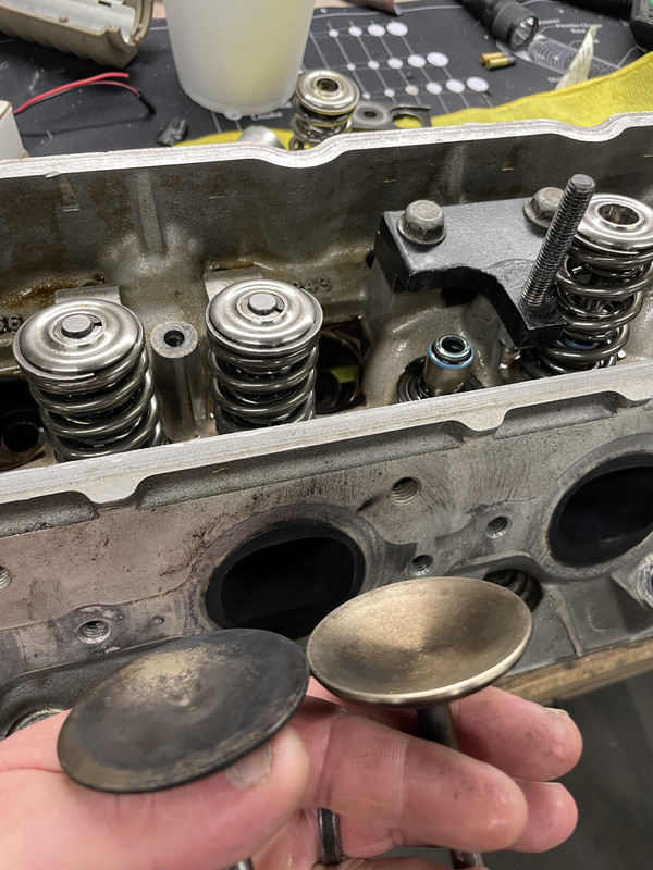

Originally Posted by biketopia
We need pictures!!
oops! I forgot!
you see how it fatter under the head?
I’m sure you can see which one is shaped like a bowl. Yea it was cylinder 7 too. Of course, it sees more heat.
