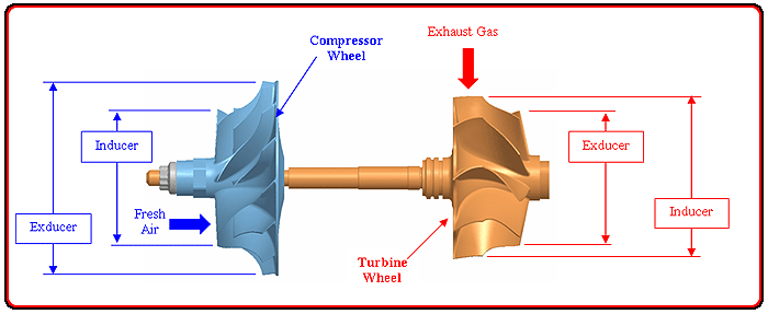

What does the turbine specification 96/88 portray? In other turbos , say the PT7675, it's a 76mm compressor wheel and a 75mm turbine wheel. With that VS80 it's essentially a 80mm compressor and a 88mm turbine, is it not? What does that 96/88 turbine designation imply and why is it noteworthy ?
I actually have the T6 1.32 A/R slip-fit race cover version of that VS80. I'm installing it this Winter.
96/88 is turbine inducer/exducer

hope this helps

Thank you sir! I'm a visual person and that was perfect.
