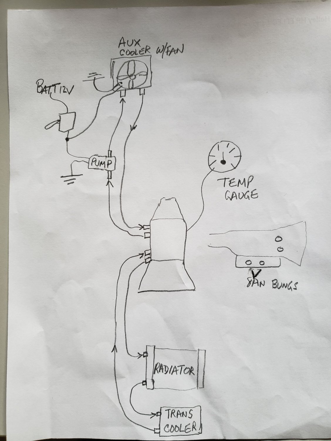

Adam, I'll just go ahead and post here what I sent you.
This is how I had it set up in the Mustang.
I put 2 8AN male bungs in the pan and ran 8AN Parker pushlok to the pump, aux cooler and back to the pan. I used the big eBay 30-row cooler that has 10AN in/out and thought about running 10AN but my pan had ribs that made it hard to weld in the 10AN bungs. The pump and fan are powered together with a manual switch (batt +) in the dash.
Soon as I hit the return road, I turn on the pump/fan. After I park and shut the engine off, I leave the pump/fan on for about 5mins. I then start the engine and run it for about 30secs to circulate the tranny fluid out of the converter, shut the engine off and let the pump/fan run for a couple more minutes. How long you run the pump/fan on with the engine off will depend on your battery reserve, so keep an eye on that and don't forget to turn it off, LOL.
In the staging lanes, I never leave the engine idling. I wait for a 3 or 4 car gap, move up then shut then down. I like to have the tranny temp in the 140s as I roll into the burnout box as the temps rise fast by the time you do a burnout and let the t-brake go.

Was hoping to simplify and just use 1 of the 2 fluid cooling methods. But I'm not comfortable running the lines looped now I guess, and I don't want to overcomplicate a simple build. Space is also a premium on this chassis. To keep it easy, I'll just run a standard cooler circuit I guess. How boring!

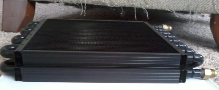

My last setup was the large 10x14.5 derale duel core cooler with a very high velocity ducted fan on it. It was less than impressive. I'd start around 100* and be at 210-220 depending on ambient temps by the end of the run. Car built launch boost in 1.5 seconds or so... That's with the deep pan glide setup. Same trans is going in my new car.
My biggest gripe was it wouldn't pull the heat rapidly at idle... Not at all. I could sit at idle for 10 minutes and it wouldn't get below 170... So I ended up letting the car sit for long periods before runs. Which is a bummer when your being squeezed in as Time only during an event and you miss out on several passes.
I feel if I could run a larger/better cooler with larger lines and circulate the fluid with a fan with the car off, it would cool the fluid MUCH faster. I'm pretty confident it would work well... Just can't reinvent the wheel at the moment. And if it didn't I'd have to go back and redo it all! So I can't chance it at the moment.
This Derale cooler could just be junk as well.
