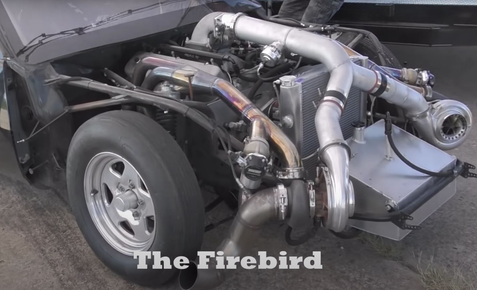

If someone's already setup for a single, they seem worth a try IMO. I Agree though, hard to beat twins these days.
We have a local named Ryan Mitchell that basically just takes everyone's money here. (all over the mid west really) Runs VSR S480s on a basic non-intercooled BBC. Gaps cars with 5x the money in them.
https://www.xtrhorsepower.com/kc-max...out-in-kansas/

haha ya that car makes a lot of money!! I thought he had upgraded the turbos since those 80's?

Same car right? (the guy who wins it)

Wastegates cost more than the turbo...

Its fine when you save money on an intercooler
