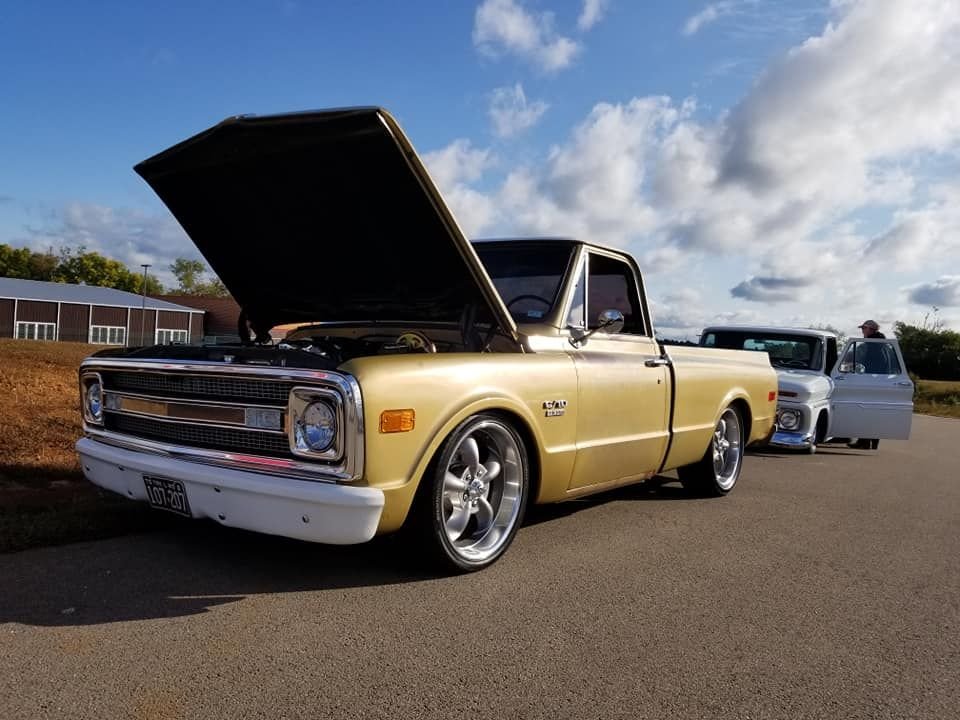

Since then, we have been manufacturing these and have shipped all over the globe as well as be able to add to our product line up with accessories, add-ons and both cathedral and square port designs. These adapters are set up off of truck spacing with minor changes needed to the factory truck style accessories. We are also able to machine the snout of the blower to fit other accessory drives as well. We have yet to push these hard but I can tell you our "test mule", 1970 C10 with a junkyard 5.3 has been running excellent for about a year now at 9lbs of boost and 550+ horsepower with plenty of room to grow.

Here are a couple pics of it installed on the C10 using a DBC TB.
