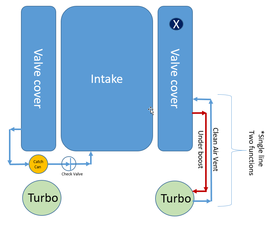

agree with Rich. To the OP: How do you have your catch can setup? Where is it connected? Which model is it?

There's a couple of things to consider that will affect the performance of your crankcase ventilation system.
If the line going to the can for ventilation comes off a valve cover with no baffle or is located at the back of the valve cover it will suck more oil.
If the engine has wider ring gaps and as a result experiences more positive crank case pressure it can fill the can faster.
If the engine has an insufficiently sized breather system, it will fill the can faster as well as blow seals and dipstick tubes.
Using a large breather line (or two) to the can (or cans) is always a good idea, a -12 off the front of the valve cover gave me plenty of flow and kept oil out of the line during hard acceleration.
The only thing I ever drained from my can was water that smelled like fuel, this was using pump gas only, no E85.
This was using a PCV style vent can as well so it kept the inside of the engine nice and clean, two oil changes a year probably helped with that too lol.

Hi thanks all for the feedback. To clarify, the following is my setup. They are GM performance valve covers that are baffled.
I recall now that the line to the Turbo inlet was not present during the dyno time. The oil cap (X) in fact blew off during the session.

Thoughts critiques?
Perhaps I pushed it all during the dyno session when the turbo vent line was not hooked up.
