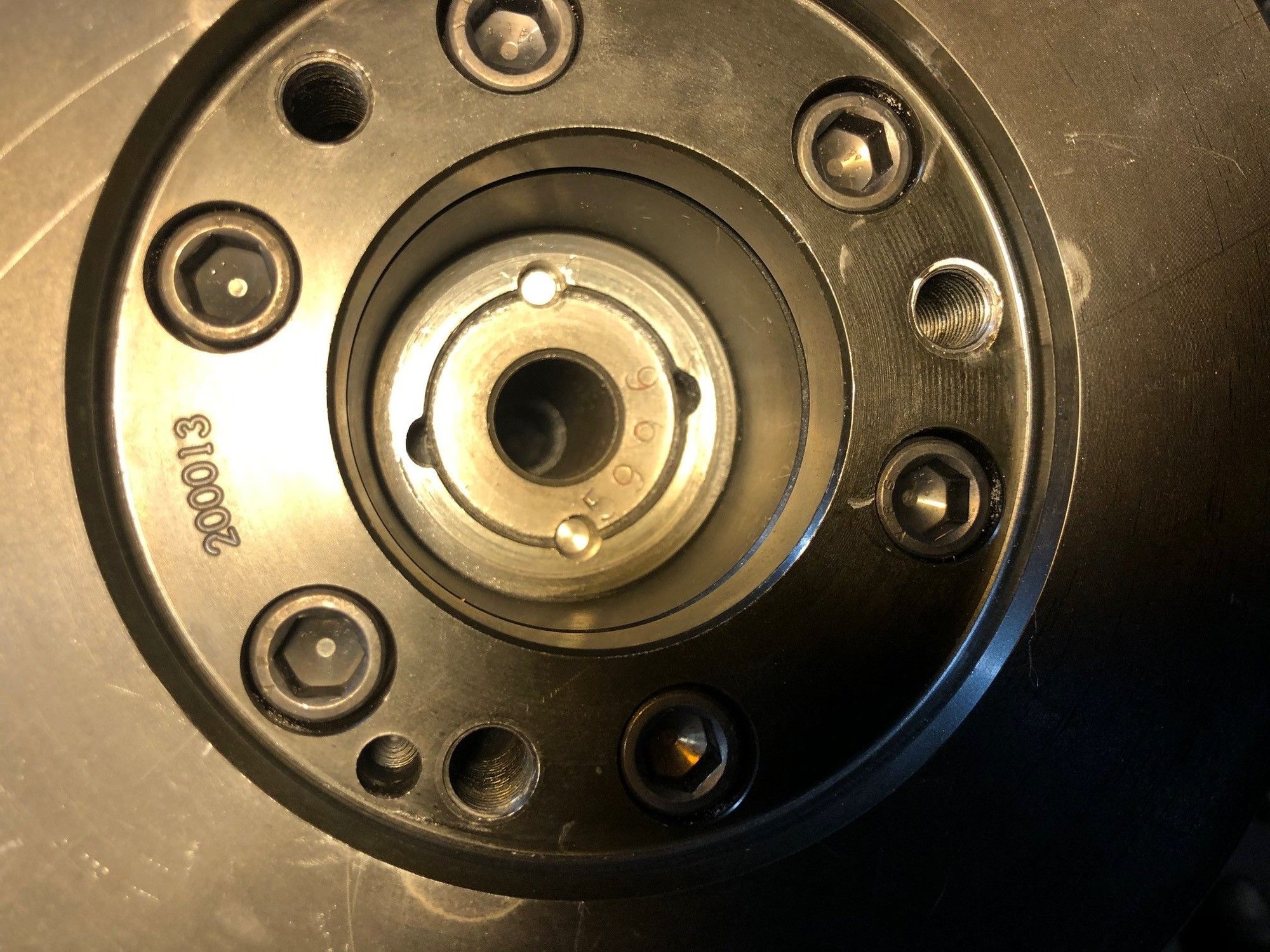

Get extra pins that are long enough to stick into the crank to line up holes on balancer. Pull balancer on, remove the alignment dowels and then install the short ones back in the holes.

Been holding over 1000 whp so far no problems. 10 rib centri blower belt, stock accessories belt and AC. probably 1200 crank.

I use the ATI balancer and ATI pin kit that pins the balancer just like the 2 pin method Justhereforinfo posted a picture of. Works very well and simple to do.

Yea the picture is of a K1 crank, which was keyed, but the fluidyne balancer was not, so i pinned it. I reused the balancer from my stock crank setup, thats why it has 4 holes.
