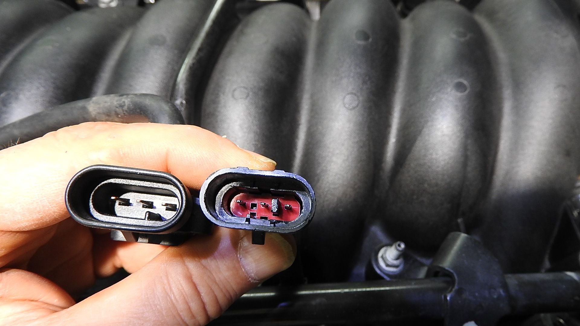

i need a connector to the ls1 harness like on the left. what is the one on the right? it would probably fit except for the two tabs. thats what i got before and was going to modify, but not sure about the wiring (everybody uses different colors).

right is amp superseal 1.5. available very easy in europe or everywhere. left connector must be original factory connector

as i said, left is ls1 connector on the harness. the right doesnt look like what yo linked to (how would the male go in with these tabs?). i just wonder what it fits on, because it was sold as an gen 3 to gen 4 adapter. the other end fits a 12592525 3bar.

open your eyes. connector on right is exactly what i show you. i have used this connector for many years. it is good easy to use connector

well, whatever. im not so much interested in what the right connector is called as in what engine/car the addapter was intended for.

One side of that Holley pigtail (Post #8) uses a Metri-Pack 150 sealed connector that snaps onto the stock engine harness. If I'm not mistaken, the other side appears to be a Bosch Compact 1.1 sealed connector, typically used with a Bosch T-MAP sensor.
Is the LS9 MAP sensor really a Bosch T-MAP? If so, that is really cool because you could also use it for Intake Air Temp (if GM hasn't de-featured it for only MAP sensor).

This is the connector for the LSA MAP sensor:
https://www.bmotorsports.com/shop/pr...roducts_id/986
Care must be taken to wire it correctly because the LS MAP and the LSA MAP have different pinouts. Two wires are swapped, I just don't recall which at the moment.
