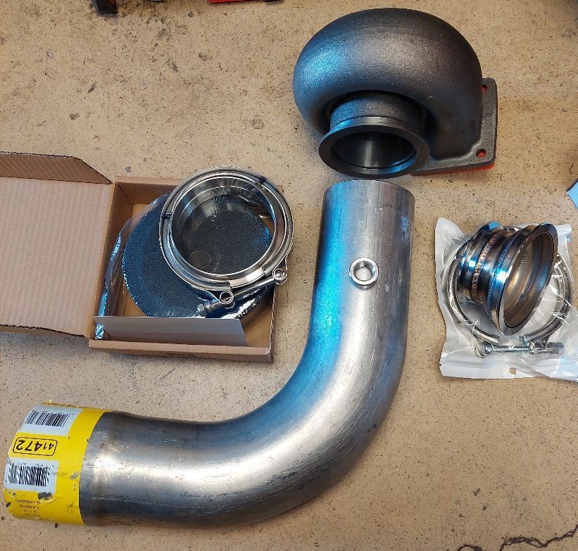

Another sucky thing is I literally have everything needed to do a short, 90 degree downpipe, which is why I even posted the question...but now I am not wanting to dump exhaust directly under car, straight down.

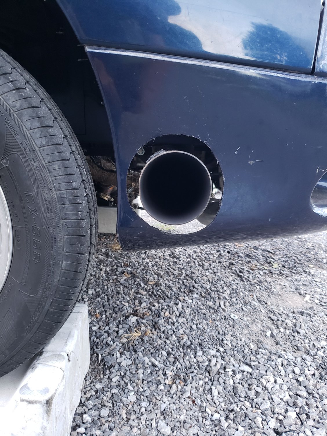

I did 3" fender bumper exit on my HSP V1 kit. On the HSP kit the wastegate is pretty much under the exhaust housing and required a 45* bend to clear and it was tight to snake it between the gate and the lower rad hose. Other than that it went smooth. Remove the overflow/battery tray - the battery will still sit pretty good without the tray. I used an expired "sub" belt from my old harness set as a battery hold down and it's not going anywhere. For the coolant overflow I grabbed one of the kids aluminum water bottles and drilled tapped it for a couple of fittings. I still need to pick up a 3/4 npt plug to replace the plastic cap, but so far no issues.
As far as noise, it's really not bad in the car. I think it's quieter in the car than the cat back was when it was N/A, outside though not so much, it's definitely not as loud as it was with the cutout open N/A. If you want pictures I can put in on the lift and snap a few.

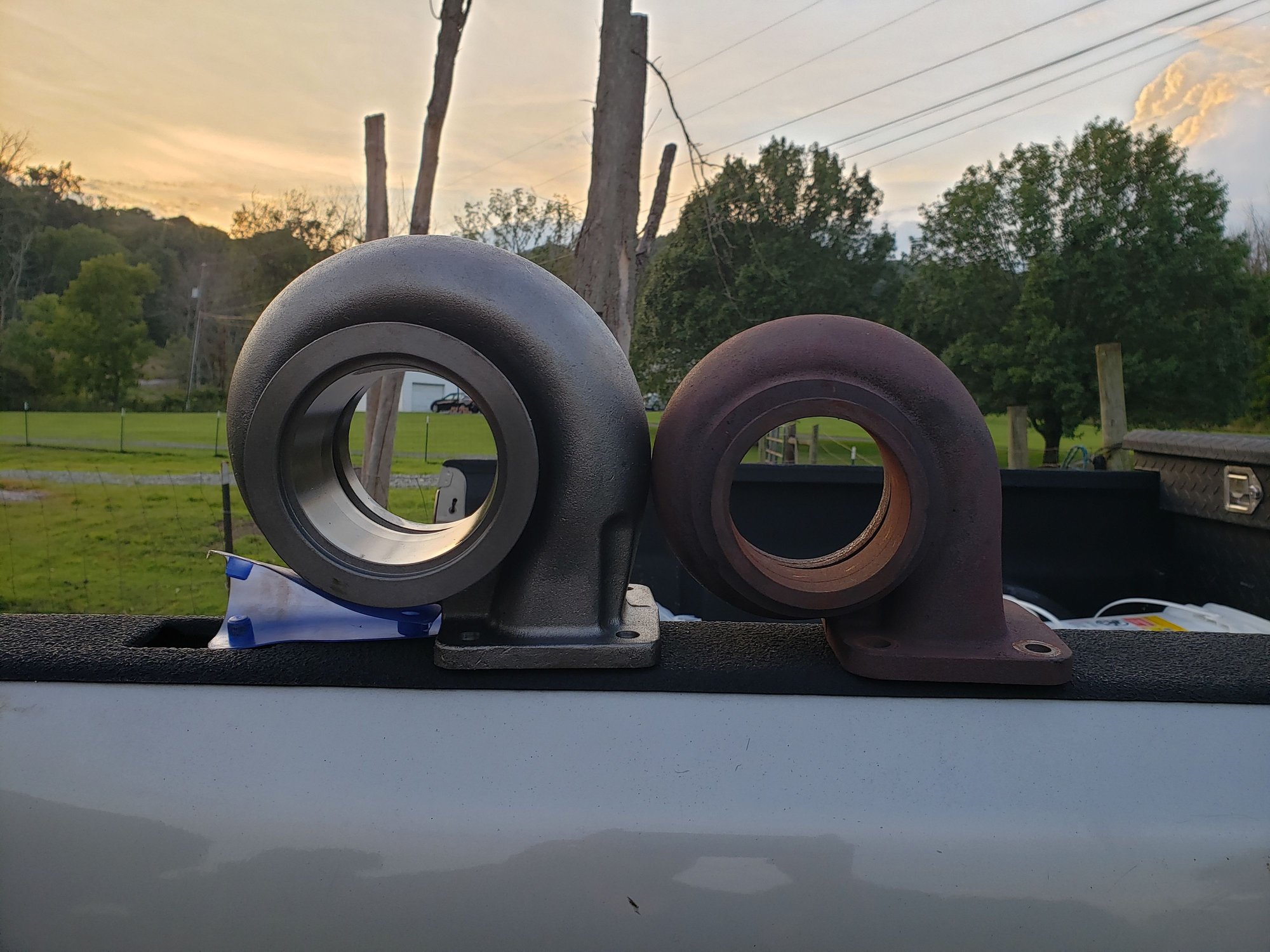

I went from. 96ar 3 inch down pipe to 1.25 ar 4 inch.

Whats the size difference between the two turbine housings?
That's crazy. Mine is MUCH louder with 3" D/P open down by starter, as opposed to through the catback, or with cutout open (when it was back under rear passenger side seat.)

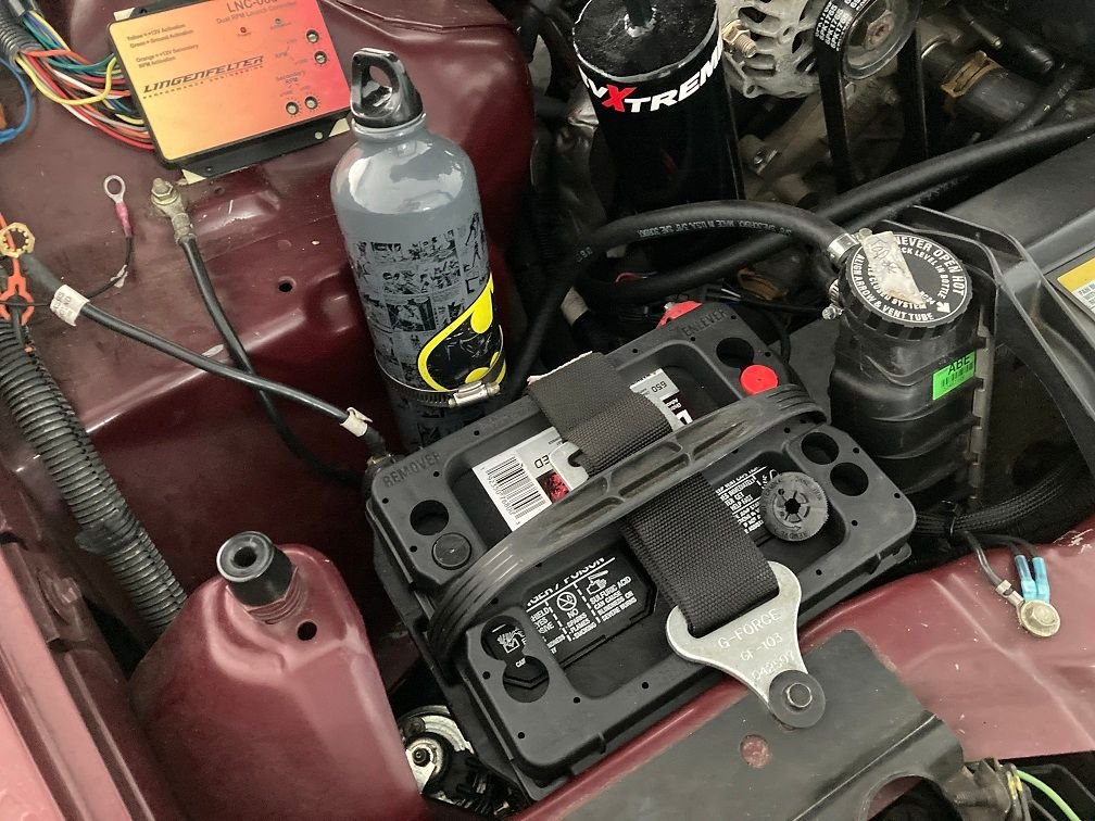

Would love to see pics, if you get a chance, but moreso of the battery hold-down setup.
Above, he says .96 compared to the 1.25.
That's the size difference I'd be doing as well, if go through with it.
Physically, as his pic shows pretty well, it's a good bit larger. That was another concern of mine...I have very little "extra" space, and since I literally just re-did my crossover a few months ago, there's a zero chance of me re-doing it again until something happens where it "needs" to be done.

Yea if any of you guys with both turbos could measure the size difference that would be great.
Have you driven and/or raced it like that yet?
Just curious of what your impressions were.
It's amazing how much quieter it is with the noise out in front of you. It doesn't resonate off the floor pan and ground. I've just got a 6.5" long bullet on it, so basically nothing. In the car, you can have a normal conversation, you couldn't with it dumped at the starter.
I've used this battery hold down for about 10 years, I think I swapped the belt once because it was dirty. The back uses a belt bracket as well, I had to cut it down and re-drill it. It uses the stock bolt on the backside. Those little brackets are hard as hell - be ready for a fight if you drill one! You can grab the battery and shake the car, it's not going anywhere.

Thumbs up
That looks awesome IMO. Thanks for the pic
