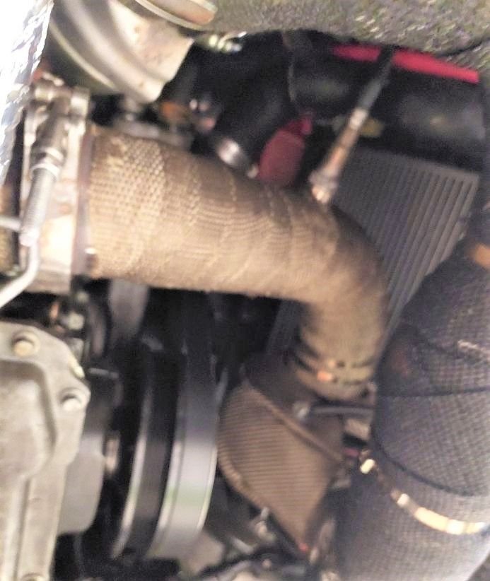

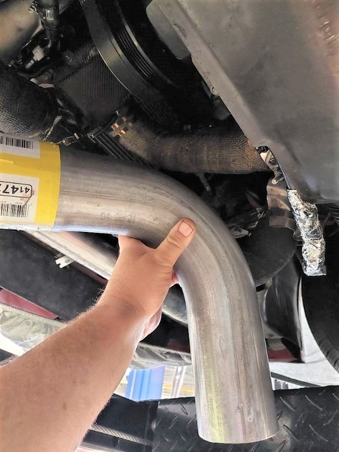

Going over my plans for for my 3" to 4" downpipe (&.96A/R to 1.25A/R turbine housing) swap, and on my front mount turbo'd 2000 TransAm there simply is NOT a whole lot of real estate to work with.
It looks like I may be limited to about 20" total length for the new D/P.
I have no desire to relocate my battery, or re-doing intercooler piping, so D/P will be a simple 90 degree pipe from turbine outlet, out the guesstimated 20", including the part of it that's pointing straight down to the ground.
I'm not enthused at all, about having a possible death trap ride if I blow a head gasket or 2, but right now this short D/P is only option I see.
Is that going to be long enough? ie; is there even a downpipe that can be "too short"?
I have a new O2 bung for the wideband sensor. I "think" I'll be stuck with it's position being maybe only 6-8" away from turbo...
Is that going to be too close?
FWIW, I use narrowbands (in crossover pipe, 6" from each cylinder head merge) for IDLE/CRUISE tuning...
and wideband, only for WOT tuning.
I had debated (w/myself) about doing the 4" downpipe with the existing .96 housing, but am leaning towards just doing it all at once. All, being/meaning downpipe and housing.
LOL...now that I actually see the pics, it's going to be a HOOT making this work...

So it's just going to be pointing straight down at the ground for this effort? I'm going to be doing something somewhat similar for next season, but planning to do a fender exit of a 4" or 5" off the S480. If I can shoehorn it in that brief length, I may try a bullet muffler.

I've run downpipes that are about half your 20", didn't have any issues.

Correct.
My WS6 nose is beat up, tore up, cut up, and whatever other negative thing we can think of, so I'd not have a big problem with fender/fascia exit like the one Huron sells...although I'd not pay $400 for it.
The Huron Speed version (pictured) is a 3" turbo to 4" pipe (which defeats the purpose of my idea), and requires removal of the factory overflow tank.
I believe that would also then REQUIRE some new battery bracketry, at best case scenario?

There are a lot of 4th gens with fender exhaust, I think the 02 placement is important (space from the turbo) other than that play ball!

Ideally they are installed between 10 and 2 on the pipe to avoid moisture contamination which kills them quick. As far as space from the turbo, I've had them 4" from turbine wheel and they worked perfectly fine. Look at OEM locations where they put them 6" from the exhaust valve and they last for years.
My thoughts as well...but if you look where they have the bung on that Huron downpipe. Looks like it'd be in the 4-8 o'clock spot IMO...

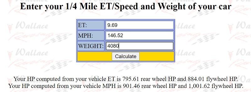

I'm trying to see just how far this little $570 VSRacing turbo can take me. So far, it's done very well.
I think a 9.50@150 is do-able. (Probably could have done it last weekend if I had used the transbrake, lol)
Never been on a dyno since I put the turbo on, but I'd think I'm somewhere comfortably between 700-800rwhp, even with a 3" downpipe choking it.
The Wallace Racing Calculator seems a bit over enthusiastic with it's guess IMO...I have a dyno literally 3 miles from my house, so I may get him to strap it on there one day just to see where it is, not where I guess it is...
It does appear that way. I had a local fab shop do the same thing years back, that's why I do everything myself now.
