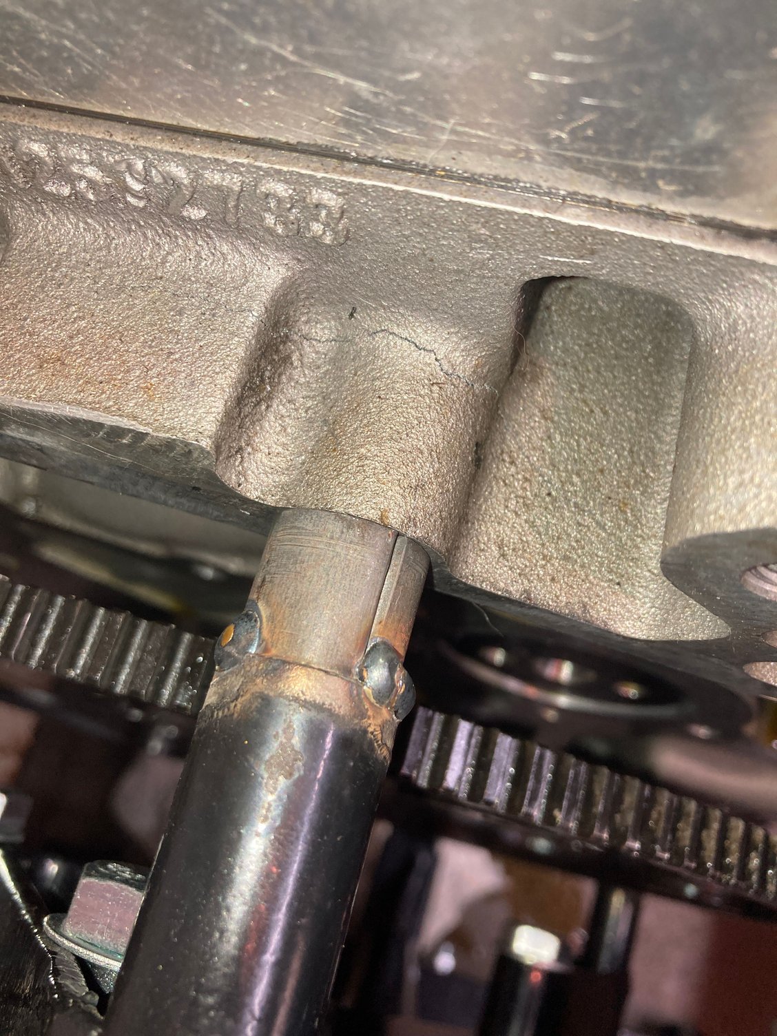

Well, finally pulled the engine to assess the pan damage. Can’t remove the pan with the engine in the car.
The pan rail on the pass side was bent about 1/4 “. No damage to the sump. Pan is quite stout actually.

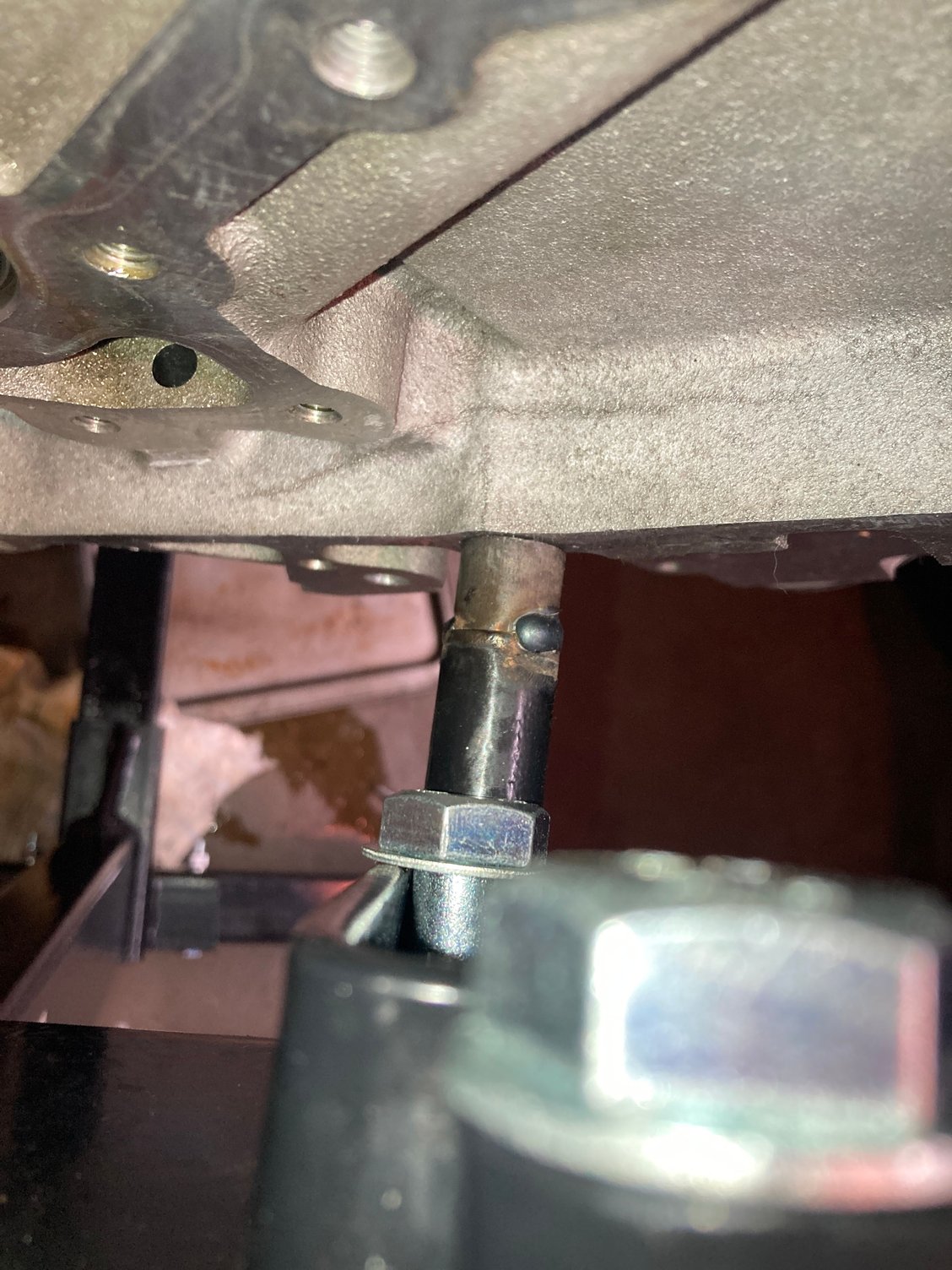

Sadly, I discovered this:
This is the upper left bellhousing bolt location.
So basically it hit so hard, the upward motion of the rear of the engine tried to tear the trans off the engine.
TH400 with an ultrablell. If you’ve seen those, the flange is 1” thick, it wasn’t going to break so the block took the brunt.
Fortunately I purchased an LC9 block to have as a spare, so my internals will go into that.
Sigh….RIP L33
Ron

Well crap. Cracks go deep? Fairly shallow flange depth back there Ron, so not a lot of force (leverage) on that part of the casting. Might be easily repairable?

A little hard to see in the photo, it’s about 4” long and all the way through. One part back there is 1” thick.
My welder guy (Truckdoug) says maybe if you heat the whole block etc etc.
There may be internal cracks I can’t see. Oil was oozing out of it as well.
This is the one instance where only having 5 instead of 6 bolts for the trans is an issue.
My Ultrabell has the boss for that top bolt. It’s not drilled now but will be. 😊
I will say that the main bearings look excellent. No more edge riding on 2&4, no wear on the thrust either. So maybe my larger clearances and a butt load of oil pressure are working.
