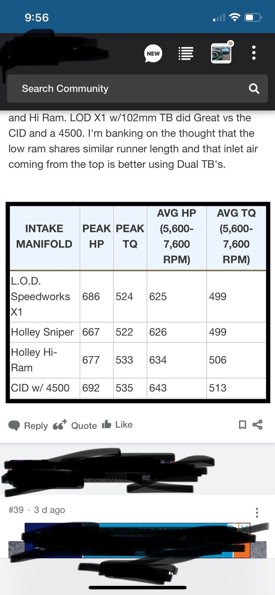

The lod intake is a short runner intake
https://gwatneyperformance.com/the-ultimate-ls3-intake-manifold-dyno-shootout/

Planning to do a test fit this weekend with a mockup engine and hope to determine how much hood clearance we will have. With this LS7 cam, there seems to be no point considering any intake that shines from 5600 to 7600 and I have yet to see a hi-ram that fit under any stock hood. Cutting the hood, hood scoops, etc, is not an option. My choice would be a Pro-flo since I have experience with it on my 6.0L in the past and it now being on a 370. Dimensions say it is 9.68" at the rear and 9.2" at the front. From what I've read, the hi-ram is 11+", at the front, making it even worse. Push comes to shove, we'll use the stock intake and run an extra psi or 2.

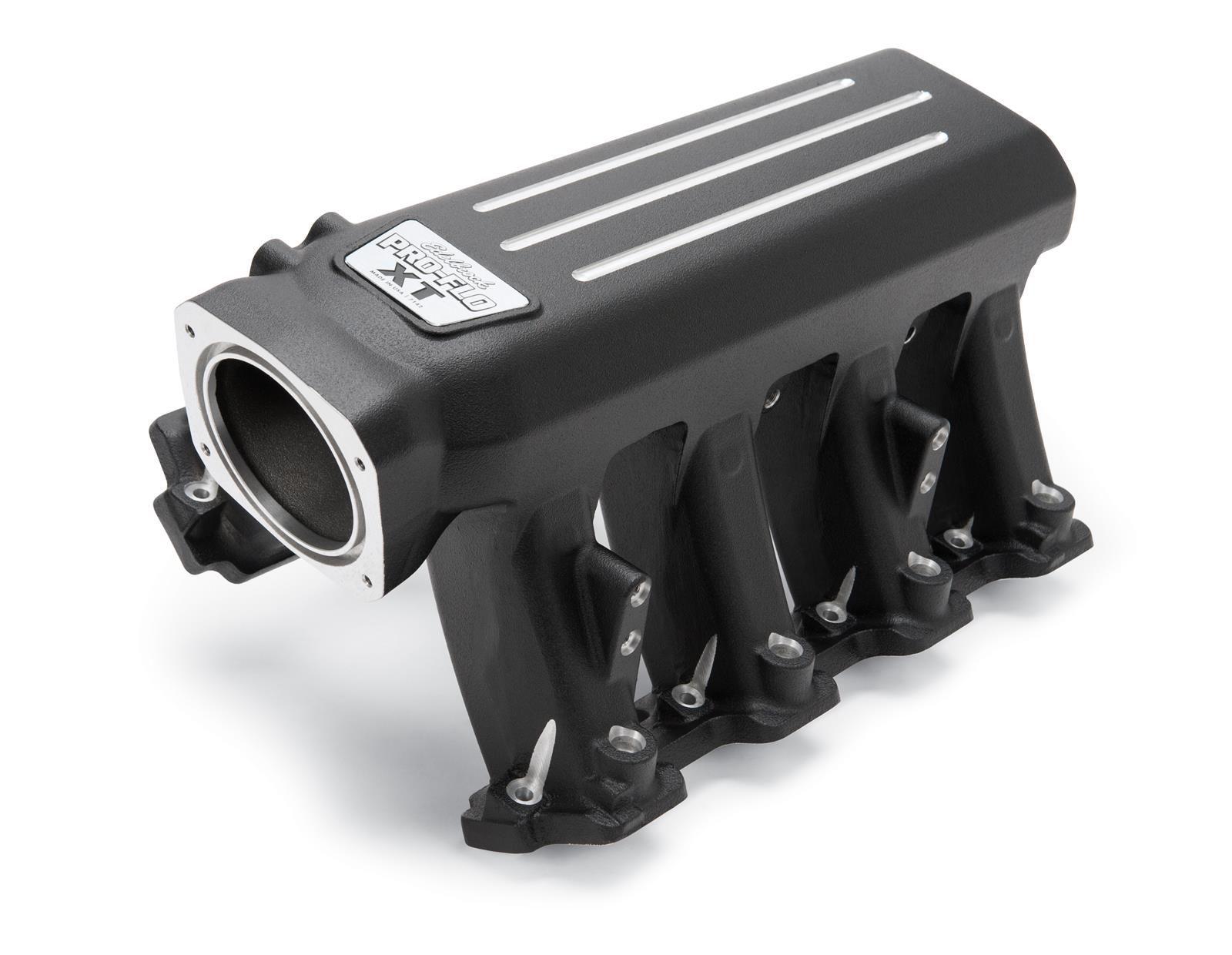

He only has the engine and a TH400 coming. The engine will initially be used as is. Nothing else is decided on yet.
Call me weird, but I prefer the looks of this over the "goose neck" hi-ram.
Okay, that looks really good in black, I'd run that for sure.
That will fit under the cowl of a 4th gen camaro?
