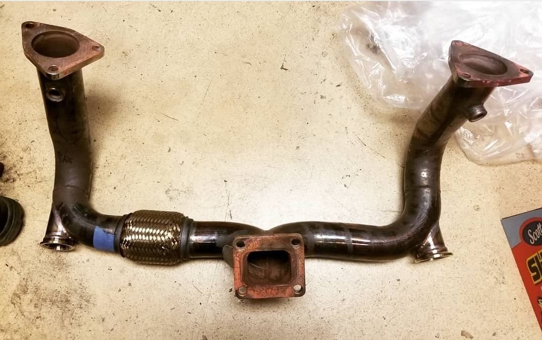

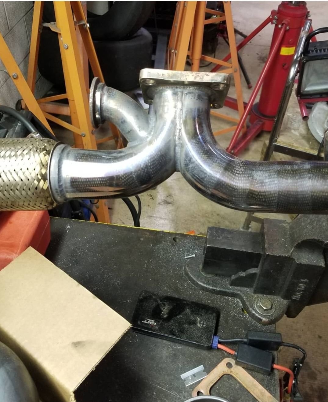

I have a thread, with plenty of details & pics linked: DUAL WASTEGATE CONVERSION
In a nutshell, a 90 degree wastegate placement simply doesn't work correctly, and/or consistently. The more prioritized it is in the exhaust flow, the better it will work. I wasted a lot of time trying to make a poorly designed (On3) crossover with wastegate pipe, work. It NEVER worked right, from Day 1.
I had had enough, and removed the complete hot side, modified my crossover, with dual gates, and now can easily make from 3# to 22.5# or so, where it's pretty much done making boost. It'll do it consistently, and rock steady...and no matter if the car is running through a full exhaust, a 3" open cutout/downpipe, or a 4" short downpipe. I've ran it all 3 ways at the track
Obviously, the Holley setup has a completely different crossover style, but there's no reason why the thread link posted above, can't let you see (why & what was happening, and how I fixed it once and for all.

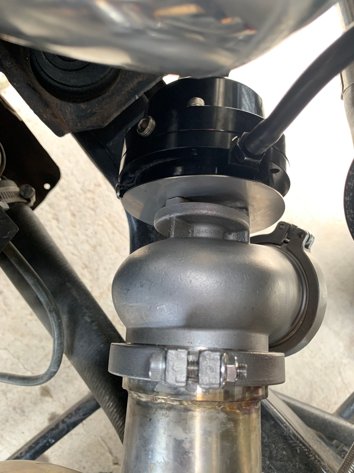

just so you can see how the wastegate is placed and how I have it plumbed i said there was four lower ports but it theres two on the bottom and two on the top

this is how its position and how the wastegate is plumbed. i said there was four lower ports but theres two on the bottom and two above and one at the way top of the gate. the two above are capped off and the one on the way top is venting to atmosphere. im going to log a pull with the wastegate off to to see if it still makes boost. to verify that it is the positioning.
The one I attached shows pretty clearly it isn't in a good spot. I see you have a lack of space like I do.
If the current wastegate had a "standoff" like my "less than awesome" MSPaint skills are trying to show...(either in RED or YELLOW), it would work fine.

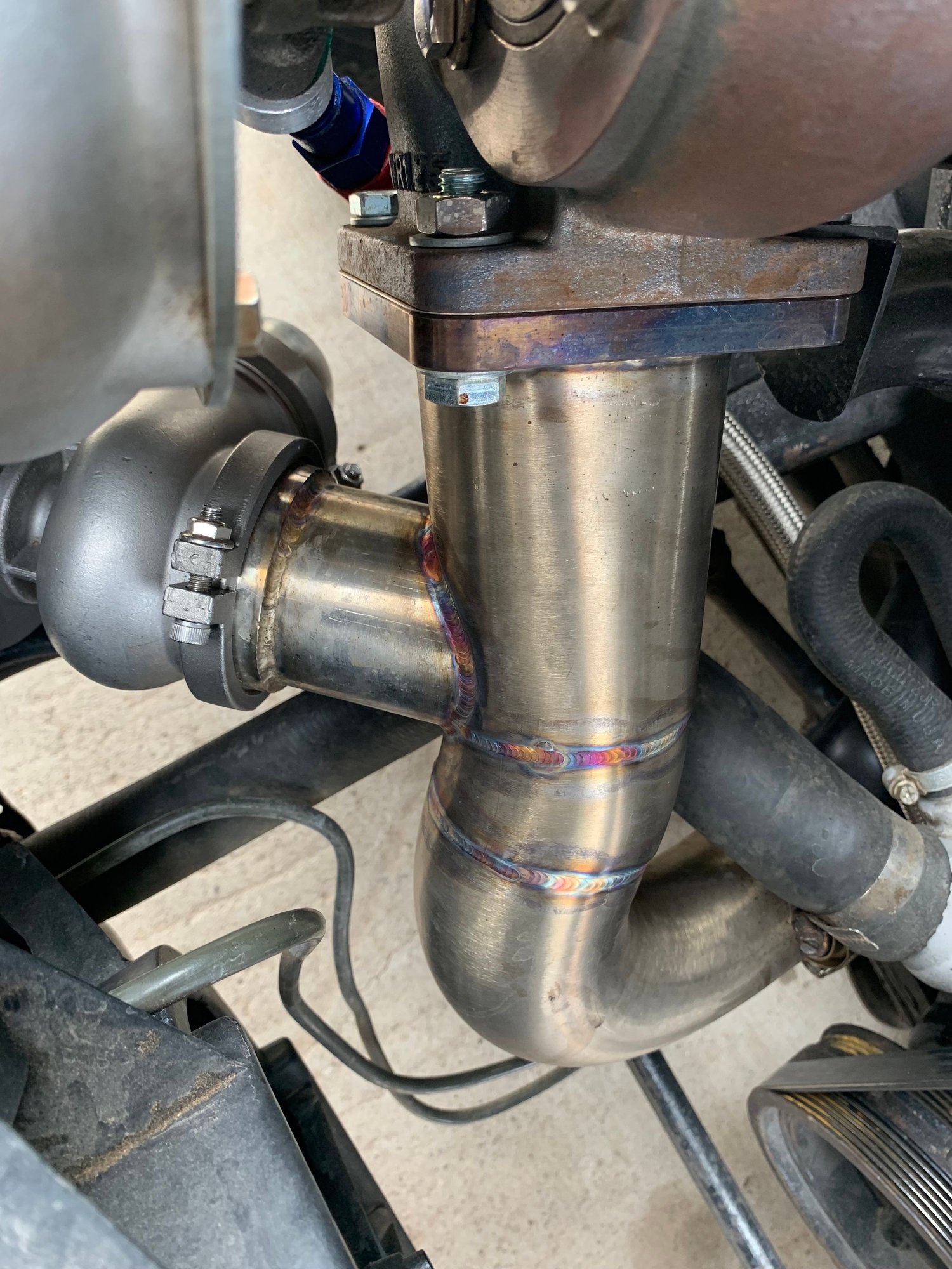

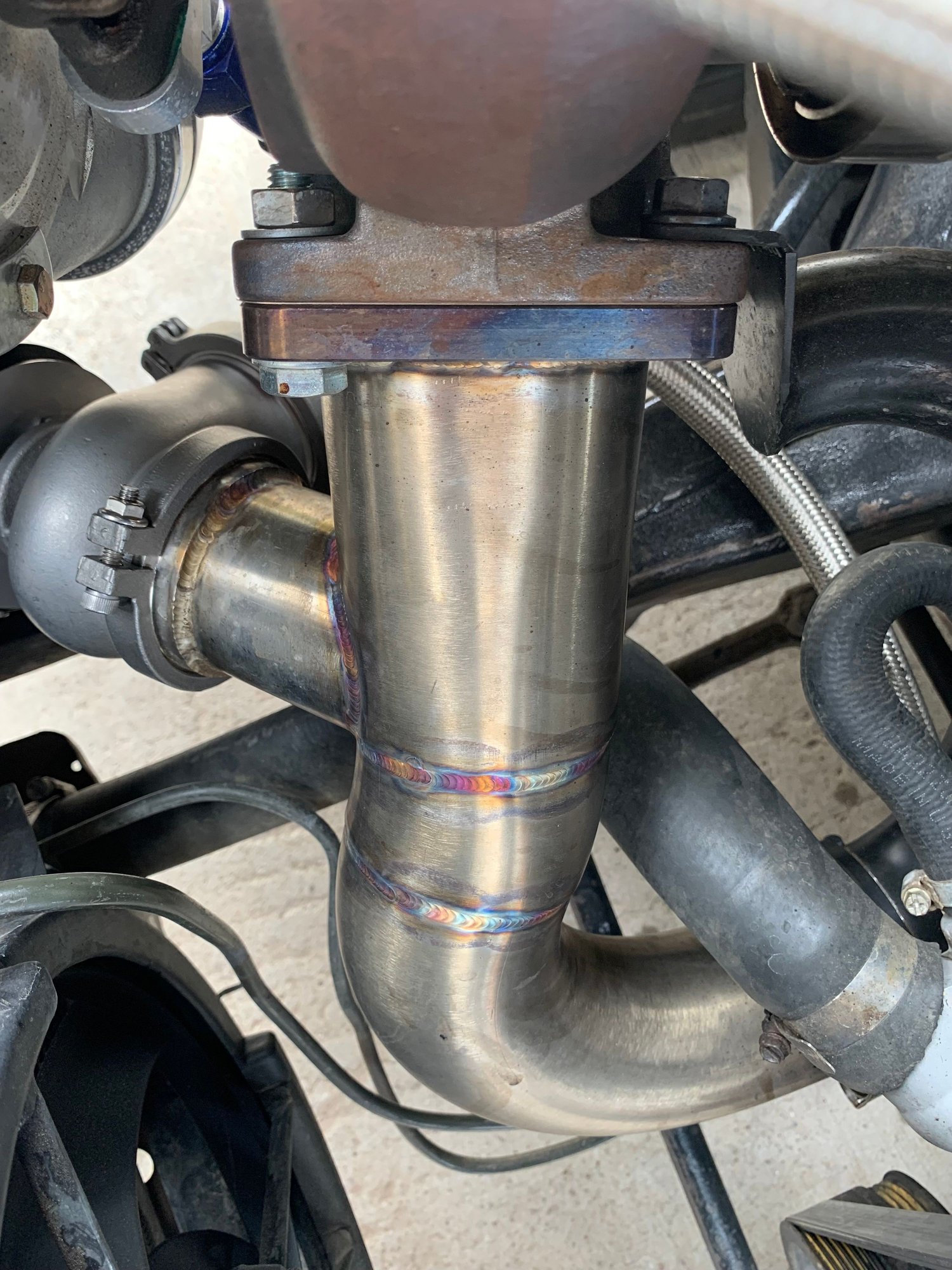

You may not necessarily "need" 2 gates...just one in a spot that gets better exhaust flow.
Mine is a front facing truck manifold setup, which had a bad spot and had creep from Day 1. Attached a few pics of before and after just to show how it was cured.
Looking forward to update
Original On3 wastegate location, had bad creep as soon as I used cutout and bigger intercooler. Original wastegate standoff Pipe was cut off and welded shut
Prioritized wastegate standoff pipes, welded at outside of each 90 degree headed to turbo
Passenger side gate...had to use a short 90 to relocate gate and give extra needed radiator/intercooler pipe clearance
Driver side gate, simply bolted on with room to spare
