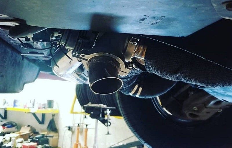

FWIW, I run two Wyntomn 44 mm gates on my fully divided setup with onboard air and have had zero issues and the accuracy of the boost control in bananas. Check out the priority in the pic. No input for the other style gate you’re thinking about nor any input on just using one. It might work.

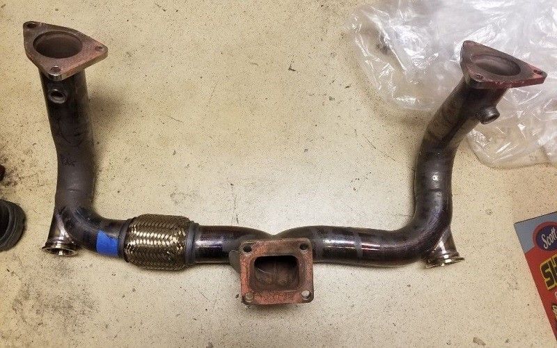

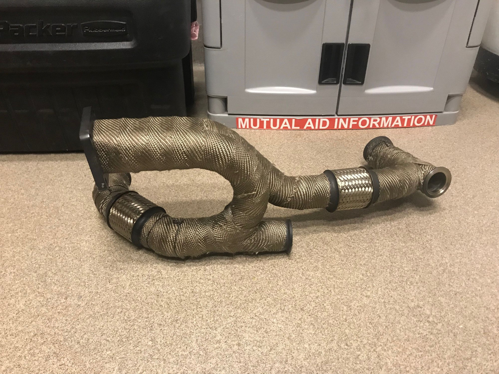

Budget, but a $350 wastegate?
Wouldn't you need to do some tricky welding/plumbing to make the gate get equal flow?

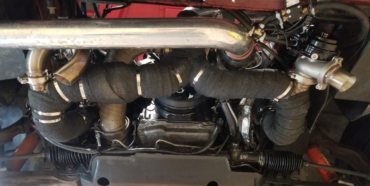

I did mine similar to above, and with 2 VSR 44mm gates, and required piping to "loop" one gate's inlet, was still well under $350 and with nothing but "boost reference", and using a 4 port MAC valve w/my EBoost Street boost controller, can easily make anywhere from 4# to 22+# of steady, controlled boost.
Modified On3 crossover, for dual wastegates
Driver side wastegate and exhaust exit
Passenger side wastegate and exhaust exit
Complete, assembled, dual wastegate crossover installed
Dual gate exhaust exits, just peeking out from behind air deflector
