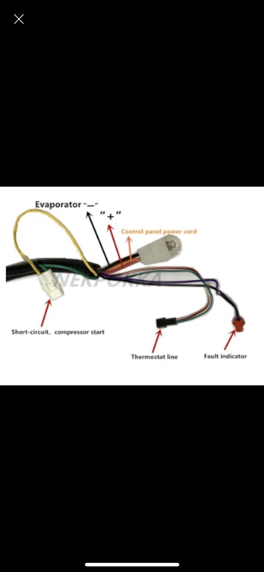

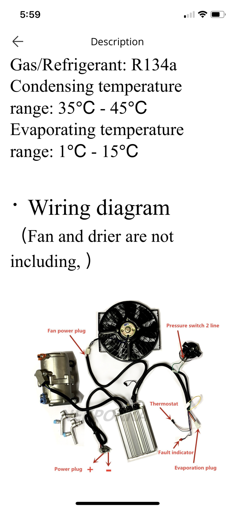

Im running an interchiller inline with my a/w intercooler on my procharger f1a setup. Any air to water intercooler will work as long as you run the chiller before the intercooler. I decided to run an electric compressor for a volvo bus that i found on aliexpress lol. Still havent finished the setup and im in the process of applying lizard skin to my reservoir and intercooler to avoid condensation at the track and avoid temperature loss from engine bay heat. I run the 13” chiller from kincaid performance. They sell the chiller separate so you dont have to buy their entire system. Ill get some pics for you but its pretty straight forward as far as routing the lines and stuff. The compressor comes with a ballast which is nice.
