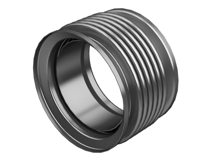

Like CAT 223-5665 below? Looks similar to the vibrant bellows, I'd assume its thicker material.
