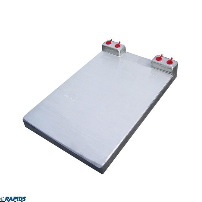

So I have been planning on this for awhile. Killer chiller is the actual product. It is super over priced any way. I d recommend looking in to a plate beer wort chiller on ebay. I'm gonna use a big one. A mid 90 to late 90s peterbilt 379 bunk expansion valve would be best. I believe the external evaporator is a better plan due to if there needs anything replaced like a evaporator or expansion valve then it can be replaced individually instead of the whole tank. Yes this works really well.
Hey guys, just saw this, look for a "jockey box" chiller kit,
a "cold plate" for a jockey box chiller.
I worked in the craft beer industry for a long time and we used these things for chilling beer when we poured at festivals and no refrigeration was available. Coupled with ice, you get col' beer.
