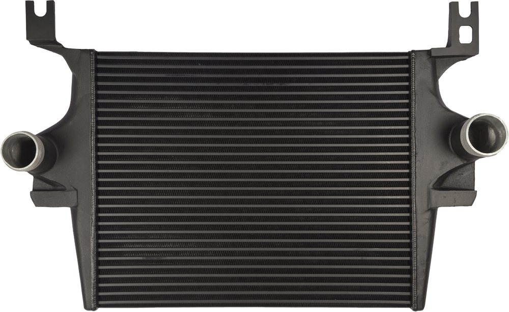

Some will say you need a Garrett and the rest are junk, but I've used Treadstone, Bell, and CSF with good results. The Treadstone TR1245R would get you going for around $500.
You could also repurpose something like a CSF diesel truck intercooler that are pretty large with a 25x21" core since you have the room and only $350

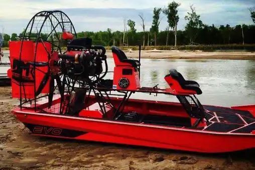

Can you please post pictures of your airboat with turbos? I can post pictures of an airboat with a 600HP BBC that I tuned....Let's get real here.
