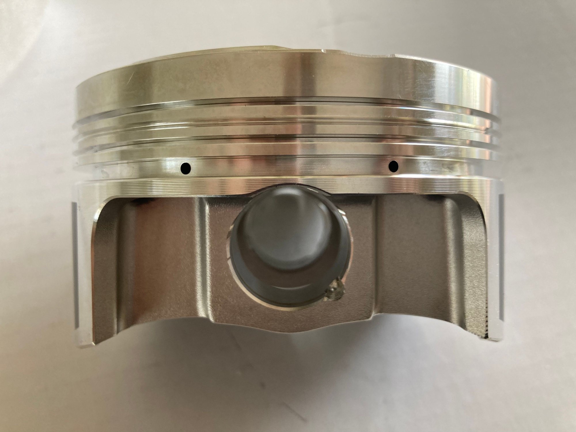

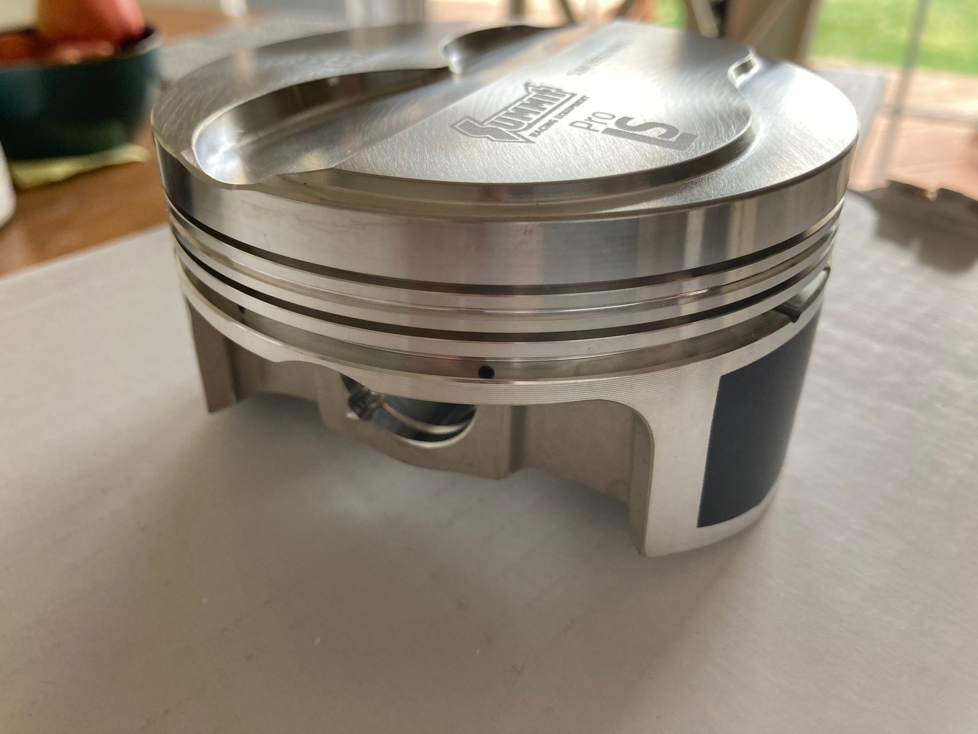

Just ordered Summit Pro LS 11:1 forged pistons for my dedicated E85 LSA build.
Most seem to say this is fine. Slightly scared, wanted 10:1, but choices were either 9.5:1 or 11:1. Am I doomed? Machine shop says people are doing it all the time now, some even higher.
I’m still contemplating having the +2cc pop up domes machined off of them and converted to flat tops when they arrive.

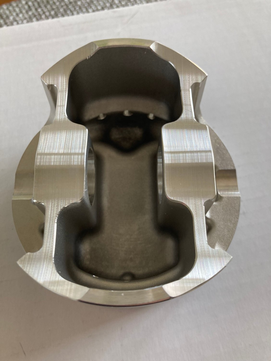

On another note, look at how gloriously thick that piston crown is!

Thanks again for all the input. Yeah, the piston description says they are boost specific, so hence the ring pack low geography. Also helps to make it more forgiving during calibration I would presume. Machine shop said the skirts are thick as well. These pistons are stock stroke, 4.070" bore, 6.125" rod length, smaller 0.927" pin bore (SBC?) per the piston and rod kit Summit sells together.
