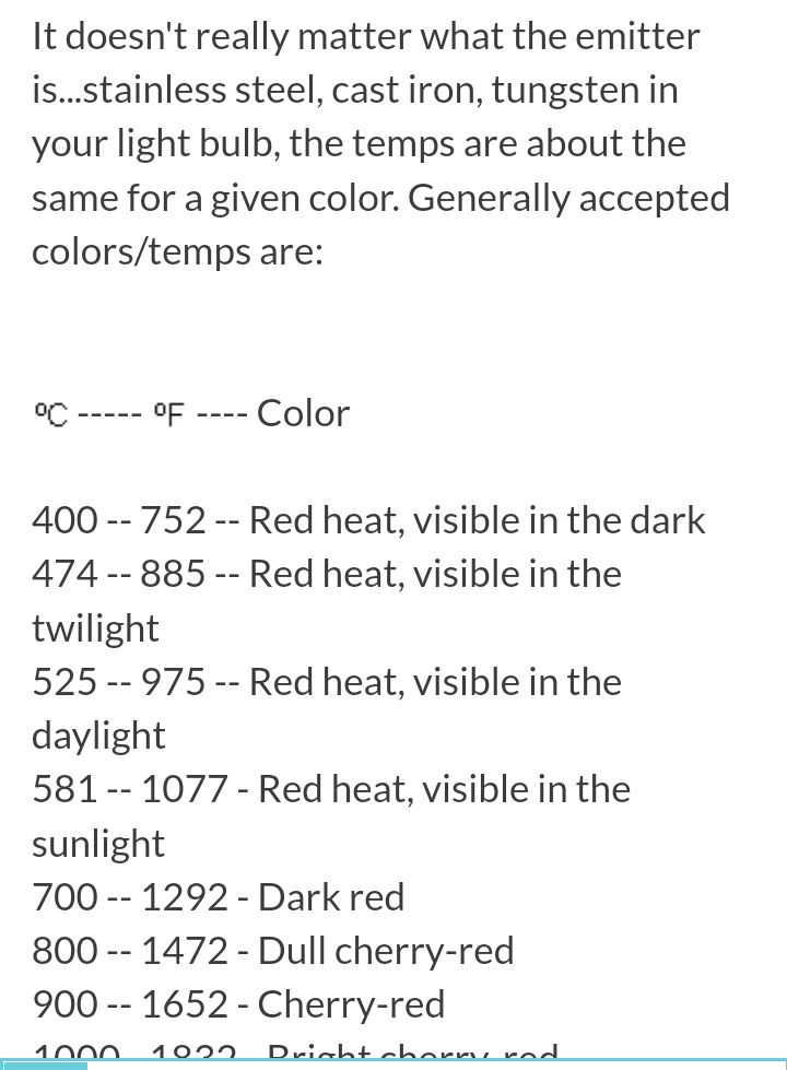

Doesn't take very much temperature to get a visible glow especially in low light
My hot side is glowing just cruising in the dark

Example

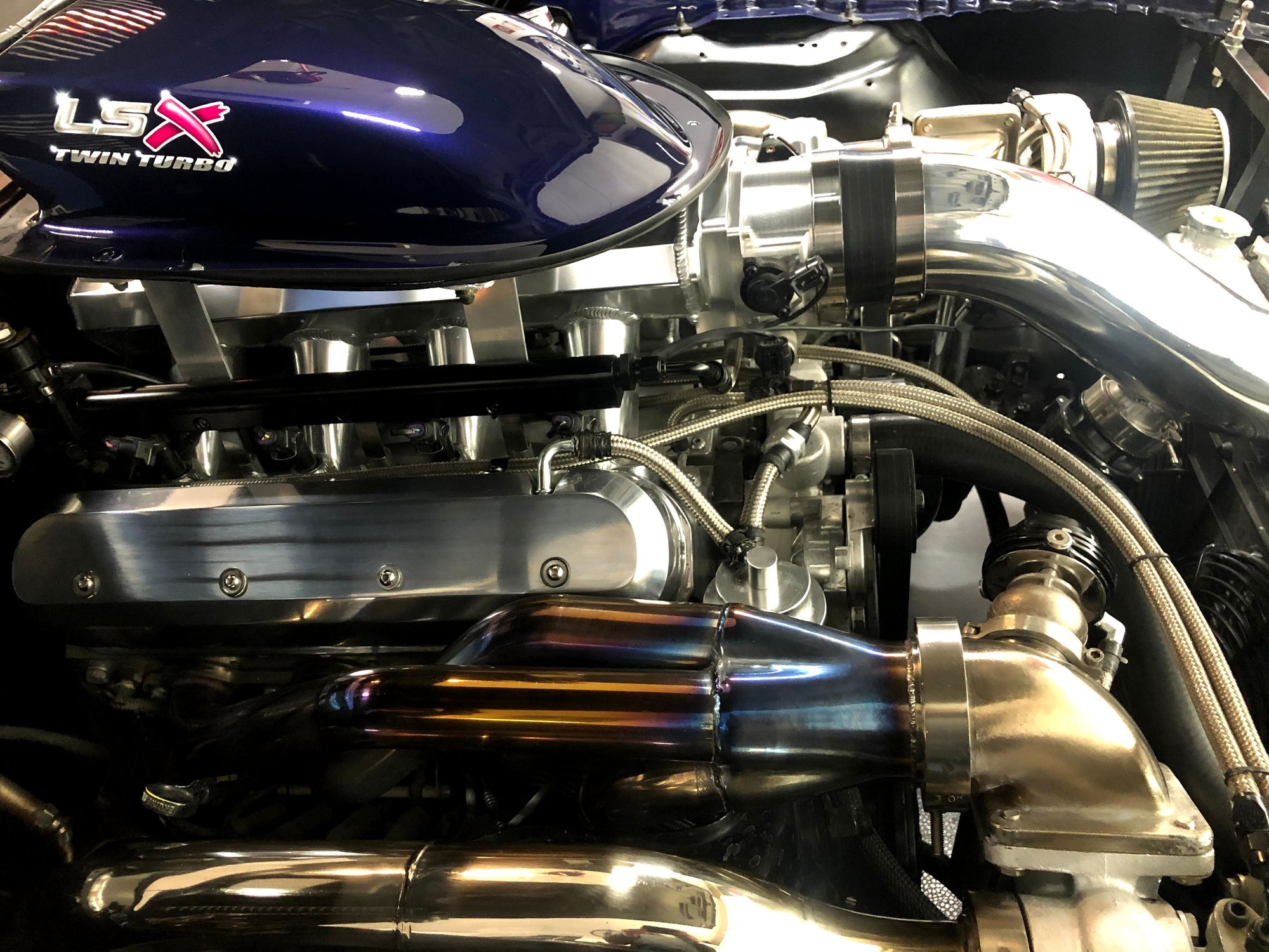

Head over to the KSR channel he has an under hood shot on the dyno with said headers.
If you were NA id say start looking at timing.

Apparently!
