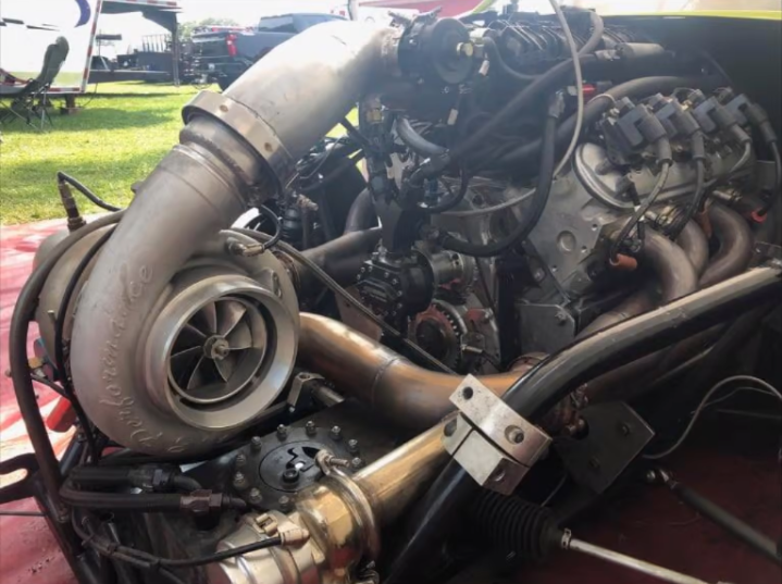

Might as well throw this one up too... what is that like 2"?
Old Jul 27, 2022 | 02:44 PM
  #35
Posts: 22,308
Likes: 3,623
SERIOUS sparkage!!

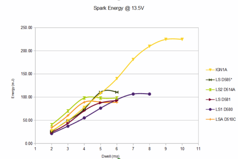

Found this on the DIY Autotune site.
From this data, the D585 looks better than the D581. So interesting the spark jump test RX7 did showed different.
Or maybe I’m missing something?
At any rate, the IGN-1A is vastly superior. But very cost prohibitive for my budget.
Cool chart! Do they state the purpose of the asterisk on the D585?
I agree, be curious how much its actually worth on a "normal" setup with a functioning OEM coil pack vs the fancy ones. Most guys with the fancy stuff are on big power methanol setups where an OEM coil is not optimal.
