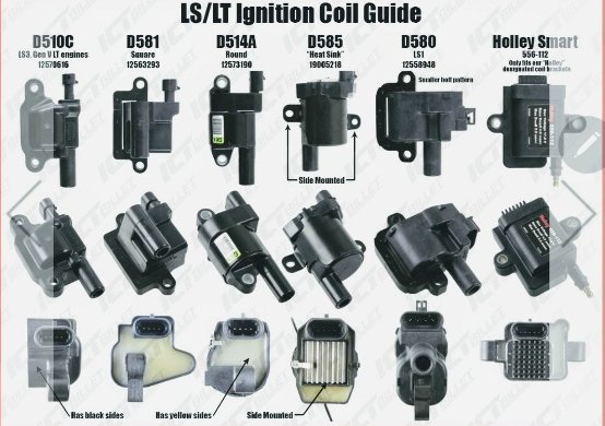

Im building a procharged Ls3 and Im currently using these coils that I think are from a later model truck. Ill include a pic at the bottom
Ive heard comments saying the truck coils are the best and then I hear other people saying the ls3 corvette coils are better. Ive seen some aftermarket coils that look like painted oem units but ive never heard anything good about them or seen them on any high hp builds.
If you were building a boosted engine and wanted the best coils what would you run?

"Best" is such a loaded term and “Boosted engine” is very non-descript! So there is no right answer IMO.
For a mild boosted setup on gas/E85 just about any OEM coil will work fine.
How much adjustability do you have? Do you have an aftermarket ECU that can change the dwell times?
the IGN1A is likely one of the “best” coils out there in terms of raw power and easy installation. But its expensive and 100% not necessary for most mild boosted setups. If your running huge boost and power on alcohol, or trying to light off spark with tons of water in the cylinder etc…. Then you would benefit from something like an IGN1A coil. Otherwise run what you have and save your worries and money for more important parts.
Out of the OEM coils the D585 (round coils with heat sink on top) was argued to have the most output at dwell below 5ms. These coils are unable to go above 5ms without auto firing so they can also be dangerous in the wrong hands.
The old school square D581’s are IMO more powerful that the D585. *if* you have the ability to control dwell you can run them all the way up to 7ms or so and they will not “auto fire”.

I agree, for the average 1000hp build you can use just about anything. You can mismatch the coils and run junkyard plug wires and be perfectly fine, plenty of better places to spend the money at that point.
Ya the D581's are good and seem perfectly fine up to 1500hp or so, some guys have pushed to 1700. If you plan to make more power than that I would skip the IGN1A and go straight to an MSD Pro 600, double the price but over double the output and better control.

The D585 used to be everybody’s darling. It appears that the D581 may be better.

Im running a Halltech elite 2500 fwiw. Thanks looks like ill get some 581’s and call it a day
