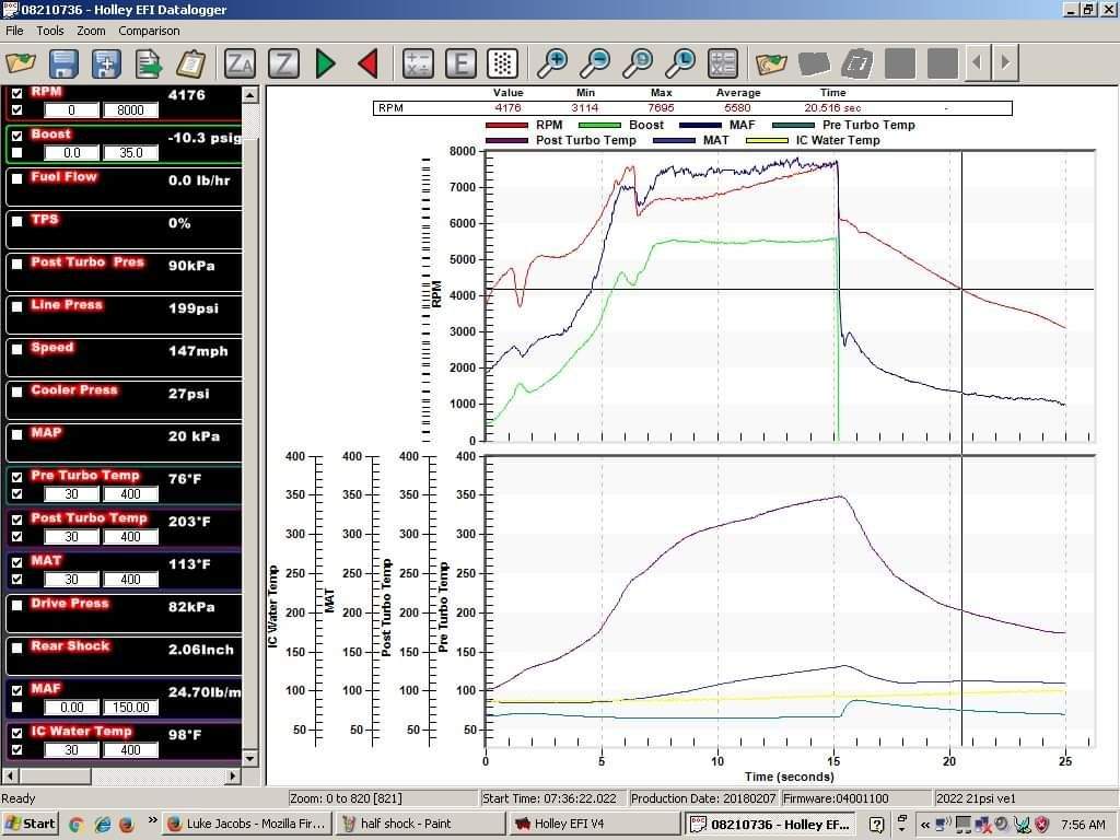

I have the GM maf in a 5" tube. I don't use it for anything other than actual airflow data.
But this was right around 11,000hz , fairly decent power, over 200mph in a standing half on the highway.
To give you the idea on range in a 5" duct

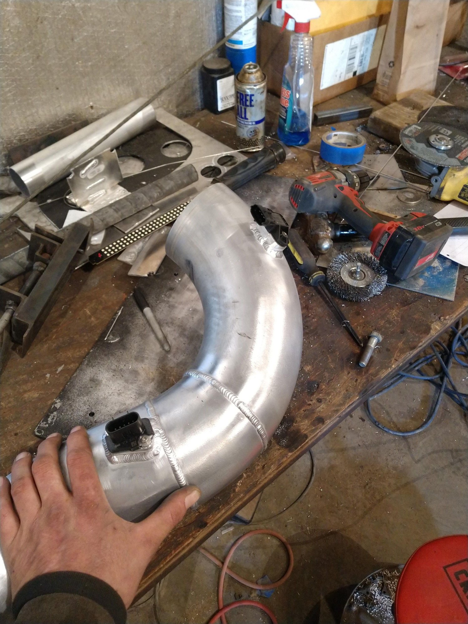

Do you have a pic of it installed. It's just a huge tube to fit under the hood of an Fbody with factory everything lol.

Yeah I have more room than most

Holy real estate. I wouldn't have guessed you had that kind of room in the RX7. I think first thing first is see if I can create a spacer.
Daumn! 👍
