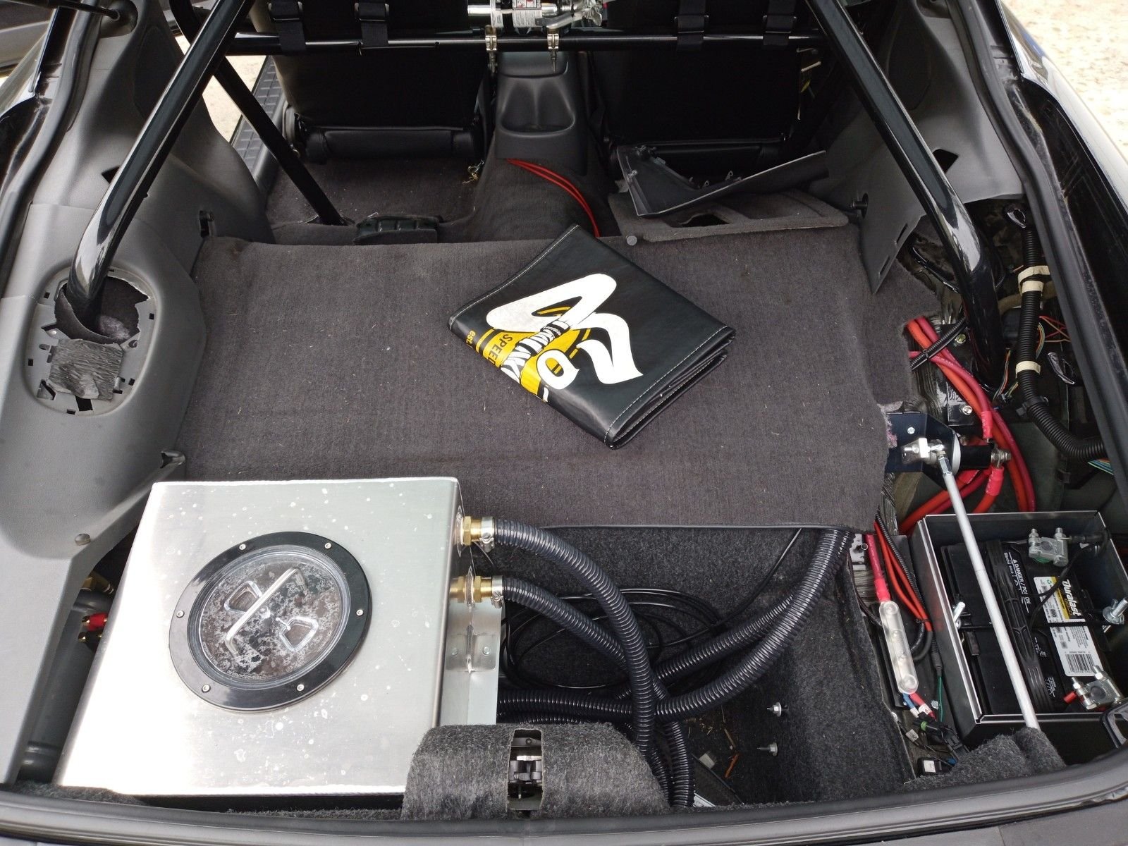

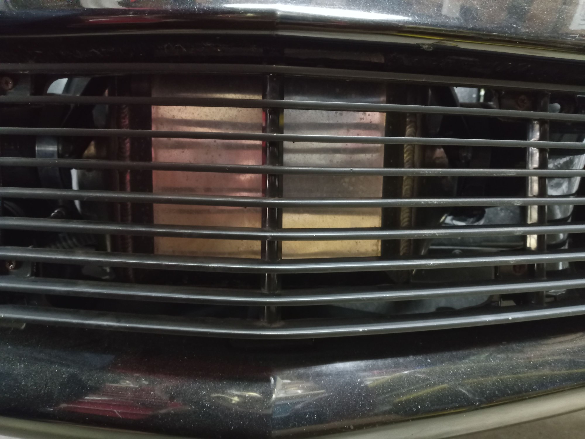

The setup is pretty simple, Frozen Boost 2,000HP cooler in the nose right behind the grill, 1 inch lines, aluminum 2-3 gallon tank in the t-top holder with a Rule 2000 pump inside.
Yes you'll spend more than an A2A but your IAT's will be much more controllable, I only run ambient temp water and my temps never get high.
In fact with the oversized cooler, my temps drop when the airflow through the cooler is increased when making a pass.
