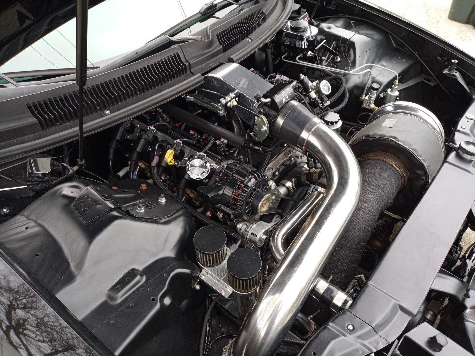

Old Oct 10, 2022 | 02:07 PM
Black_Sunshine_99's Avatar
Joined: Mar 2013
Posts: 3,895
Likes: 862
From: Washington
Catch can is towards the bottom where the intake pipe makes the bend down.
