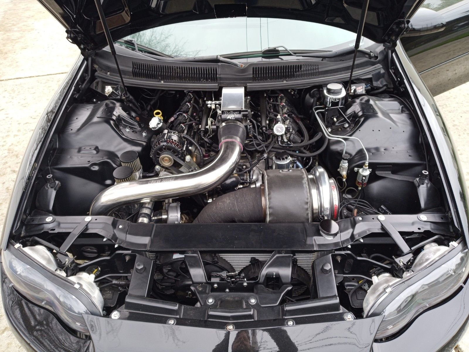

If you're standing up the radiator that will give you sufficient room, if the hotside is intended for a 78/75 style turbo you'll need to address the additional weight of the S480 as the On3 piping most likely won't be enough to support it on its own.
I'd bolt up the hotside and get some dims on the S480 and start there.
Honestly, if you're going to do all that I'd just sell it all off and start with a T6 specific kit from Huron Speed.
Fitment is excellent, this is with an S484.

The S480 you're looking at will probably top out around 1,100-1,200 hp will have a 5" outlet but you can kinda see in my pic, mine also exits 5" but necks down to 4" about 3-4" from the flange.
