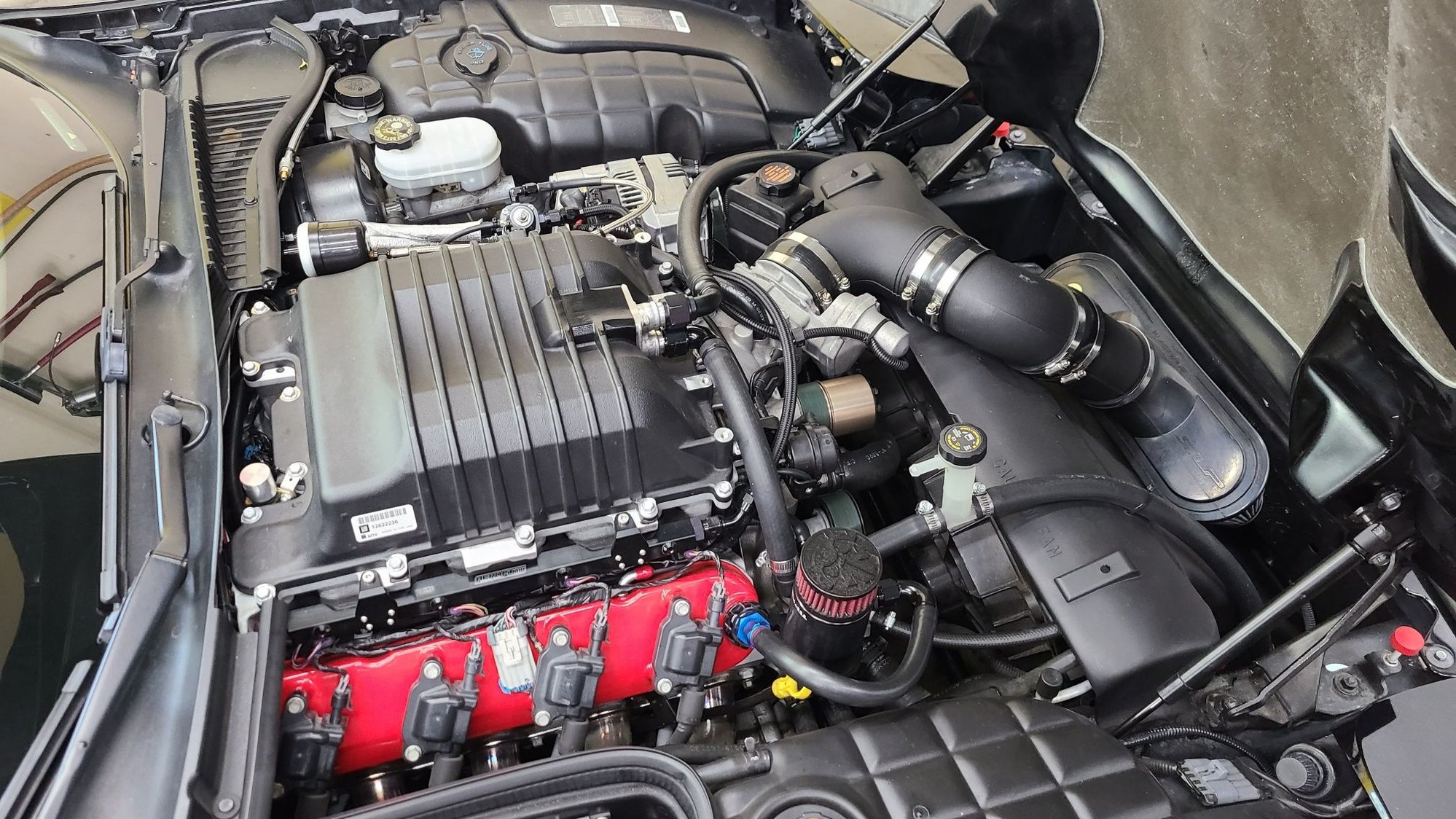

Here is a picture of the engine/blower combo as it sits today.
Such a clean install, looks like it came from the factory that way.

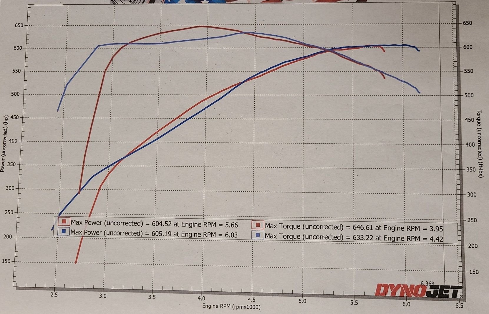

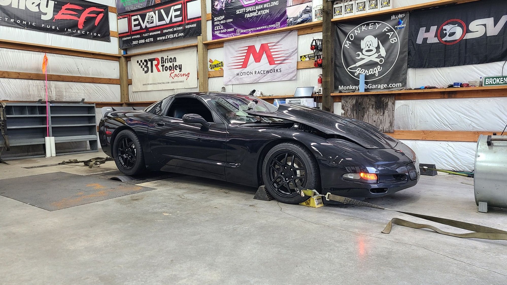

I will start off by saying that this car sounds flat out nasty when you pour some RPMs into it.
Dyno guy wanted to know why I had never really ripped this thing past 4k rpms. I said because there is a lot of wheel spin and I don't trust the fuel system.
We got about 2.5 runs in on the day before we shut it down as proceeding would be futile.
First hit was met with a lot of wheel spin on the dyno. Let tires warm up a bit and sprayed traction magic on the tires.
First real hit is in red on sheet. Right off the trailer. All he did was review the tune in my own laptop and he was impressed I hadn't made a complete mess out of it (also told him I did have some expert tutelage along the way). Left timing where it was. Never messed with it. Will add more in the future.
604hp & 646 Torque going lean above 5500.
Second hit in blue on sheet was a repeat of the first with some tire spin but this time we actually watched the mechanical fuel pressure gauge.
No good. Fuel Pressure drops to 30psi and this tanks the Injector duty cycle.
Will start with fuel pump mods first and then look into injectors.
He didn't charge me much for the attempt and he didn't really want to tinker anymore with the tune at that time especially if we're going to change injectors so that would minimize any potential rework.
So yeah, I'm not mad, I'm not disappointed. Good times and I can't wait to go back and see how close to 700 we can get on pump gas.

Holy **** guys sorry about all the words.
For the TLDR crowd. Made 604hp and 646 Torque running out of fuel.
Needs fuel pump upgrade and possibly injector upgrade.
The end.
