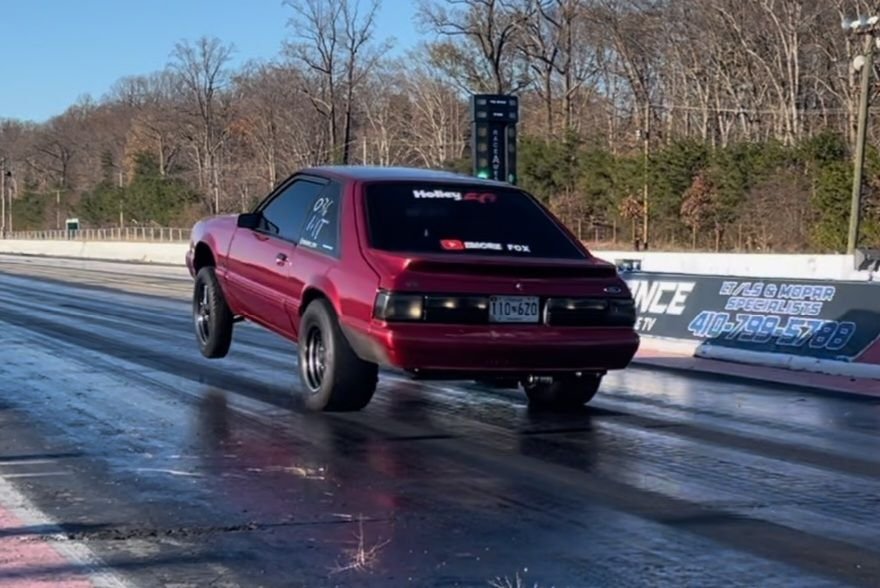

Some knucklehead (me), last time to track, inadvertently turned his MSD 2 step RPM up to 5300, instead of 3500. I wasn't paying attention, or whatever.
It made 15+ psi, which immediately blew the tires off. I also had another stupid issue, that ended the day, so I just spent the rest of the day helping my son run his turbo car.
I still run a P01 ECU with HPTUNERS and have never had any issue making boost on the transbrake. I basically have the (pre-boost) timing the same way it was when it was a 12 second NA car. I never changed it, or had to add or take away fuel. My son's car always had an issue building boost with his TerminatorX'ed 4.8/Turbo 400 car, until he had a custom converter made by PTC. Mine 6.0/4L80 car has a Jake's triple disc that "stalls" at 3000ish footbraking, or as high as 4300 or so on the transbrake.
FWIW, mine ran its best 60 foot (1.37) at 7# and 3200 rpm, which is lower boost and rpm than my son's Fox body, which went a 1.32 so far...
Both "bests" captured below.
