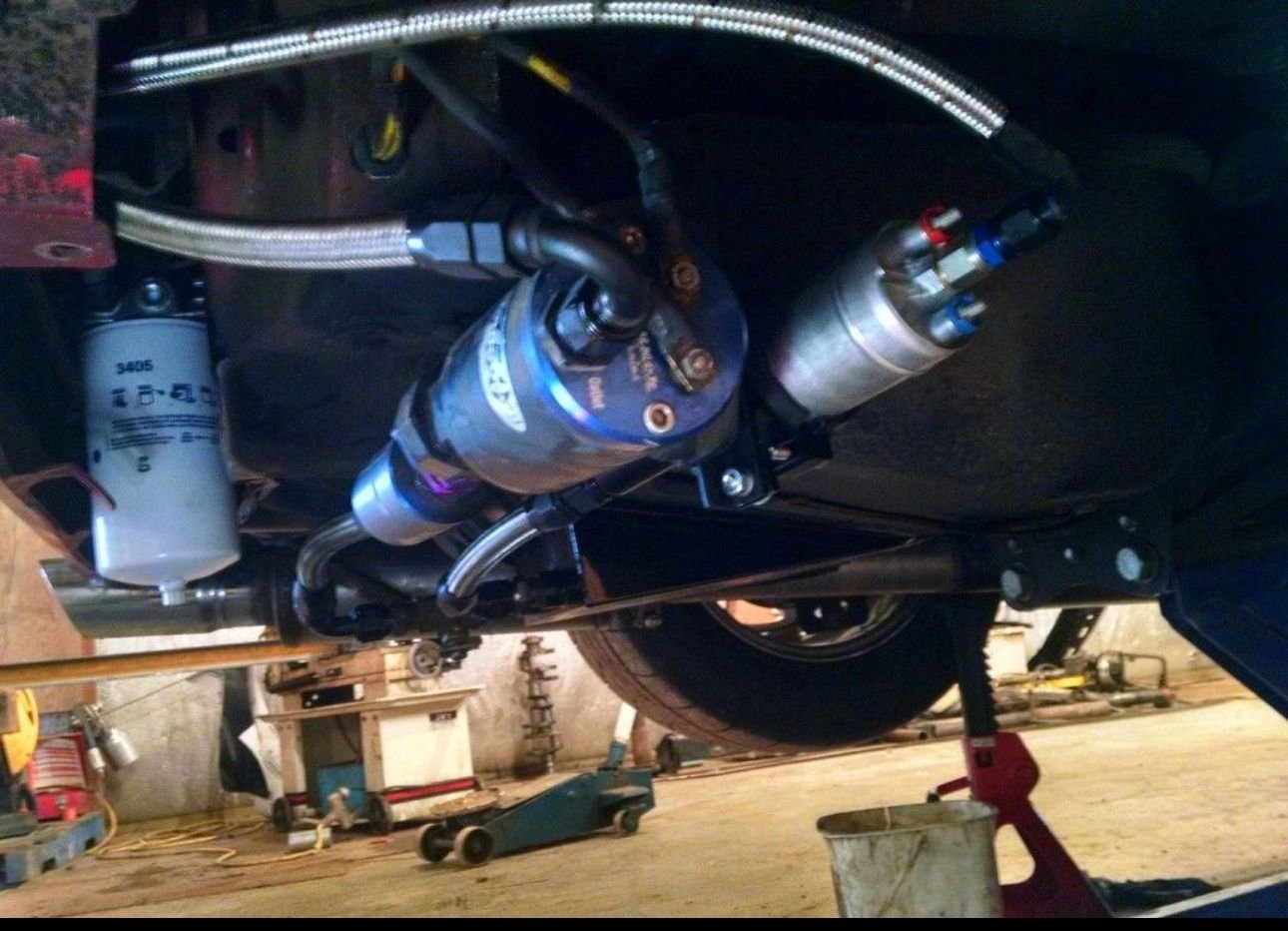

I have always used the wix 24470 base, it has dual inlet and outlet so configuring and plumbing dual pumps is a breeze
i run the Napa 3405 (wix 33405)
I was always fighting hitting fuel pressure safeties and cleaning those stupid inline filters
with the spin on I never drop pressure and I just change it once a year in 19 seconds
I flow over 5gpm on this setup no problem (044 and 2345a now)

it is enhanced cellulose, 12gpm, 14 micron
i have cut it after a year in e85 and looks like new so take it for what it’s worth
