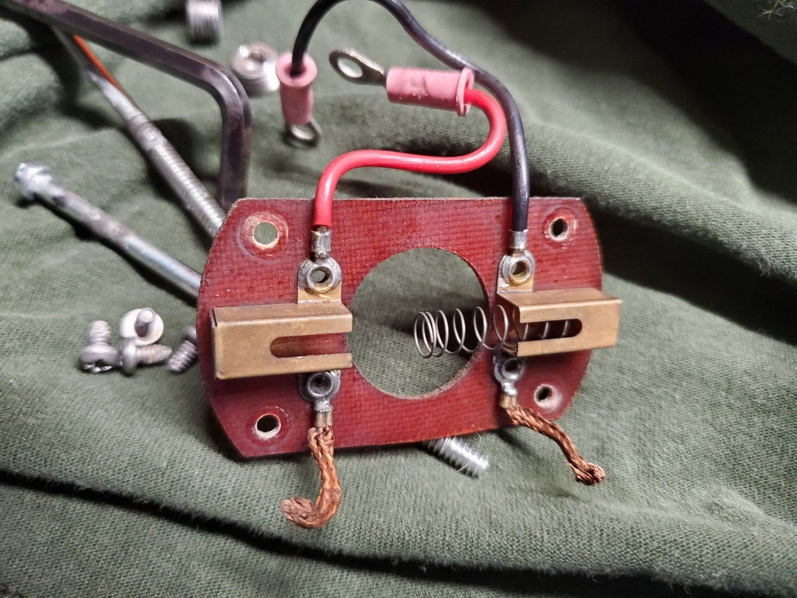

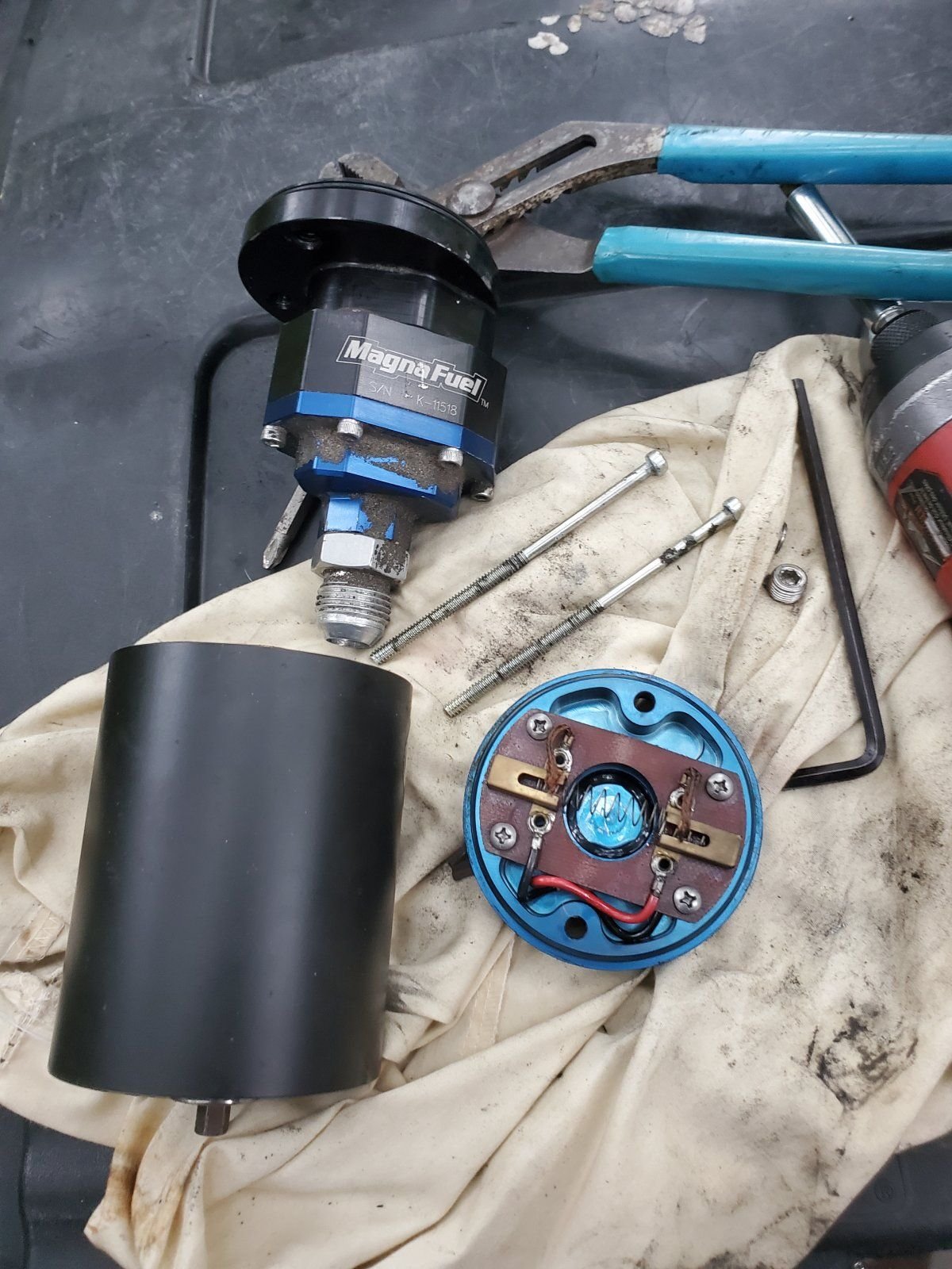

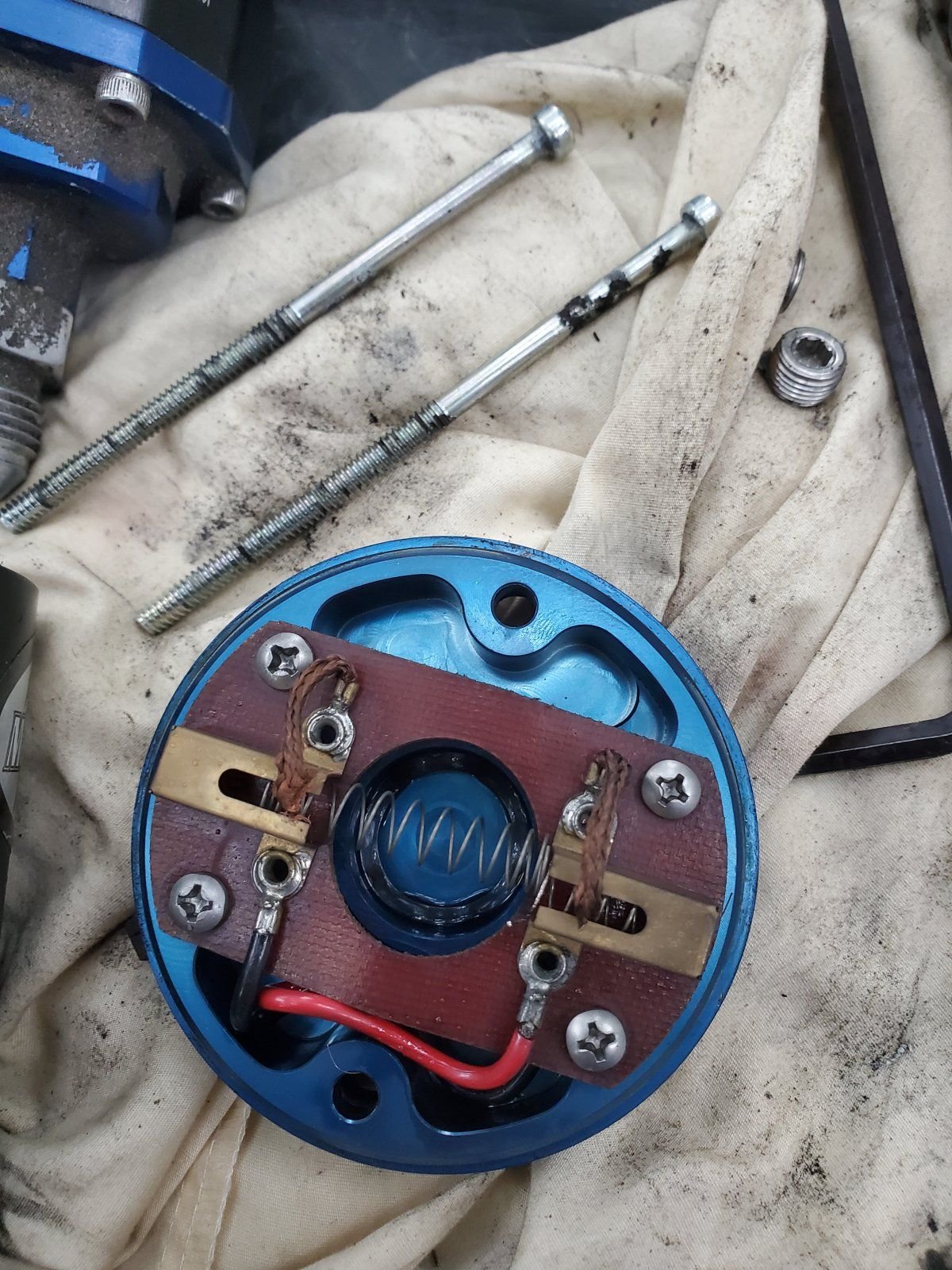

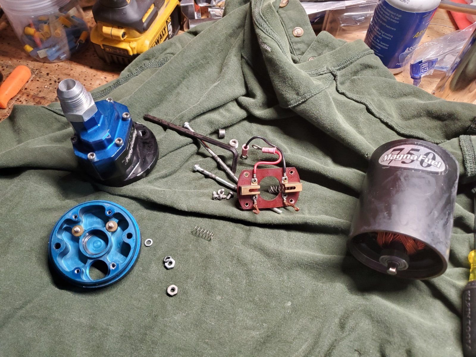

i use one as an aux pump on a hobs, lasts about 2 years usually
the brush kit is like 35bux and the oring kit is about 20 iirc, these pumps are very simple to rebuild. only other thing that needs to be done is to clean up where the brushes make contact to the armature.

problem with using as an aux, im guessing, is it goes from off to full blast as soon as the relay closes. there was still some brush left it just broke away from the lead
10an feed with magnafuel pre filter for a while, then the aeromotive 12an (was going to switch it to a 7gpm). i think they were(are) 75 or 100microns
I'll see if i can find the pictures but the rest of it is just assembled stator on the housing and the armature just free floats and the bearings on each end center it, pain in the *** to get back together. where the brushes make contact was a little ate up so i just flattened that back out, brushes are spring loaded so i didnt worry about removing material from it.
the actual pump gears i took the cover off of just to inspect for any damage to the gears but it all looked clean.
