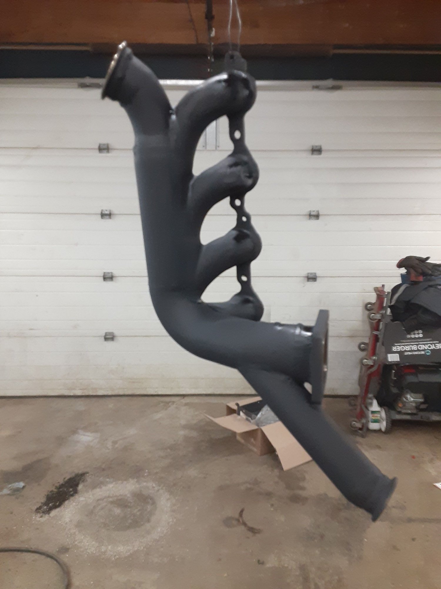

I really would love to have an alloy block 5.3, and I hadn’t heard of lc9 until now, that will give me something to look on car-part.com for. Would I have to use v-bands? I was thinking about getting the factory down pipes from the junkyard too, that way I can make my own custom crossover pipe with the factory exhaust flanges. And yes, I believe that a new set of lifters would be in order if I refreshed the rotating assembly.
pretty good chance that the truck manifolds won't fit with stock flanges on them - they are huge. Welding v bands on is dead easy with only a mig welder . My take on the aluminum block is, yes it would be nice to have but totally unnecessary for a street car , saving 90-100 lbs on a 3800lb car ( guessing ) is really nothing. Ì mean if it costs the same - great. If it costs the same as an iron 6L I'd go that way ( not sure if some of the engines mentioned already are 5.3 or 6L ) aluminum 6L would be great. A rusted out 04 -05 savana/ express is a good source for iron 6L with cable throttle and pressure regulator on the rails and 2wd trans . I see you have the driveline worked out already. As you can tell I'm a cheap*** but your power goal can be met easily, cheap, reliable and fast enough

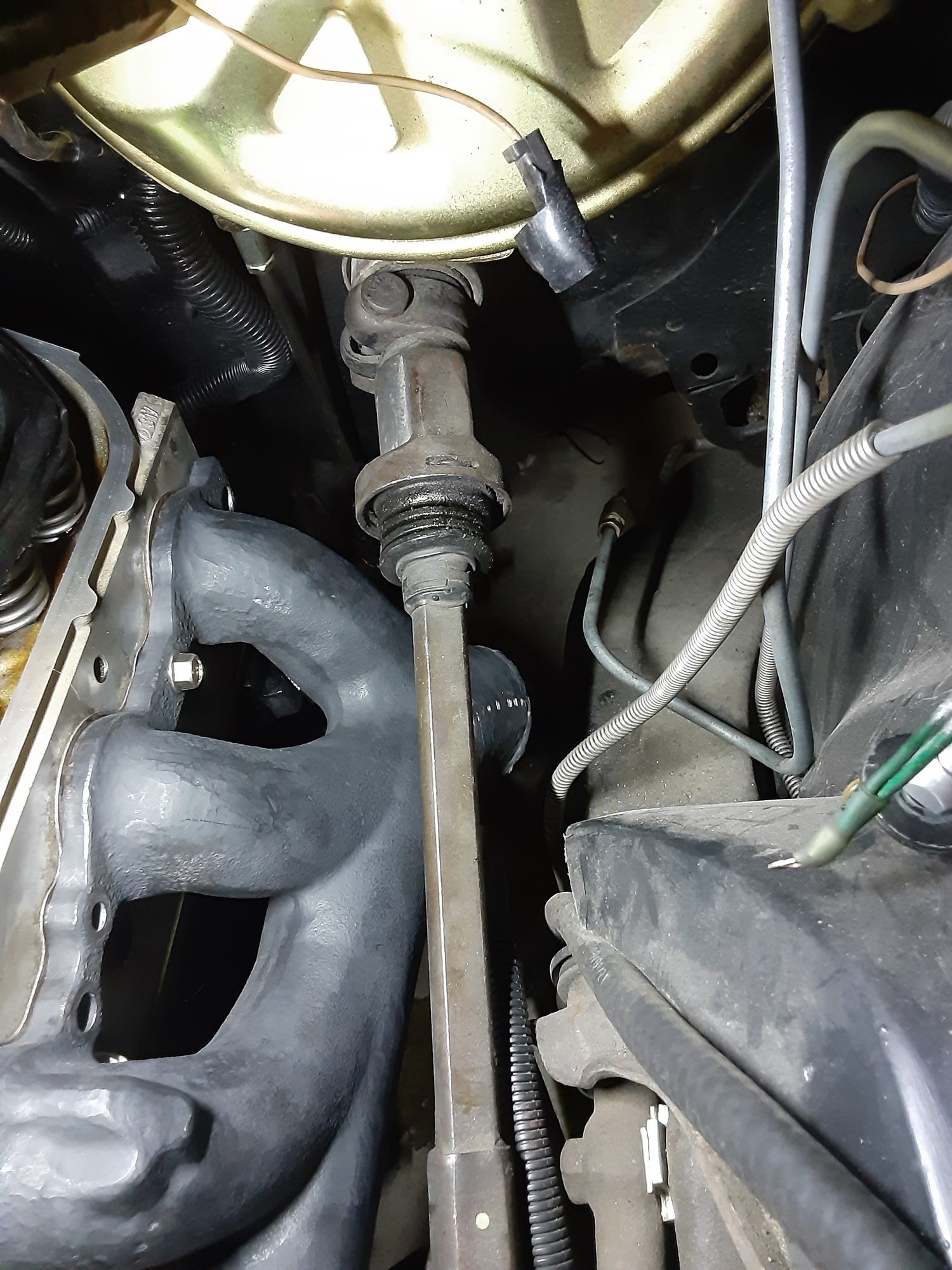

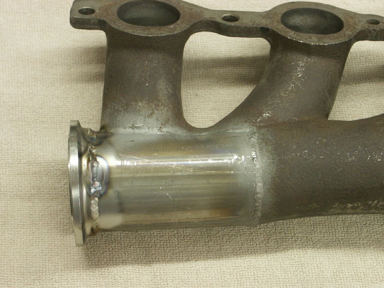

You obviously have some fab skills, I made this log type manifold from a DS truck manifold and some doner van exhaust tubing- works great . Die grinder and mig welder only. The one pic shows the drivers side manifold to frame ( 72 monte carlo) would never fit with the 3 bolt flange on it . Of course you can run them both forward , like I did with my truck but I did this for a friend partly just to see if I could and because it looks cleaner/ nicer
you do some very nice work! I hadn’t considered welding the stock truck manifolds. I take it that means that they are cast from steel? I’m pretty good with a big welder and I have a pretty heavy duty tig welder as well at my disposal

They must be steel, I had my doubts about welding to them but reading on this forum convinced me to try it . Mine has been together 4 yrs / 23000 miles without issue
