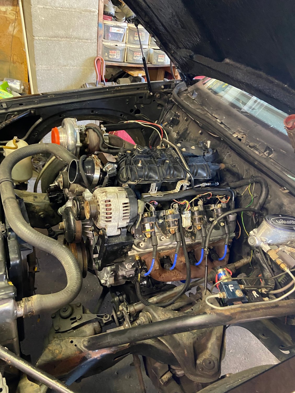

Well the beater Buick is coming together. I have to finish up the wiring and fuel system and a few loose ends (about 20). And it’s getting there .
we will see how it runs . Going to be on about 11 psi boost on e85 to start and work out the kinks then add a second fuel pump and crank it up from there.
hope to start it this weekend.

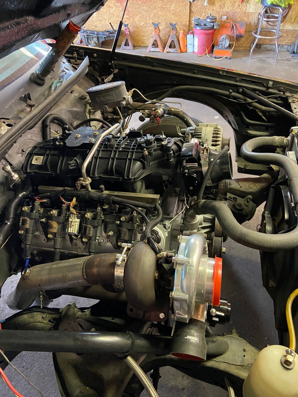

Great project! Do you have any pictures of how the manifold cleaned up after you knocked off the flash? How is the plug access?
Old Jul 20, 2023 | 10:03 AM
yenkomike's Avatar
Joined: Aug 2013
Posts: 1,415
Likes: 182
From: oxford mi
Plug’s are tight but not bad . On the inside cleanup I just opened up the first inch or so where it was reduced to much then used some 6” long burrs to reach in and smooth the inner ends of the ports . They were very ruff with lots of casting flash .
not a real quality manifold but I think it will work as well as my 78/75 .

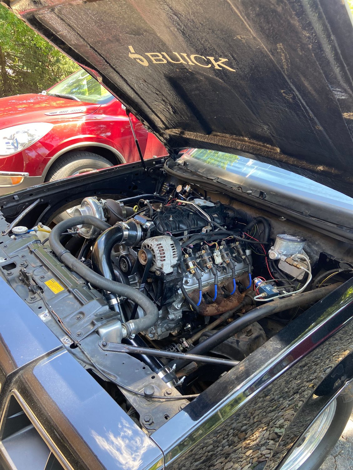

Up and running. Working on the tune but it is moving under its own power.

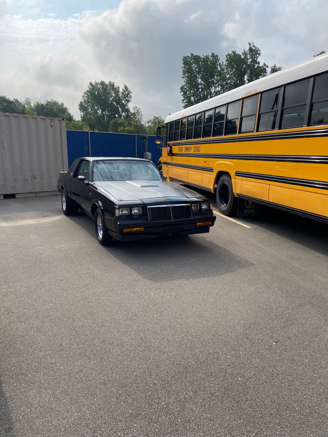

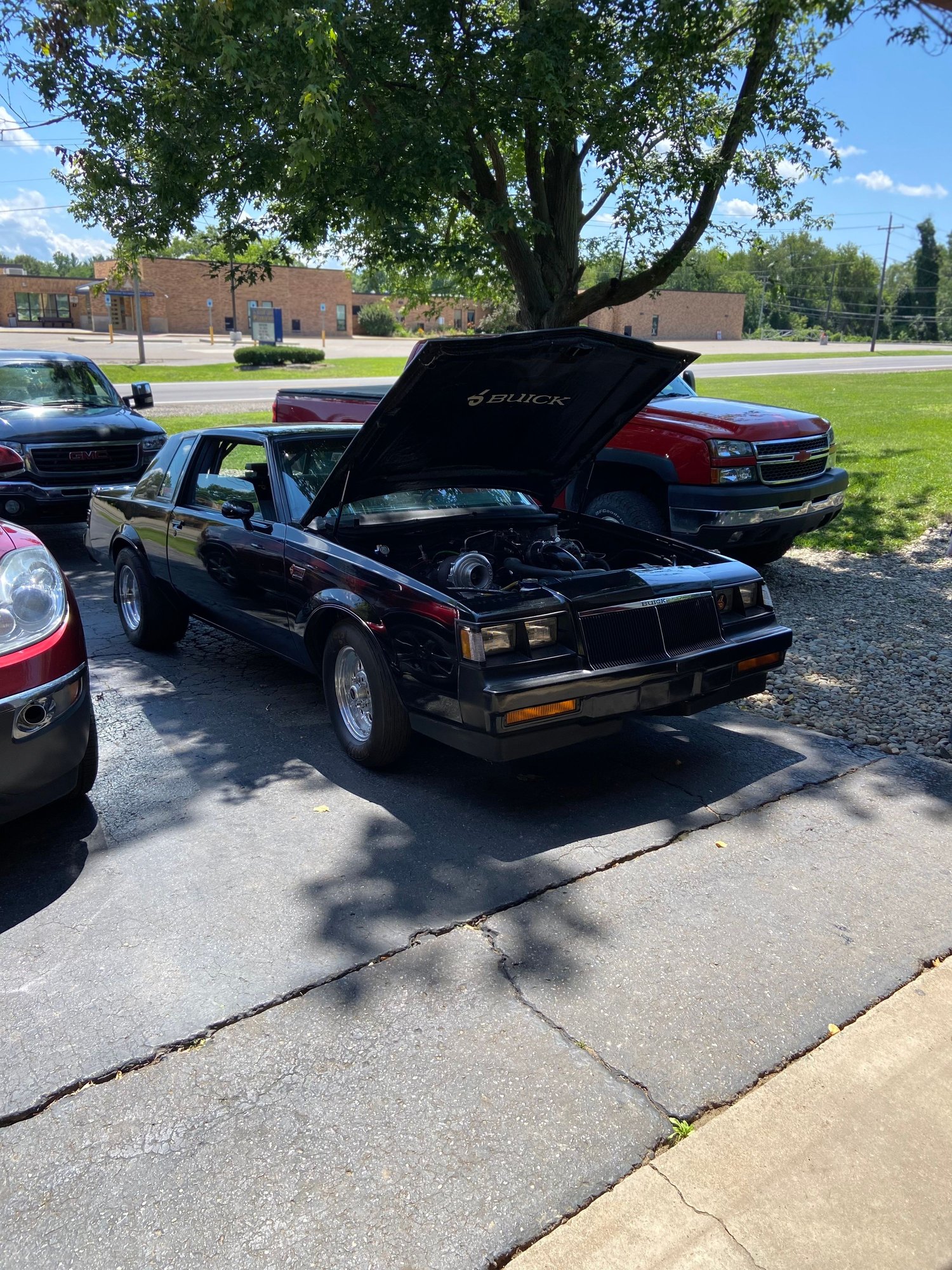

After 35 years as a trailered race car it is driving again!

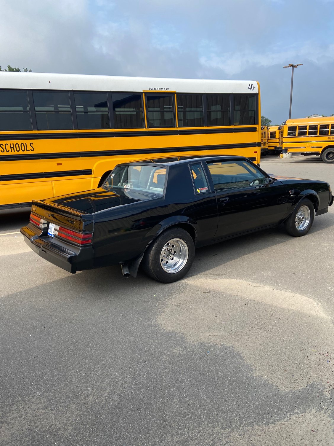

What did you end up doing for an exhaust?
I see the down pipe and the tailpipe at the back, dual exit on the exhaust with a cutout?
Old Aug 10, 2023 | 09:36 AM
  #33
yenkomike's Avatar
Joined: Aug 2013
Posts: 1,415
Likes: 182
From: oxford mi
right now is is a full 3” mandrel exaust with a flow master FX. Muffler . No cutout yet .
it has a 4.30 gear so my next thing is to get my 3.50 gear installed and then just get the tune dialed in with a single fuel pump and enjoy it until
the weather gets bad .
a second fuel pump and a cutout will be my winter items.
