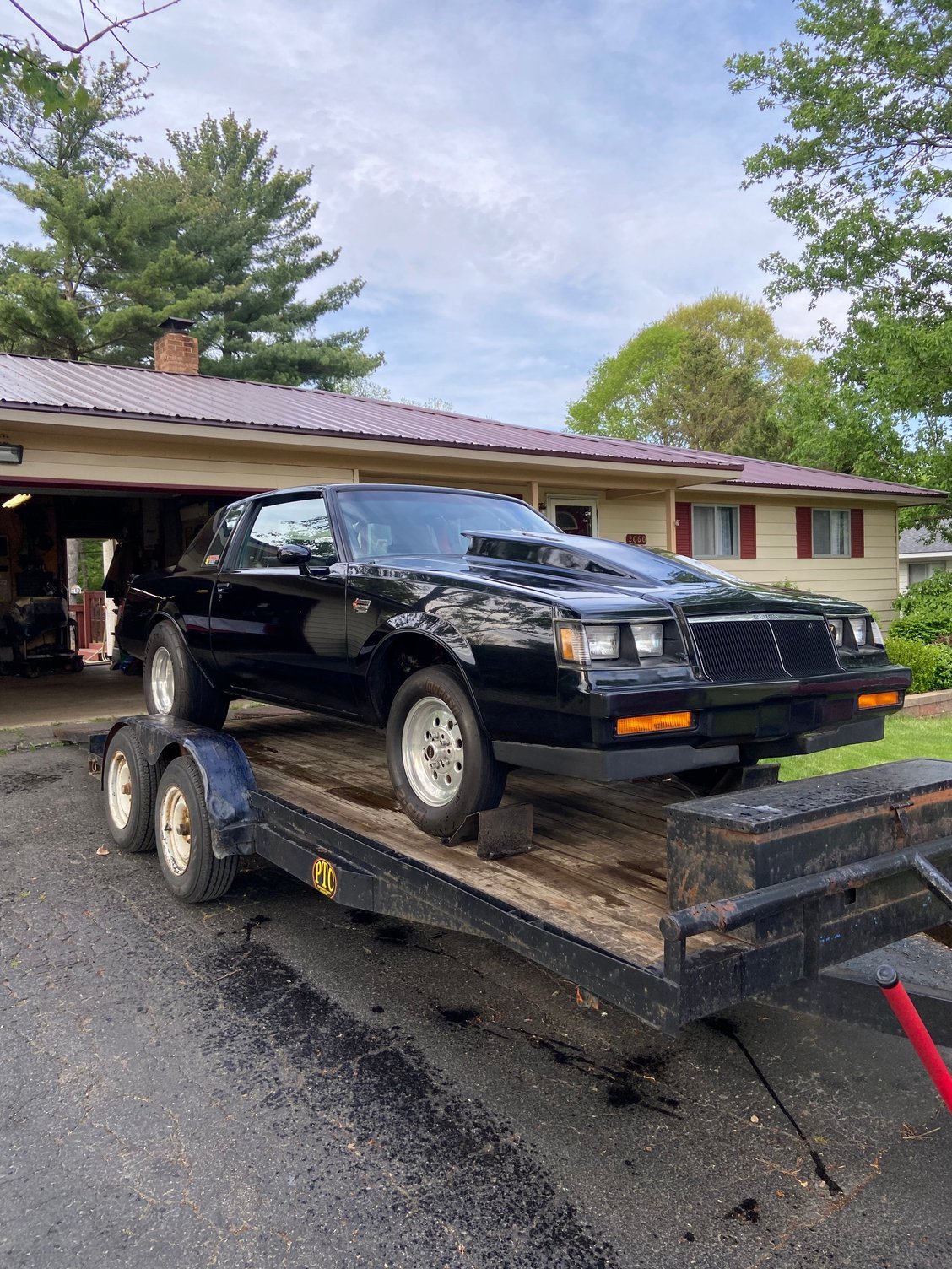

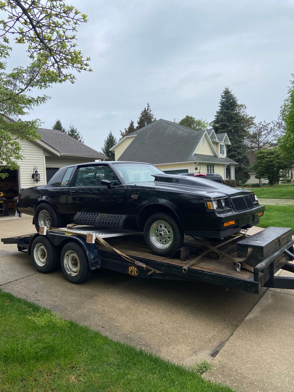

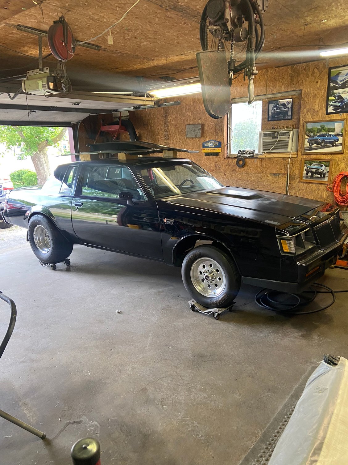

Well after messing up last year and getting rid of my ls turbo gn I decided to sell my nova and search for another Buick . Found a 86 roller with 9” axle and nice moly cage . So it begins again .
goal is a 9 second driver that shifts itself. I have a good 400th and converter.
picked up a L33 to use . Going to gap rings and use a truck style cam for more torque out of boost and faster spooling. I’m thinking of sticking to a t4 turbo as well but not sure just yet .
needs to spool good without trans break

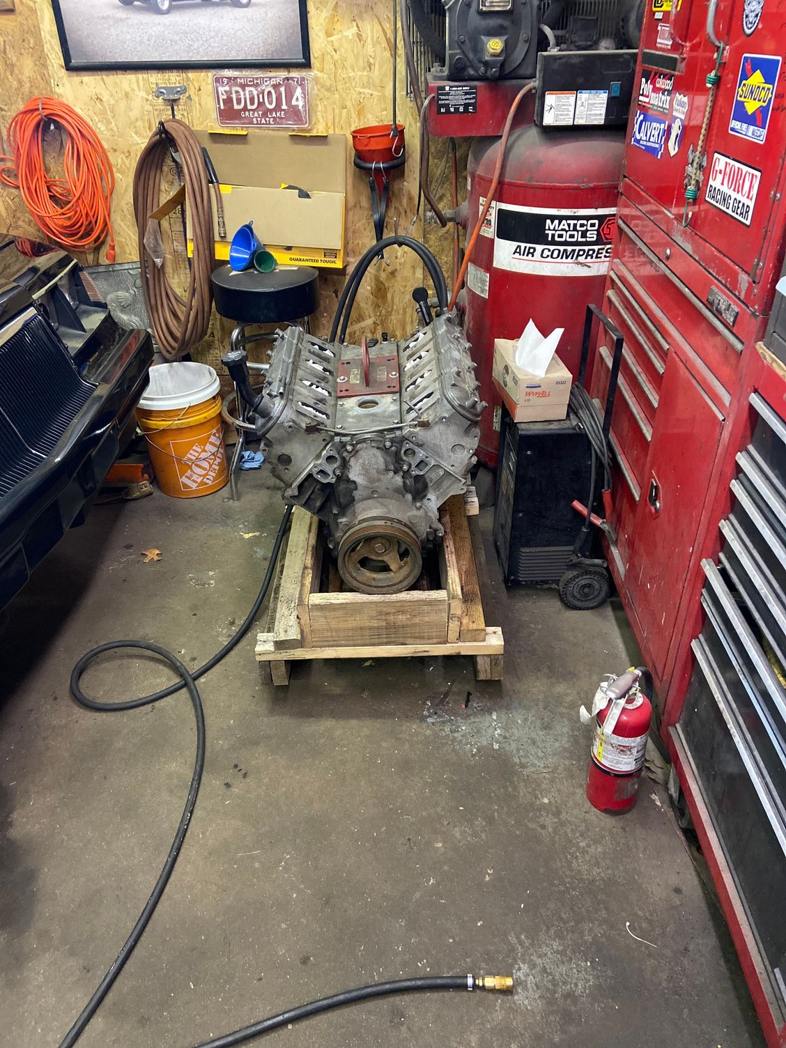

Thanks. This one will get there eventually. Picked up a good running L33 and a 400th so far .

Picked up a fiberglass hood and my greasy L33 . Slowly getting things done but it goes faster in the winter when there’s nothing else to do . Lol

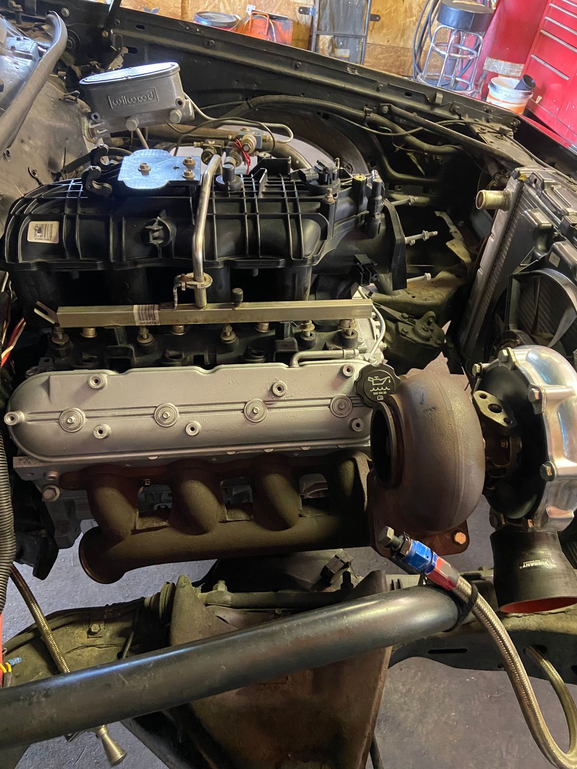

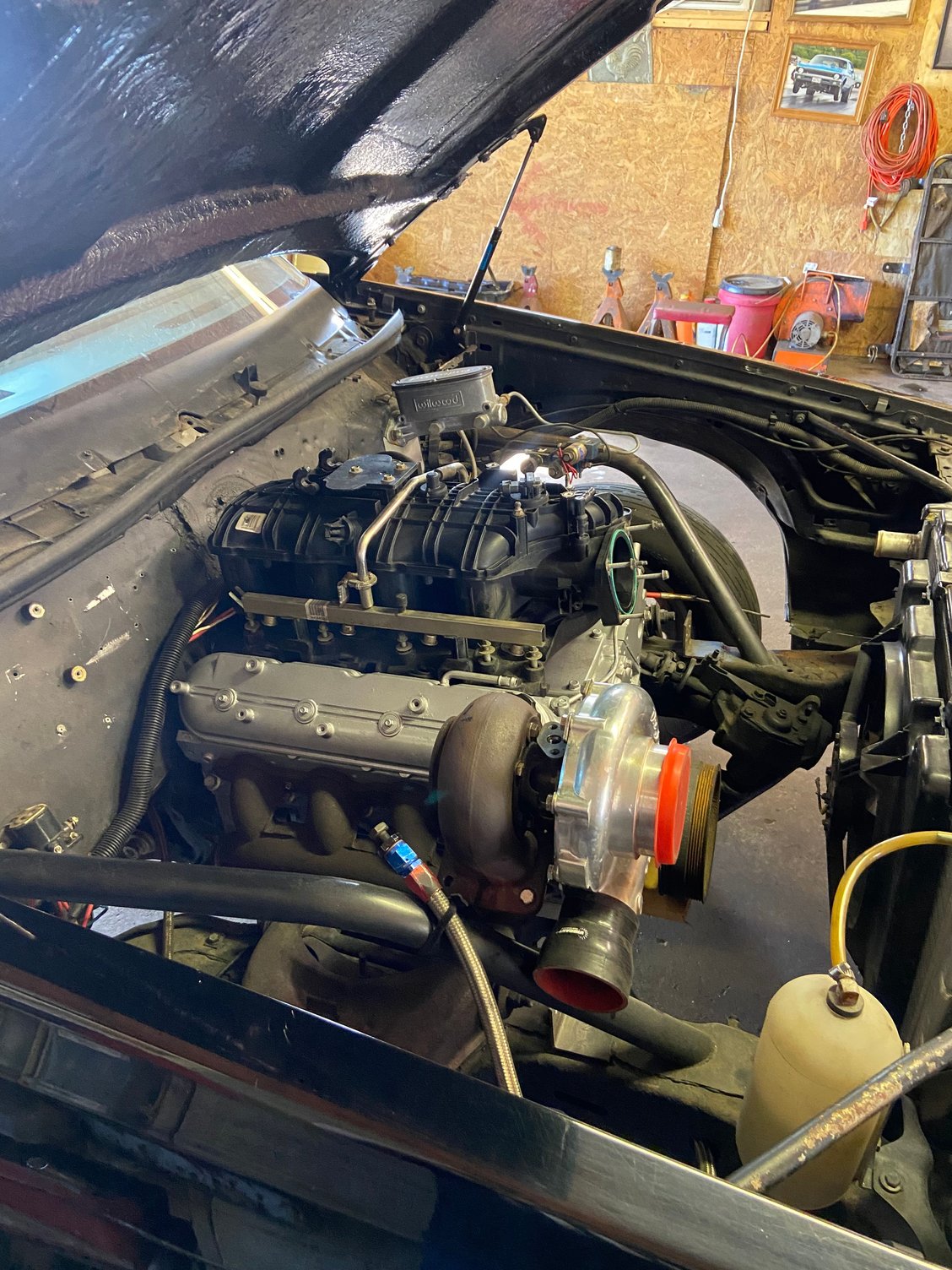

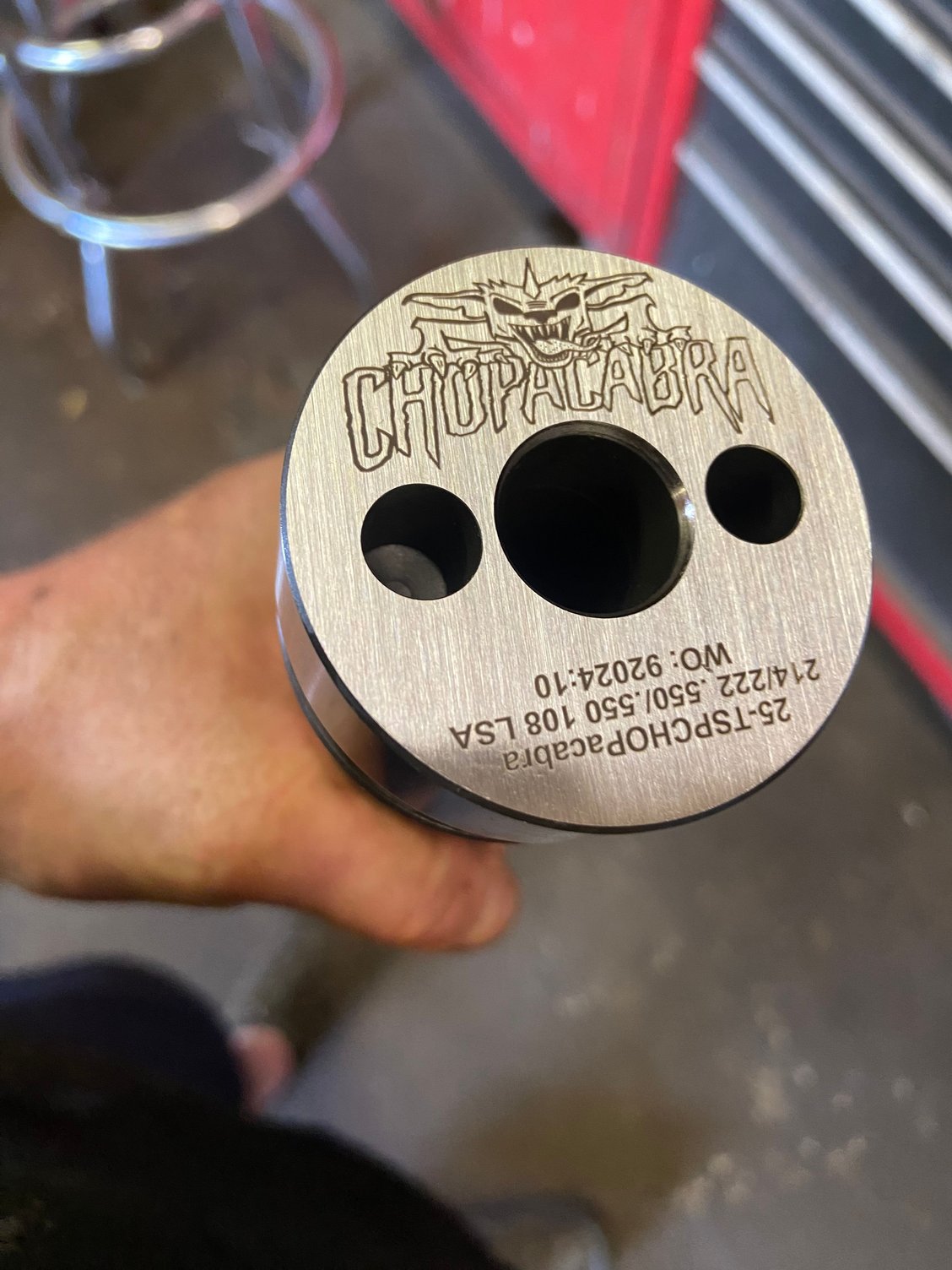

Going to start with this smallish torque cam to help spool without a trans break . And I’m starting with this little cheezy on3 7875 turbo I got from a buddy. Although he went 9.teens with it at 147 mph on a 5.3. Maxed out in a second gen Camaro.
not sure about the China turbo log manifold but I’m going to clean it up with a burr and try it out .

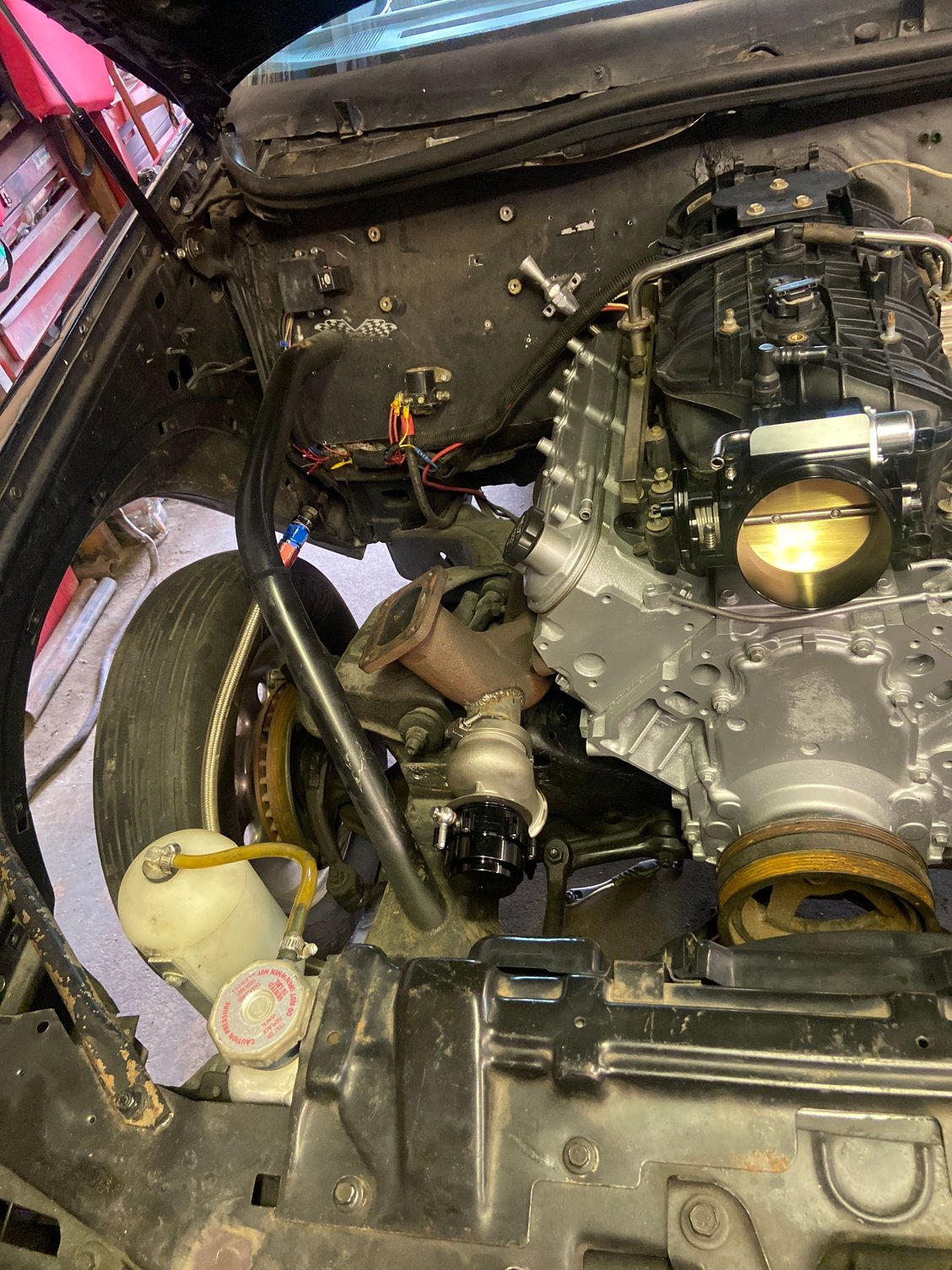

Cleaned up the casting flash in this manifold and added the wastegate.

Glad you posted the pics with the 78/75 and china log manifold, was curious how it would fit. Did it weld OK-My Hornet had a small cam like that, and the 78/75, boost was pretty instant.

My idea with this cam and turbo picks are to spool as fast as possible without a trans break .
it took me a while to clean up the ports on the manifold with all the casting flash and it did weld pretty good . Very thick casting so it should hold the turbo up fine .
its not ideal but I do think it will work as good as the turbo on my 5.3. But not as good as a devided t6 for ultimate power.

Instant boost sounds like a winner, you get up these 80 series and they lag a bit before they wick up.
