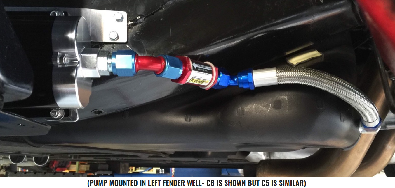

You would basically be adding another fuel pump for simplicity. Have you seen how the factory C5 AA corvette blower kits do this? They just drill and tap the poly fuel tank. Run an inline pump directly to the service port on the factory rail. Works pretty slick.
https://www.aacorvette.com/dual-pump...-10-11-12.html
A single AEM400 is good for 500-600ish WHP on E depending on how its plumbed and supply voltage. Could simply plumb one to your regulator with some small easy to run -8 line. I wouldn’t go larger as its dedicated to a single pump and -8 can easily flow what that pump can handle. Once you start adding multiple pumps to a single line is when you need to bump up the line size IMO.

Is your fuel tank composite or metal? I thought the 99-02 camaros had composite tanks? If its composite. Just drill and tap it with a fitting. Quick cheap and easy.

Correct the later ones are plastic. Not much room under there - trying to keep the pump inlet even or below the pickup point can be a challenge.

Not similar to the C5 and C6 tanks you can just tap an drill like so?
That's doable, I didn't even know you could simply drill and tap the plastic tanks like that lol.
I could mount the pump/s to the bottom of the t-top well and it'd be below the pickup then.
If the twin 450's proved to be insufficient, a single AEM400 looks perfect and holds flow way better at like voltage/pressure compared to the Walbro 450.
