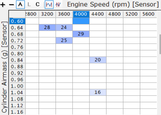

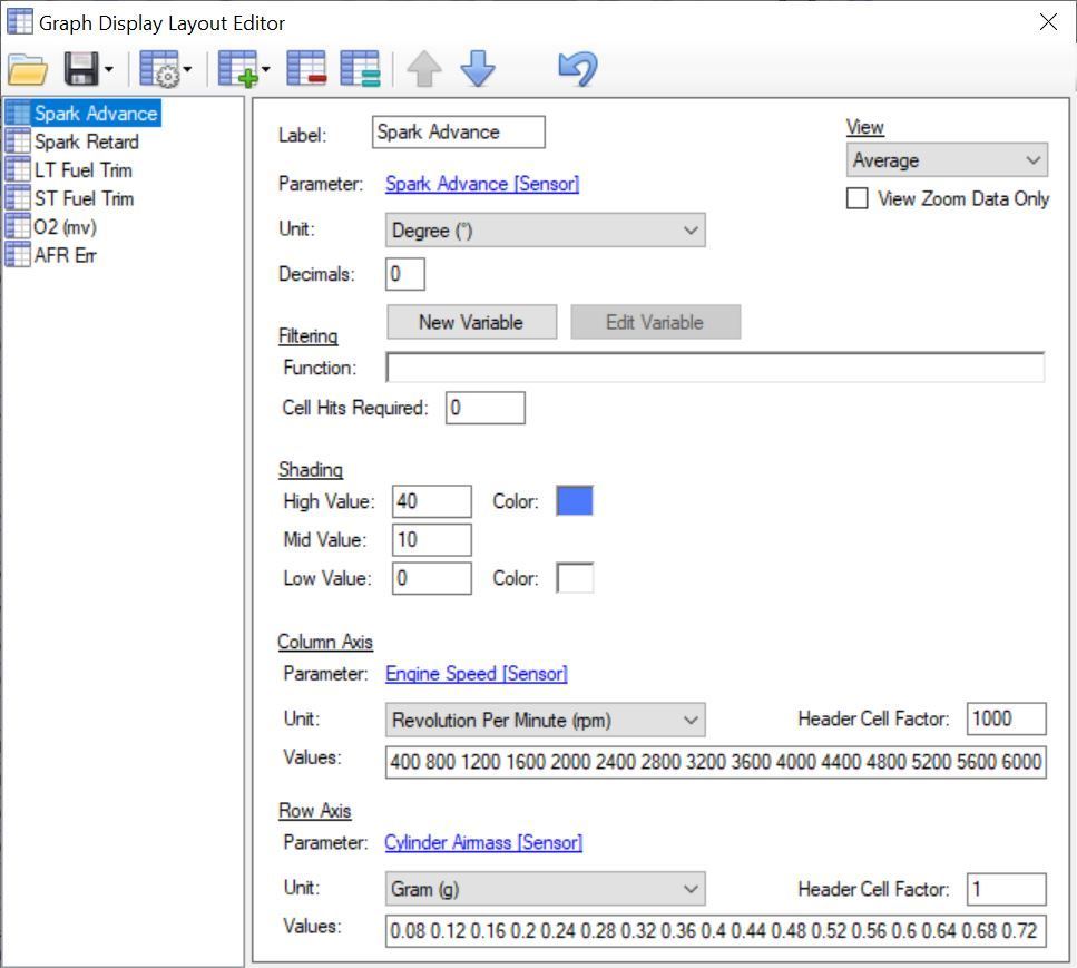

This is what mine looks like - I haven't used it in a bit, but I believe it's correct.
Old Jul 24, 2023 | 02:26 PM
  #82
Black_Sunshine_99's Avatar
Joined: Mar 2013
Posts: 3,858
Likes: 838
From: Washington
Ah okay, I've already got that histogram set up then.
Thank you!

i just mean the normal traces over time, not a table or histogram. its just how i can relate to the data more clearly. the histogram would be helpful along side it though.
Old Jul 24, 2023 | 03:17 PM
  #85
Joined: Mar 2013
Posts: 3,858
Likes: 838
From: Washington
Something like this?

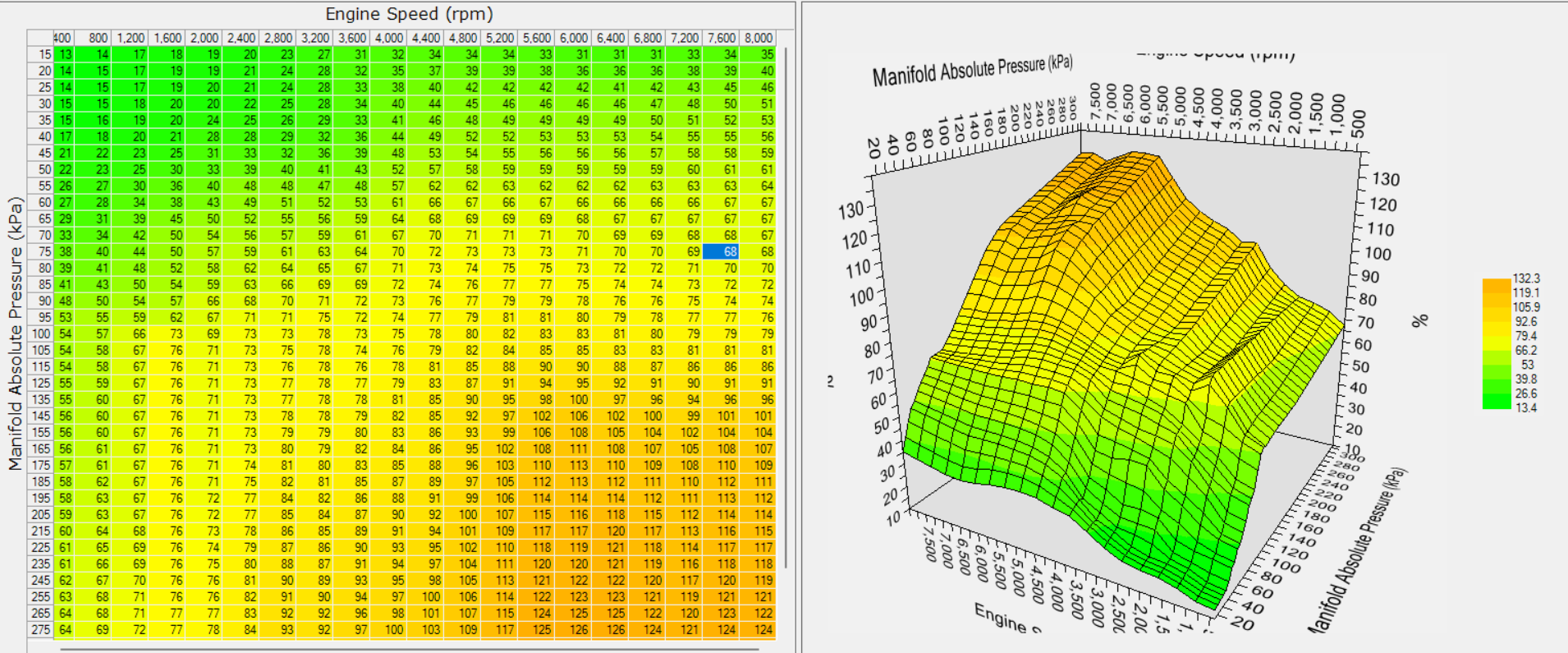

if your tune is tight you will see ve peak at peak torque and taper back down at higher rpm. You will see this in ipw if boost is flat across that range.
So if I understand what your saying then mine is between 5,550 and 6,500 rpm?
Attached is a snip of my VE table.
My injector pulse width is as follows in third gear.
B1 - 12.9ms @ 5,900 rpm, levels out to 14.0ms at 6,000 rpm, then at 6,100 rpm jumps around a little bit between 13.2ms and 14.2ms until 6,400 rpm when I lift.
B2 - 12.7ms @ 5,900 rpm, levels out to 14.2ms at 6,000 rpm and hovers there until 6,300 rpm then drops down to 13.4 at 6,400 just before letting off the throttle.

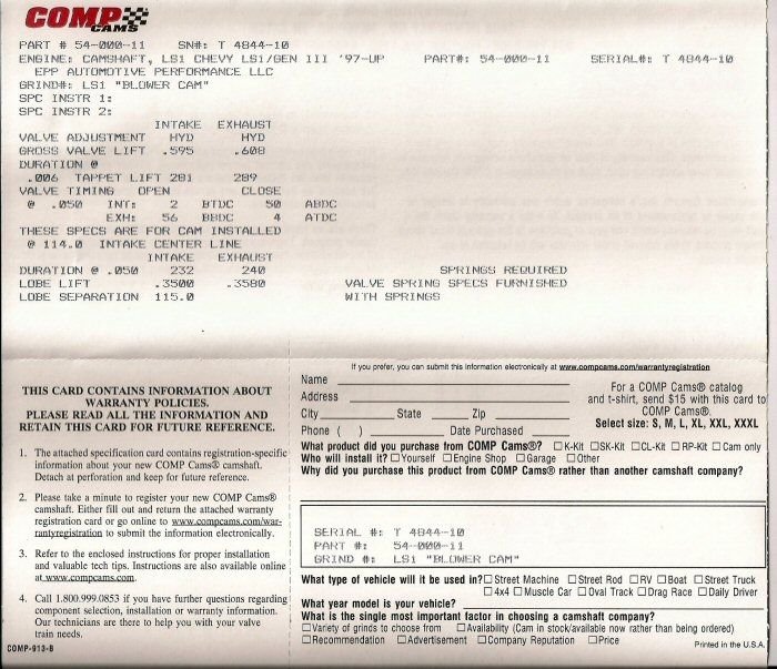

Here's the cam card, it's Brute Speeds FI cam which Bob had said is good to about 6,600 rpm but its very happy being shifted at 7,000+rpm.
