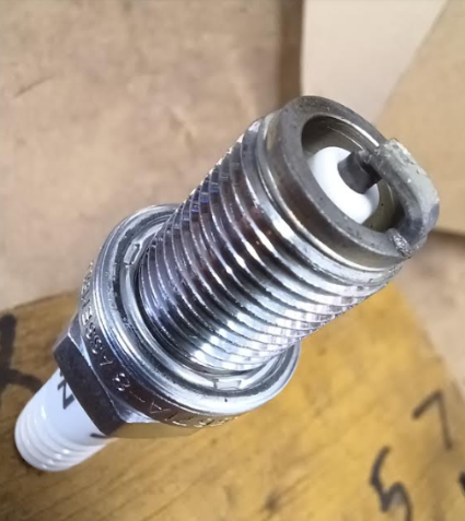

IMO when just starting out, you’d need clean plugs to read them easily. Otherwise, the electrodes have so much info on them from cruise and multiple pulls you can’t really read the peak heat well.
I know it’s a pain, but I’d buy 16 new plugs and throw them all in the car. Take all tools to change them out with you. Once you get to your “test ground” Install the 8 new plugs. And cycle the other 8 in/out of the hottest cylinder when dialing in timing.
Do a full pull with very little idle/run time and shut the car off at the end of the ¼. Pull over and pull all 8. Find the one that looks the hottest going by the strap and color. Then just cycle new plugs from that hot cylinder in the future when tuning. As mentioned #7 isn't always the hottest.
I can tell the plug you pulled wasn’t new with 1 clean pass on it. The timing mark is not clearly visible on that plug. At least not in the first pic. 2nd looks maybe half way, but again. Hard to read.
You don’t want it anywhere near the bend IMO. I’m not sure how anyone can call that “ideal” for a turbo car.
I like this much better instruction wise.
http://www.wallaceracing.com/plug-reading-lm.html
If you really want to push pump gas, lower the compression. What heads are on it now? Can you run 317’s? All the talk of “low compression” making the motor a “dog” is BS IMO. I ran my dished piston 5.3, with ls9 HG, and 317 heads. (around 8.6:1) It ran great. Sure it wasn’t a raspy or snappy out of boost. But you are talking like 4% NA hp per full point of compression! That’s like 14HP on a 350hp engine.
@Forcefed86 can I come back to reading the plug and get a little more clarity on your comment if you don't mind?
So where does the timing mark appear to you?
Based on Steve Morris's video (If I'm interpreting it correctly) I thought the timing mark was just above the base of the electrode where the carbon is cleaned off, initially I thought it was on the horizontal part of the electrode about half between the tip and the bend.
Are you seeing something different?

Without a clean run on a new plug, you are guessing and open to interpretation. 5 people may see 5 different things. If you were to make a clean pass and shut it down the timing mark is unmistakable, in most cases. Esp. with pump gas or race gas. Alcohol plugs of any kind are harder to read.
This is a new plug with 2 runs on it at the track and no WM. ET and MPH were the same with the WM on VS off. The plug heat read about half way down the strap with 10gph of 50/50 @ 23ish lbs and 14ish*. (e85 car)
This about where SM and most others think “good” is. IMO this on the edge for a street car. Can certainly on the edge for a pump gas car. I’d add fuel, up the WM, or pull 2 degrees for a “Safe” tune. I’ve nipped a ringland or 3 on tune-ups showing that much heat…
What a motor will take timing wise varies a TON as well. So if SM has some nice large domed smoothed combustion chambers and great parts all around, they will likely take that tune up and more.
The other issue is the plug itself. If I were to put a #10 heat range plug in that tune with no other changes and make a pass… the heat mark on the strap would be completely different. So you really have to take all the plug reading and timing suggestions with a grain of salt. They are very combo specific.

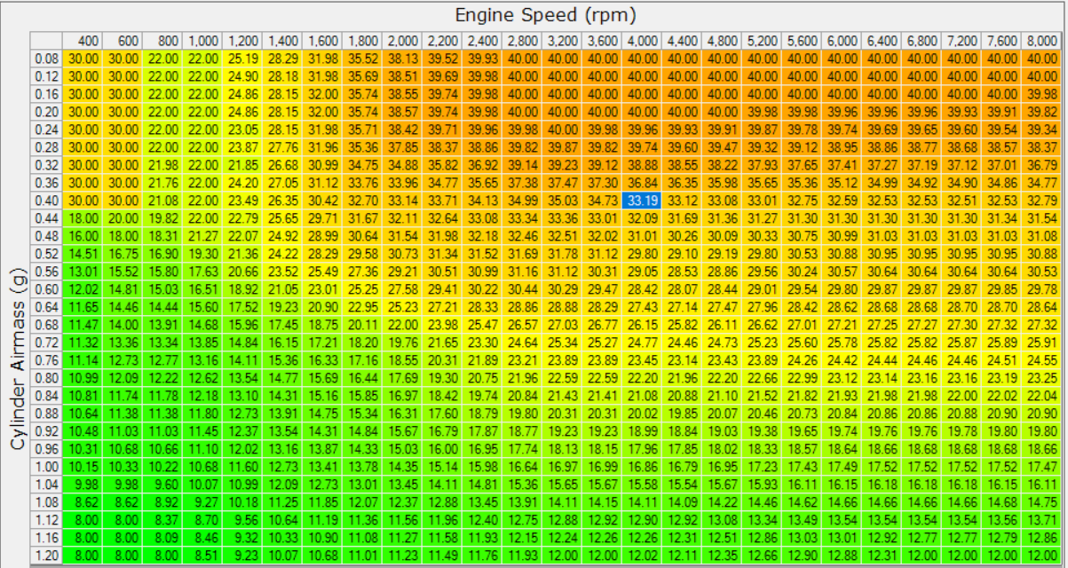

Okay so @Forcefed86 talked me into pulling a couple degrees of timing instead of lowering the boost level which he didn't have to try very hard since I really don't want to turn it down lol.
So, my next question is where would I pull 2 degrees timing on the timing table? (See below)
Thinking 5,500 rpm to redline but not sure how far to go on the cylinder airmass side.
