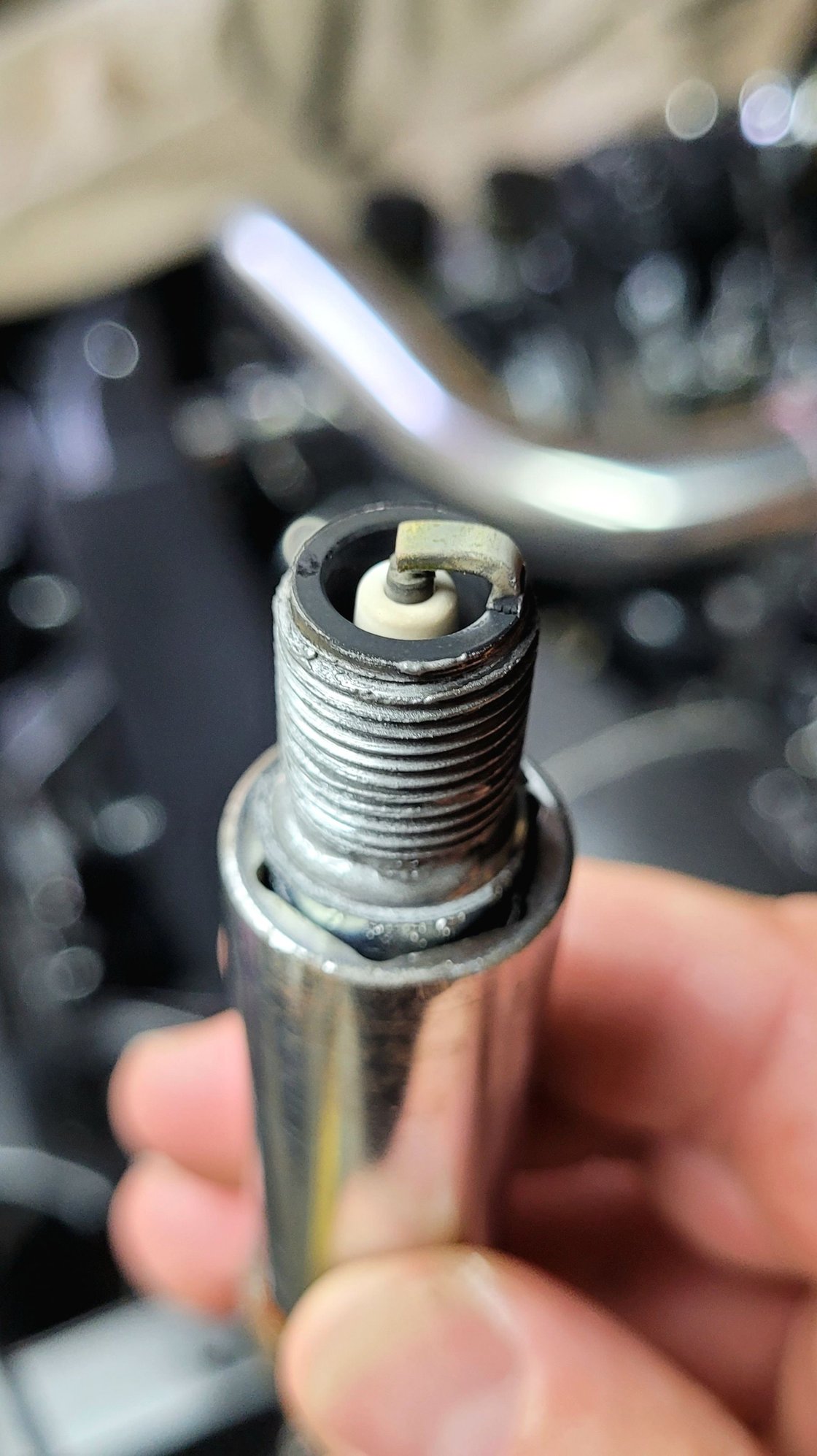

Here are some pics of plug #7 which from my understanding is the leanest plug and the one most guys seem to reference the most.
So if I'm reading this right, my timing is pretty close where it needs to be since the timing mark looks to be right down close to the bottom ground strap?
I didn't cut the plug in half but the porcelain was white way down towards the bottom, probably because I was a touch lean when I was making these hits, my tuner fattened up the VE table so should be happier now.
turn the plug 180 and give us a good shot of the porcelain.

don't see any speckling from that angle, and porcelain looks ok. appears to be tuned right.

Is this better?

Yep. Timing is OK and I don't see any black or Metallic speckling on the porcelain. Now check the threads and see how many threads are discolored. That'll give you an indication of plug heat range. You typically want 1 to 2 threads discolored.
Why is timing just OK?
According to Steve's video you want the timing mark right at the base of the strap or am I reading them wrong?
So if I wipe off the anti-seize you'll be able to see the thread discoloration?

I mean ok as in not a problem. You want it at the bend for idea timing. If timing is past the bend towards the threads it's getting too spicy.
Yes wipe off antiseize to better see discoloring of the threads for heat range.
Also, number 7 isnt automatically the worst. I typically pull them all for a baseline. Then whichever cylinder is the hottest gets the attention going forwards to save time.
Got it, I'm traveling for work until Friday but when I get home, I'll pull them all and take some pics.
So I'm looking for timing marks on the strap no lower than the #7 plug shown and for thread discoloration no more than 1-2 threads down.

And any speckling either black or shiny on the porcelain. These 3 things have kept me from blowing anything up since I started tuning like 15 years ago. And I never did it on fresh plugs no runtime.

IMO when just starting out, you’d need clean plugs to read them easily. Otherwise, the electrodes have so much info on them from cruise and multiple pulls you can’t really read the peak heat well.
I know it’s a pain, but I’d buy 16 new plugs and throw them all in the car. Take all tools to change them out with you. Once you get to your “test ground” Install the 8 new plugs. And cycle the other 8 in/out of the hottest cylinder when dialing in timing.
Do a full pull with very little idle/run time and shut the car off at the end of the ¼. Pull over and pull all 8. Find the one that looks the hottest going by the strap and color. Then just cycle new plugs from that hot cylinder in the future when tuning. As mentioned #7 isn't always the hottest.
I can tell the plug you pulled wasn’t new with 1 clean pass on it. The timing mark is not clearly visible on that plug. At least not in the first pic. 2nd looks maybe half way, but again. Hard to read.
You don’t want it anywhere near the bend IMO. I’m not sure how anyone can call that “ideal” for a turbo car.
