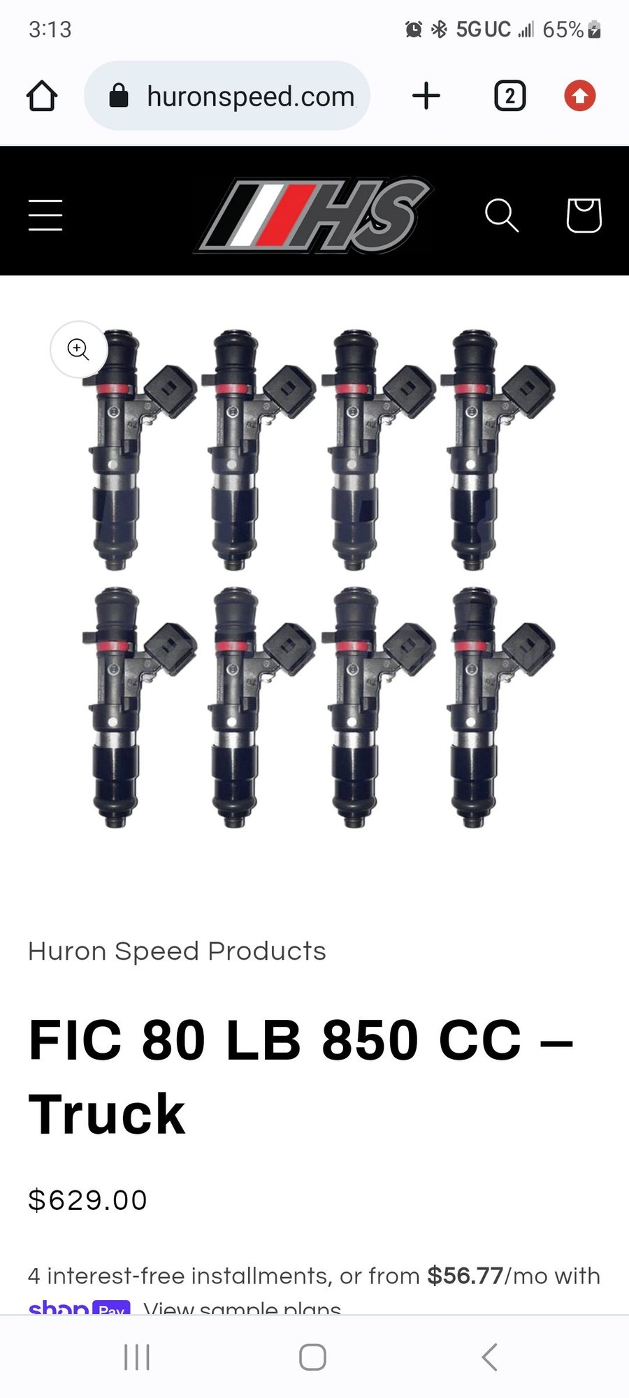

According to aeromotive 1 pump is rated for 490 forced Induction on e85, and the guy who tunes my truck told me to get 80 lb injectors and that would get me to my goal. He's pretty familiar with my truck, I always use the same guy to do my tuning. He owns a pretty well known shop around my town and they build so pretty fast rides. For 600$ I hope the injectors are enough.
This is the injectors i have

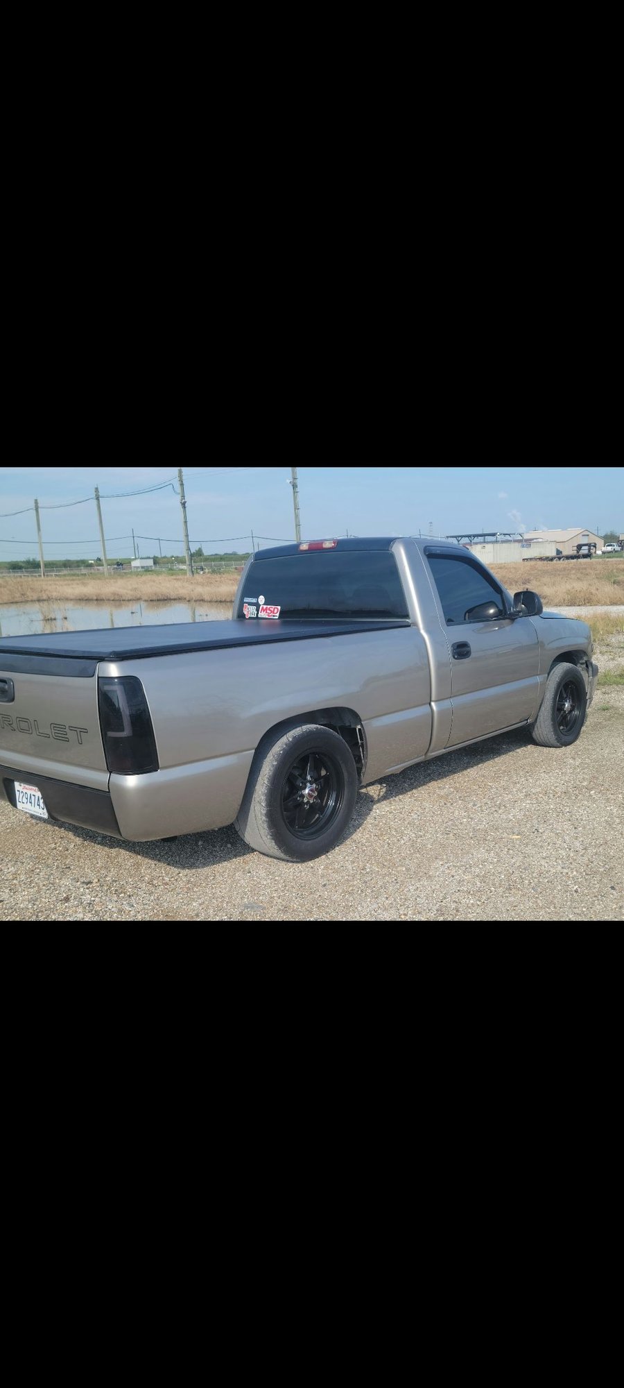

This is the truck

I have two aeromotive 340's and 80lb injectors and on 20-22psi boost i'm at 99% duty cycle on pump gas. If he runs e85, those 80's aint gonna cut it.

I hate to say it, but I think KFXGuy is right.
I currently run FIC1000cc injectors, aftermarket rails, twin Walbro 450 pumps with an -08 AN feed and -06AN return on pump gas only, at 15 lbs. with my S484 I'm at 80% duty cycle which with my setup should be just over 700whp through my TH400 at the very least.
E85 typically will require at least 30% more fuel volume and those pumps flow will taper down as boost increases.
Last thing you want is to be on the ragged edge of what your fuel system can supply.
This is just me, but I'd sell the 340's, get a pair of 450's or external 380's (they taper off less w/ boost), sell the FIC 80's and buy some Bosch 210's.

man I just bought those injectors from huron speed a few days ago, maybe they will let me trade them in for something different because I haven't even opened them. And I had walbro pumps before the 340 and they went out on me way to fast so that's why I got rid of them. I have aftermarket rails as well. I'll call huron speed though and see if they can work something out with me.

On the pumps, you gotta make sure they are genuine Walbro units, there are so many fake copies out there its ridiculous.
Ideally although not cost effective would be to keep one of the 340's in the tank and run a Weldon external fuel pump on a hobbs.
They aren't cheap but when it comes time to want more power (which you will lol) you'll have all the fuel supply you'll need.
That's my plan when I move to another state with E85, keep a 450 in the tank and run something like a Waldon D2035-A external pump.
Jon at Huron Speed is a great guy to deal with, just let him know you were misled about what injectors you needed, he probably has the Bosch 210's on the shelf as well.

I just emailed the sales email that's on there site, that's the only contact information I have on huron speed and ok if i did run an external pump how how i go about doing that? Do i have to run a new line to do that or do I just put it in the middle of my existing feed line?

it sounded like a guy I know, except he’d never tell you 80lb injectors would be good for e85 to make 700 wheel. I live in Louisiana too.
