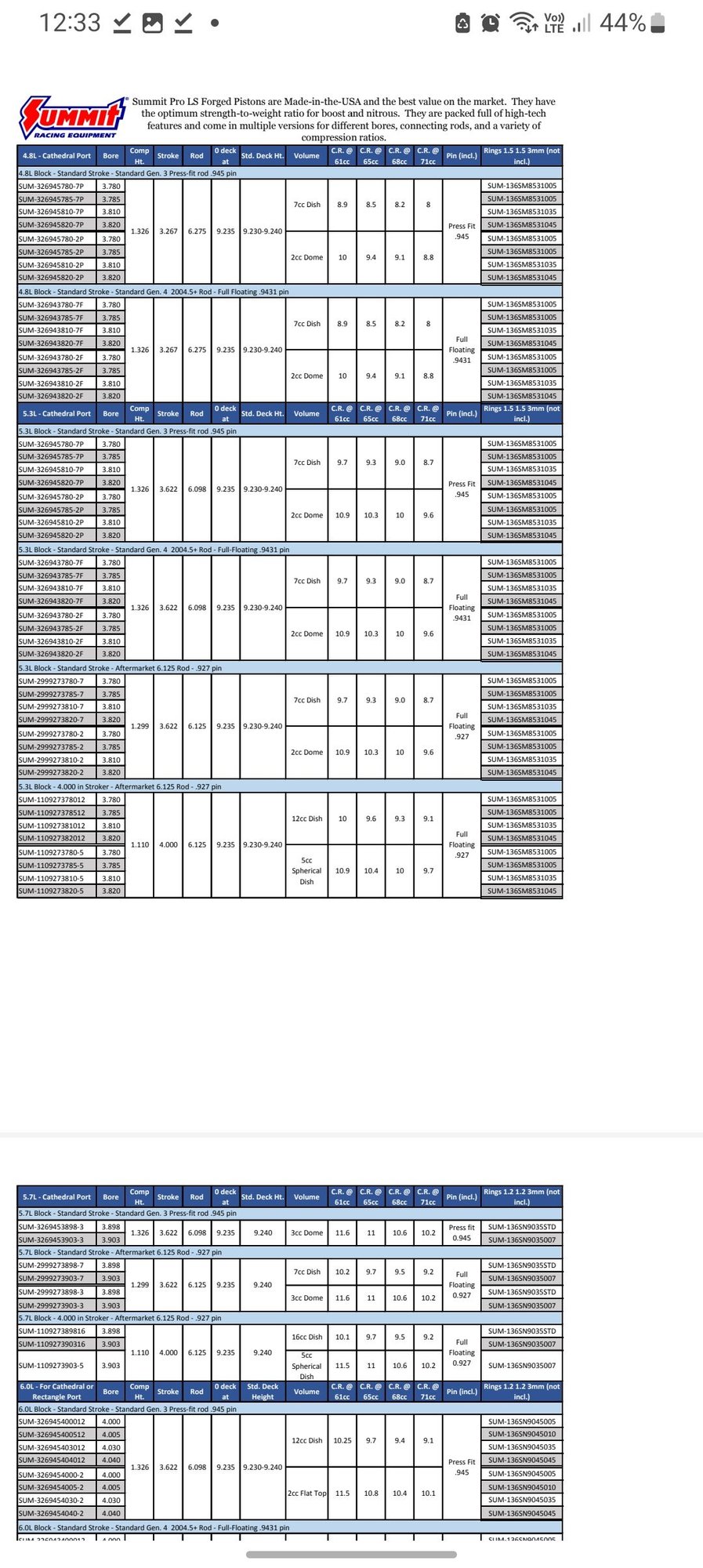

These are the list off summit pros pistons .

I don't believe the Summit 5.7 pistons come with piston pin locks cut I could be wrong. You can use a 0.945" floating pin piston given it has locks/groove on a stock gen 4 rod, but the rods will need a slight pin fitting hone to take it from 0.943" to 0.945" etc. The WS6store also sells a lot of ICON stuff that will work in the the FHR or Premium levels for 5.7 sizes that would work well also.

I have some summit LS forged 5.7 pistons and mine came with lock grooves cut. If I remember I'll post a pic tonight.
I remember when they came out I mentioned that to Brian as it would interest people using stock gen 4+ rods on them. Not much reason to use a gen 3 press fit rod anyway.
