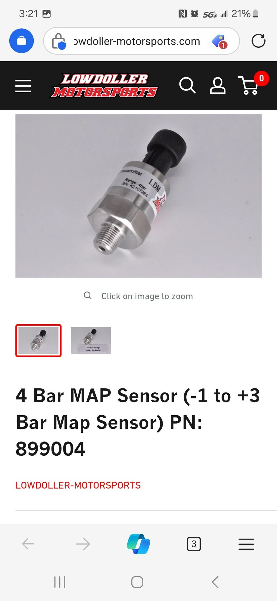

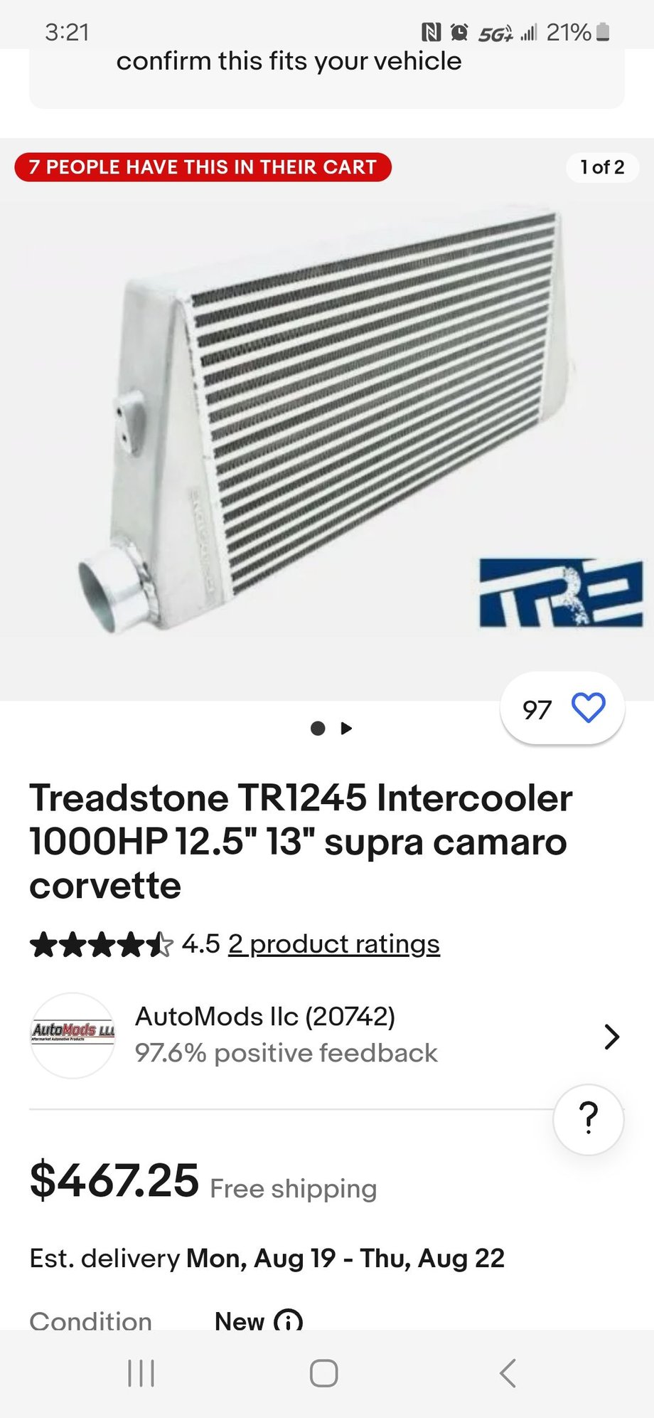

Just a little update, we got the bosch 210 injectors in and my intercooler that's on the truck ain't cutting it so ive got this one coming and my tuner wants to switch to this map sensor so we've got that on the way as well

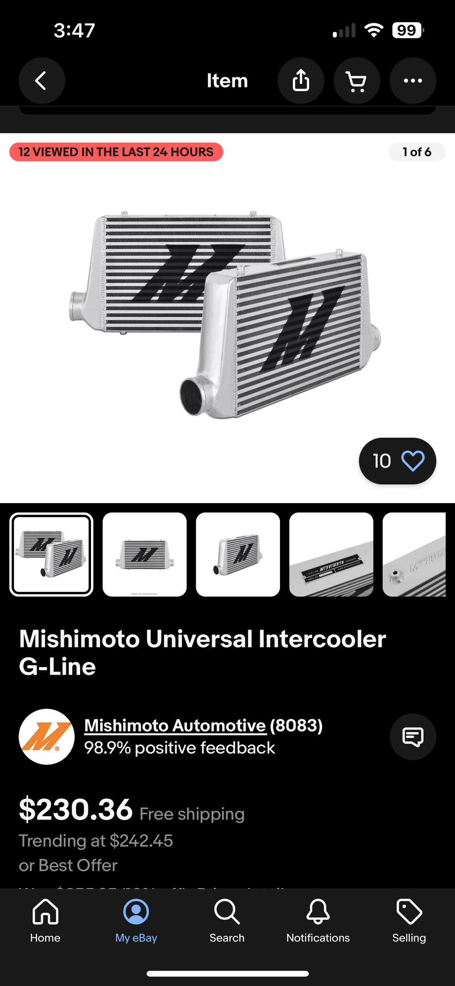

You can get that same sensor for $20 on fleabay….just make sure its 0-100psi……..and that extra $80 u just saved can go towards an intercooler……ive had GREAT results with mishimoto intercoolers and they are alot cheaper than the treadstone ones , but if it makes you sleep better at night , go with whattcha know!!! Good luck man!!!!……were all waiting patiently for them final (for now) numbers!!!

This particular one is 25”x12” overall and 3” in/out….it does quite well for my vortech v-3 centrifugal blower!!
It's worth about $3, junk ****. Had several of these lowdollar sensors come through the shop and every single one of them was the most unstable most unreliable POS I've ever seen. I've got to wonder what tuner is actually recommending these things...
I'll never understand why people skimp on a MAP sensor. It's only the most important sensor on the whole engine!
