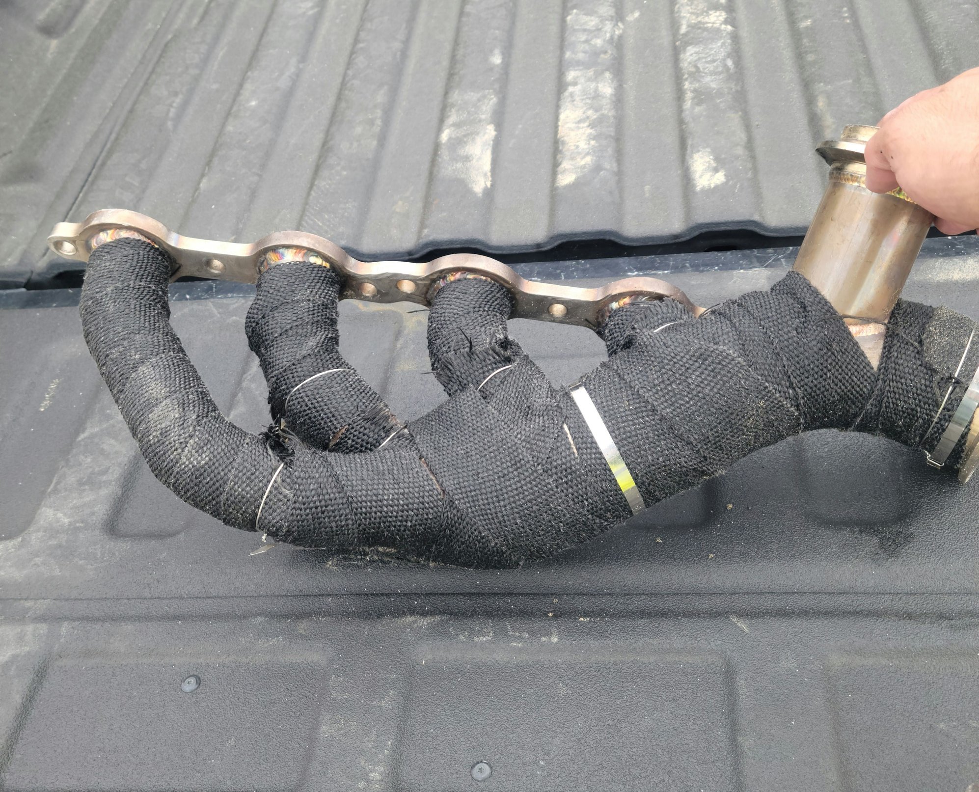

Originally Posted by Tommy42088
These?
Yes, rout them to the back, down around the manifold and up from the bottom.
If any of the pipes are still close, a heat sleeve may need to be employed as well.
There is a lot of really hot tubing all packed in that little space.

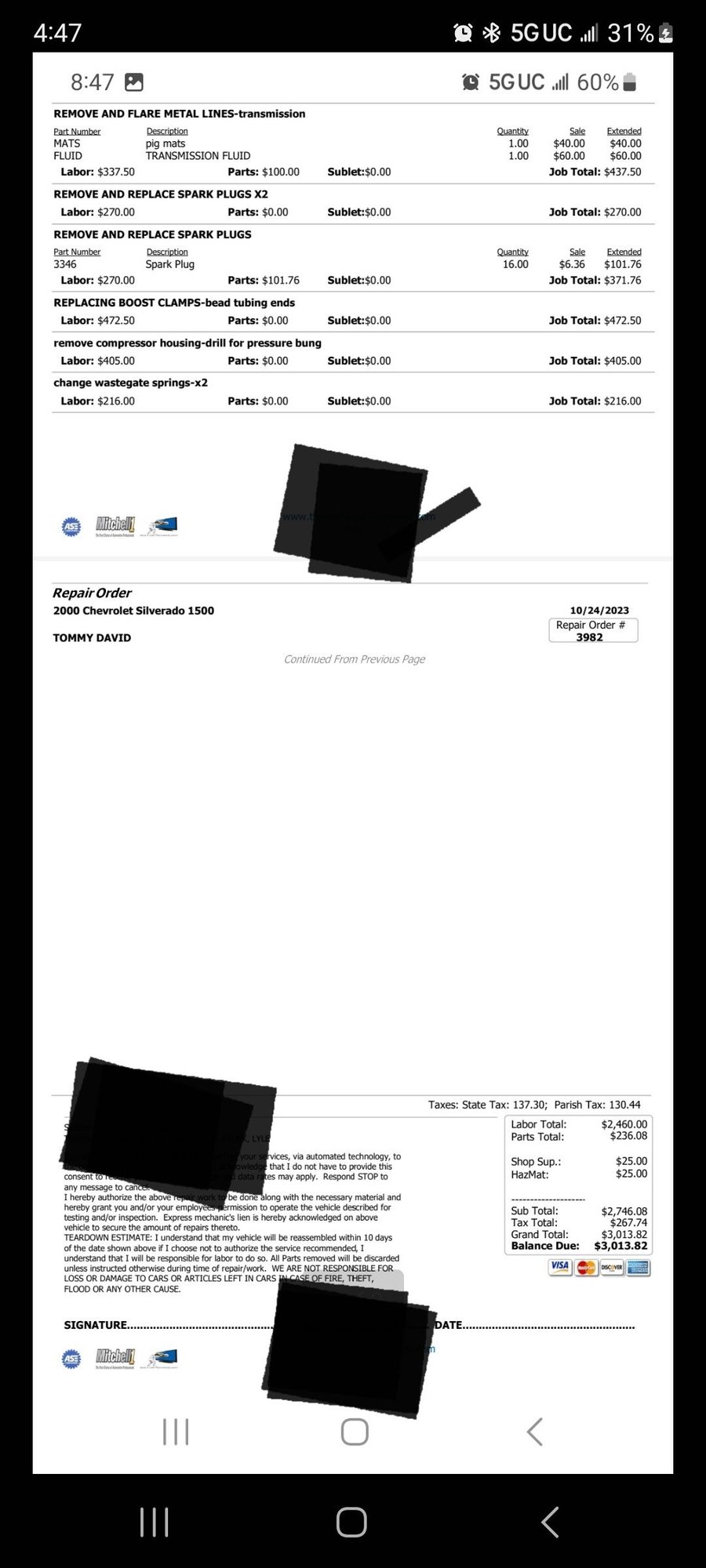

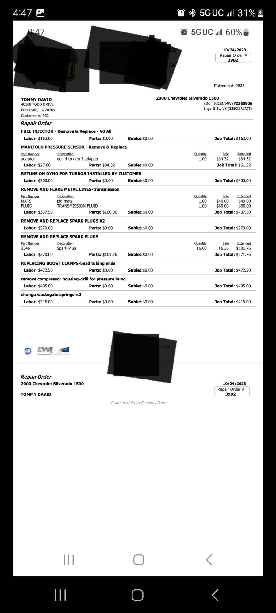

Man that labor seems a little wonkey in places… but reasonable in others. What is the shop rate per hour?
He is charging you $270 to change spark plugs? Twice? So $540 to change plugs? That’s seem odd. Also $100 in parts? Are they iridium plugs? $640 for plugs seems crazy to me.
Then what’s up with the compressor housing drill and tap? $405? To drill a hole and tap it? Is the compressor housing like insanely hard to access? I don’t see how this would take 4 hours plus to do. Drill and tap is a 30 min job plus the R/R of the housing.
IDK I’m in KS and shop hours are $80ish. I know not everyone is that lucky… but those items seem off to me.
that's my point man, some of the prices are ridiculous. Regular ngk br7ef plugs. The turbo didn't have a port om the housing for a vacuum line so he pulled the housing( 8 bolts) and put an npt fitting. Man that's 30 minutes worth of work. Seems like he charged me for trial and error on the spark plugs. Look on the top where it's shows the transmission fluids. He charged me for matts, I asked him what's that about and he said the transmission line came off the cooler and got fluid on his matts so he had to replace them, I guess he has to eat off the matts in his shop, there's alot on there that's ridiculous.
10-4 the only concern I see with this is the side that goes to the coils. I have the stock truck coils and the fitting that connects to mind doesn't have a 90 degree bend like that
You may have to look at relocating the coils, maybe to the firewall?
The factory harness may reach and then you'd have more flexibility with wires.
I know it's more work, but you could always double wrap that manifold, some guy's double wrap even the standard manifolds to knock down laten heat as well as keeping as much of the heat in the exhaust as possible.

I hear ya… shop consumables aren’t free. I’ve been charged for rags and mats before. I can see that. Not a huge deal there. Esp. if he had your car up on his dyno and your line popped and sprayed his equipment and floors. That’s a bastard to clean and not on them.
If they tried tons of different wires and spent 4-5 hours playing with plugs, I guess I could see those charges. Thats where communication with the customer is key. I’d of called you after the first wire/plug issue and asked you if you wanted me to continue to try with other plugs/wires/etc and informed you it was a time eater and that you could be looking at tons of labor, and still might not work. That’s the kind of stuff I’d asked the customer to drop by and look at. Given them the option to fix it and bring it back.
How long did they have it? Even at 100 an hour that’s 24 hours plus they claim to of spent. That’s 3 8hr days of nothing but your car being worked on. That’s a lot!
I'm definitely going to relocate the coils, I guess what I'm asking is if those boots with those 90 degree ends on the will snap onto the truck coils. The ls style coil boot is different i guess is what im trying to say
oh ok I guess I understand the mat thing then, i didnt realize that could be on the customer and the truck has been there for about a month but it Definitely wasn't worked on for that long. He's one of those guys where you drop the vehicle off and it takes 3 or 4 weeks before he gets to it. According to him he worked on it for 9 days. But for me I don't see anything on that list that could of taken that amount of time. What frustrates me the most about the hole situation is before I put the turbo on the truck I had a conversation with him about it and he told me to get this kit, I bought the parts he wanted me to use and installed them and then dropped it off so it's not like I picked random **** and then dumped it on him to figure out. He chose this kit, then turns around and tells me it's not going to work? That's bs

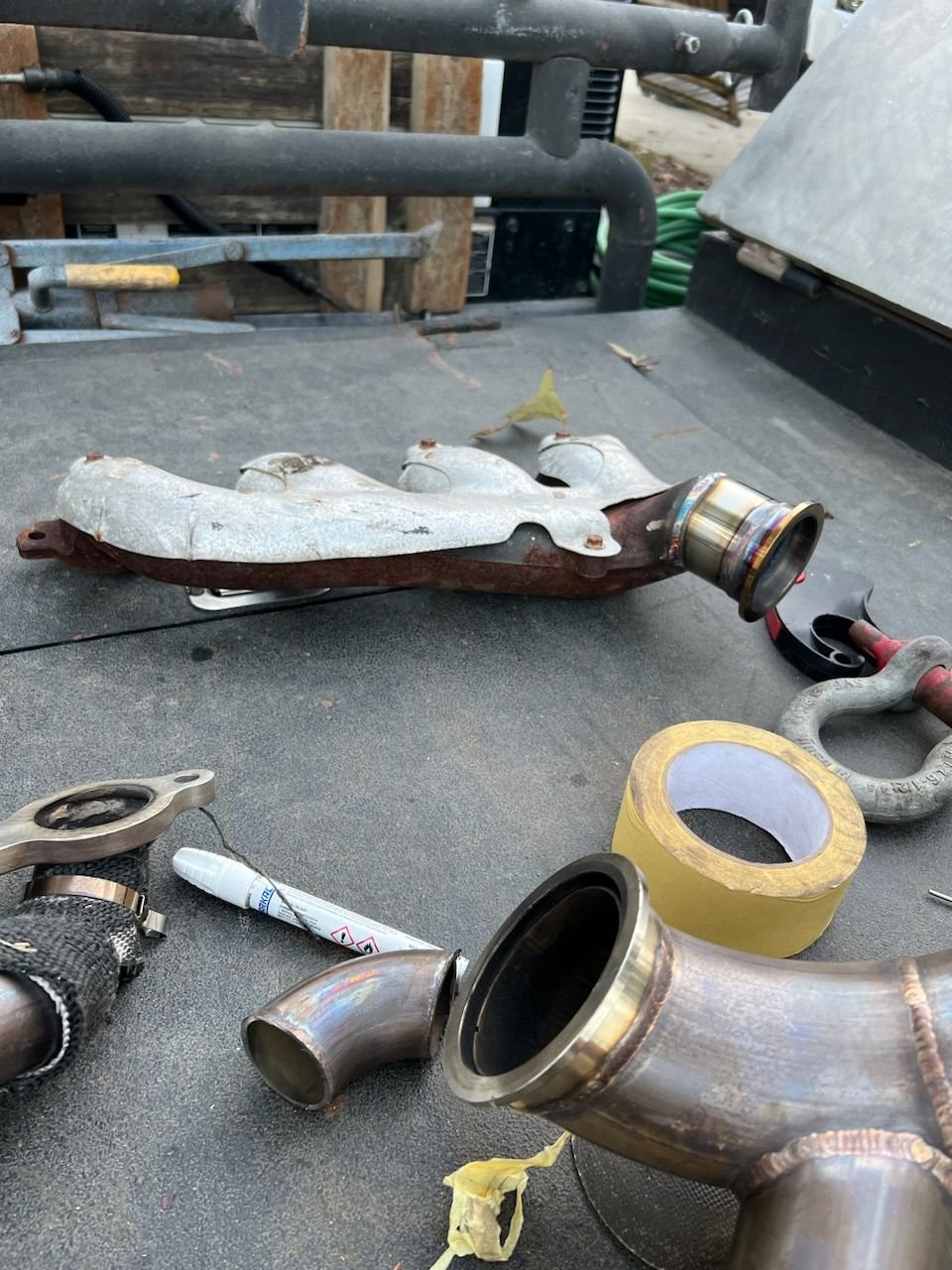

a
Welded a v band on a factory camaro manifold for the drivers side and had the passenger side completely re-done and they both clear now. Benefit of having a welder buddy
