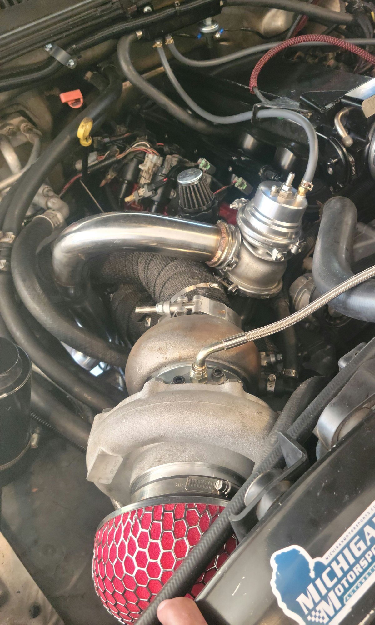

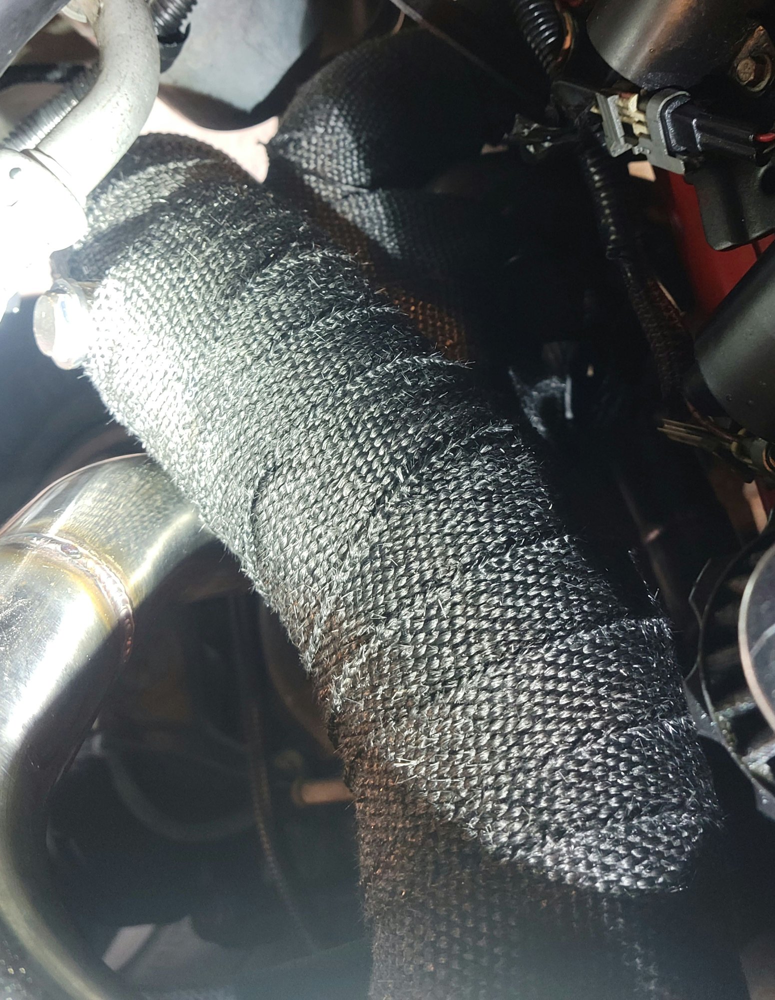

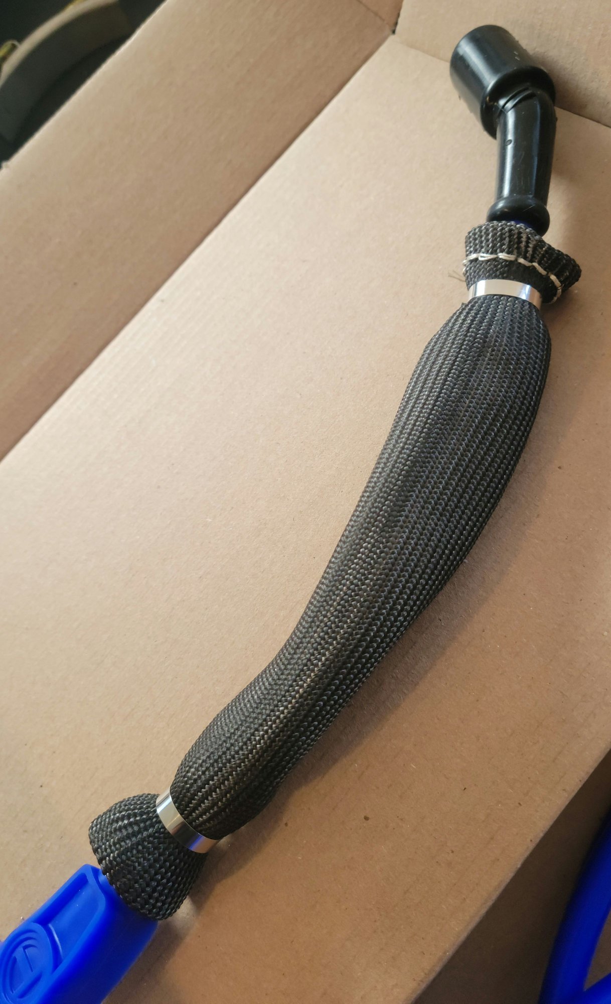

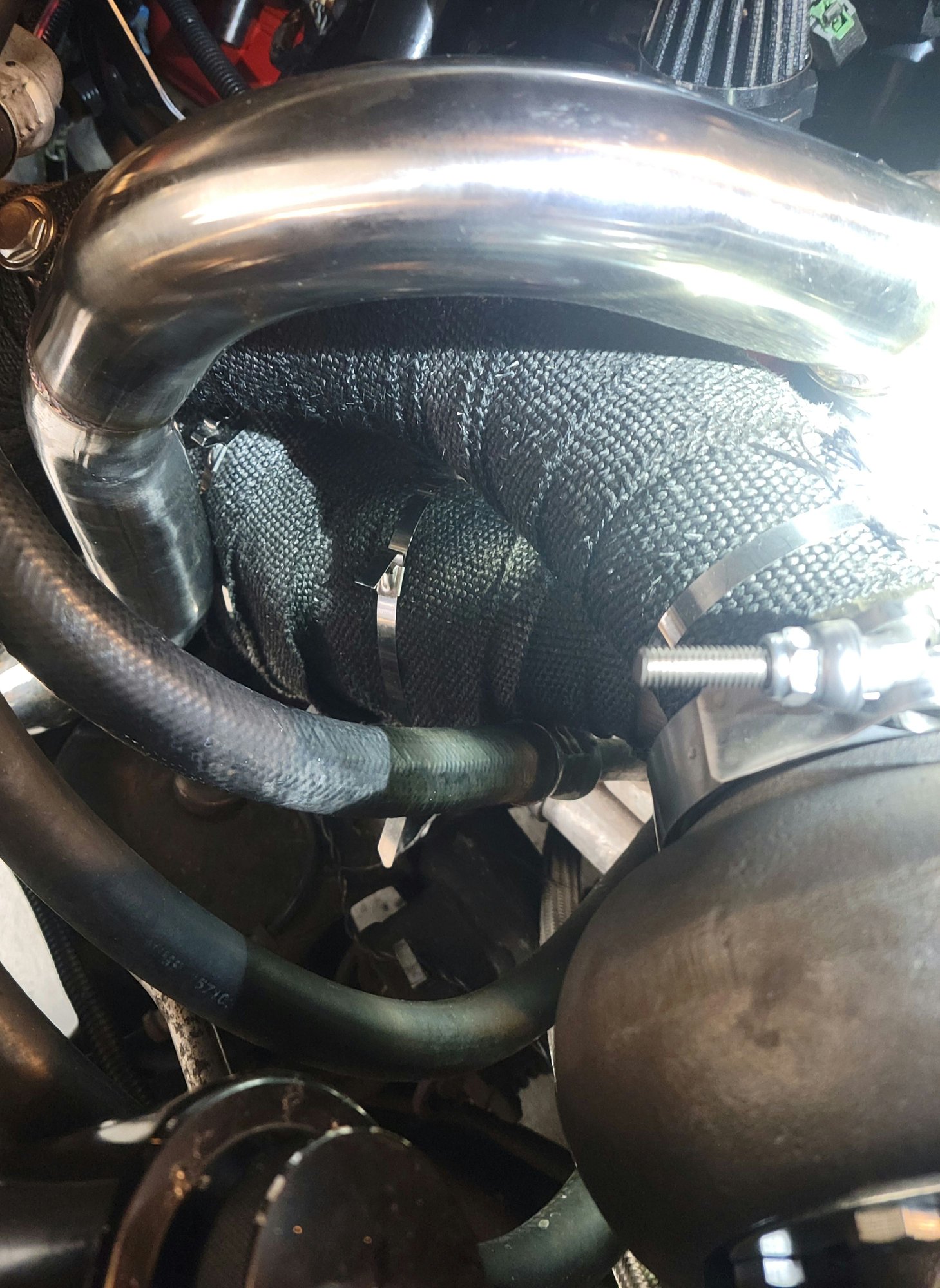

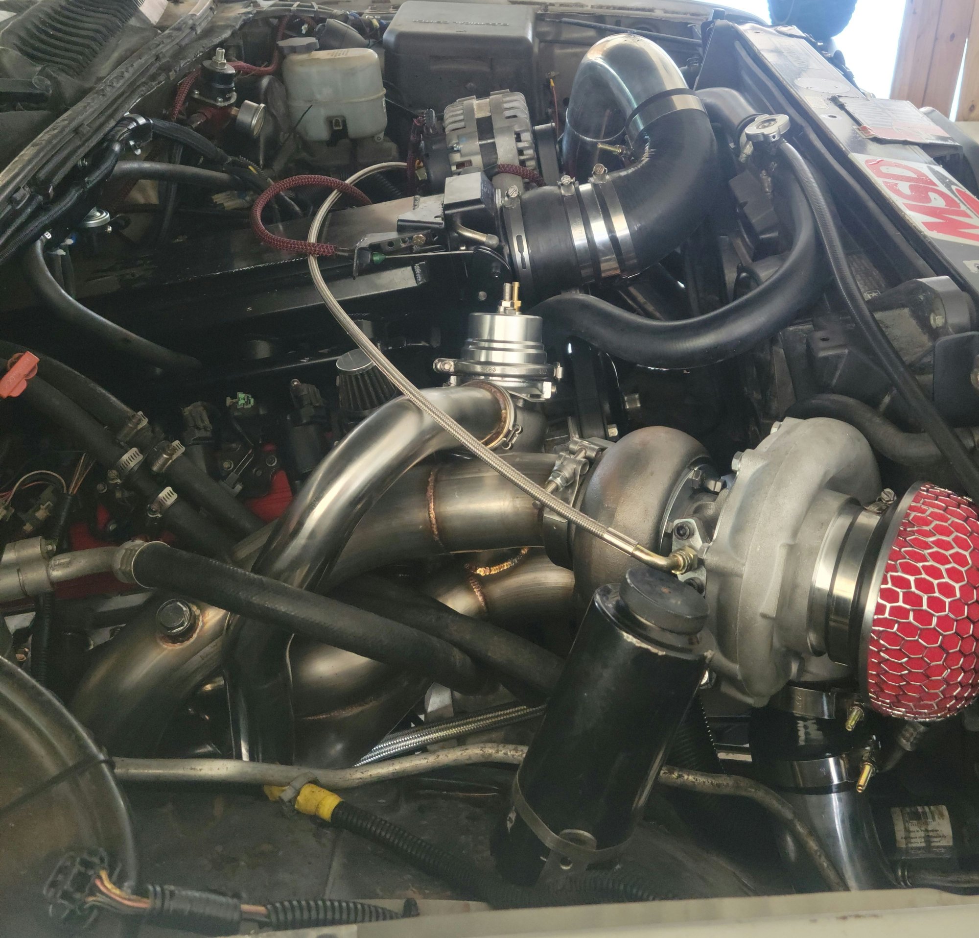

Pictures I took before I sent it to him

If it’s getting as hot as he claims it would absolutely annihilate those coolant and AC lines long before the porcelain of the plug cracked.
It sounds to me like he’s got the timing crazy retarded or running it super rich and everything is nuclear. I will say that kit would probably be served by a coil pack relocate and some good plugs with 90 degree boots.
