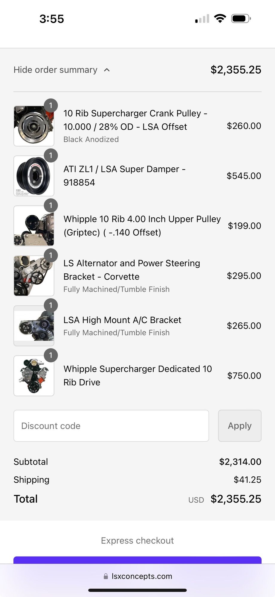

Guys I have a chevelle with a 6.2 true ls3 to a 6l90. I have a whipple on top and it’s kinda been a nightmare getting everything dialed in and getting an accessory drive that works and will prevent belt slip. I currently just have some ls brackets.com set up. Everyone is suggesting wegner but that’s a little too rich for my blood. I was told I could use lsx concepts stuff, however they want a similar price to wegner. I feel like I could just buy these items and it will work. Let me know if anyone has suggestions on what options I have please let me know. I am willing to spend 3k, but it depends. Please help with options guys.
This is a complete list of the parts I need.
https://www.lsxconcepts.com/products/whipple-supercharger-dedicated-10-rib-drive
https://www.lsxconcepts.com/products/ls-alternator-and-power-steering-bracket-corvette
https://www.lsxconcepts.com/products/lsa-high-mount-a-c-bracket-corvette

so your thinking use this from holly and the lsx concepts supercharger drive?
https://www.holley.com/products/ls_p...y/parts/20-132
