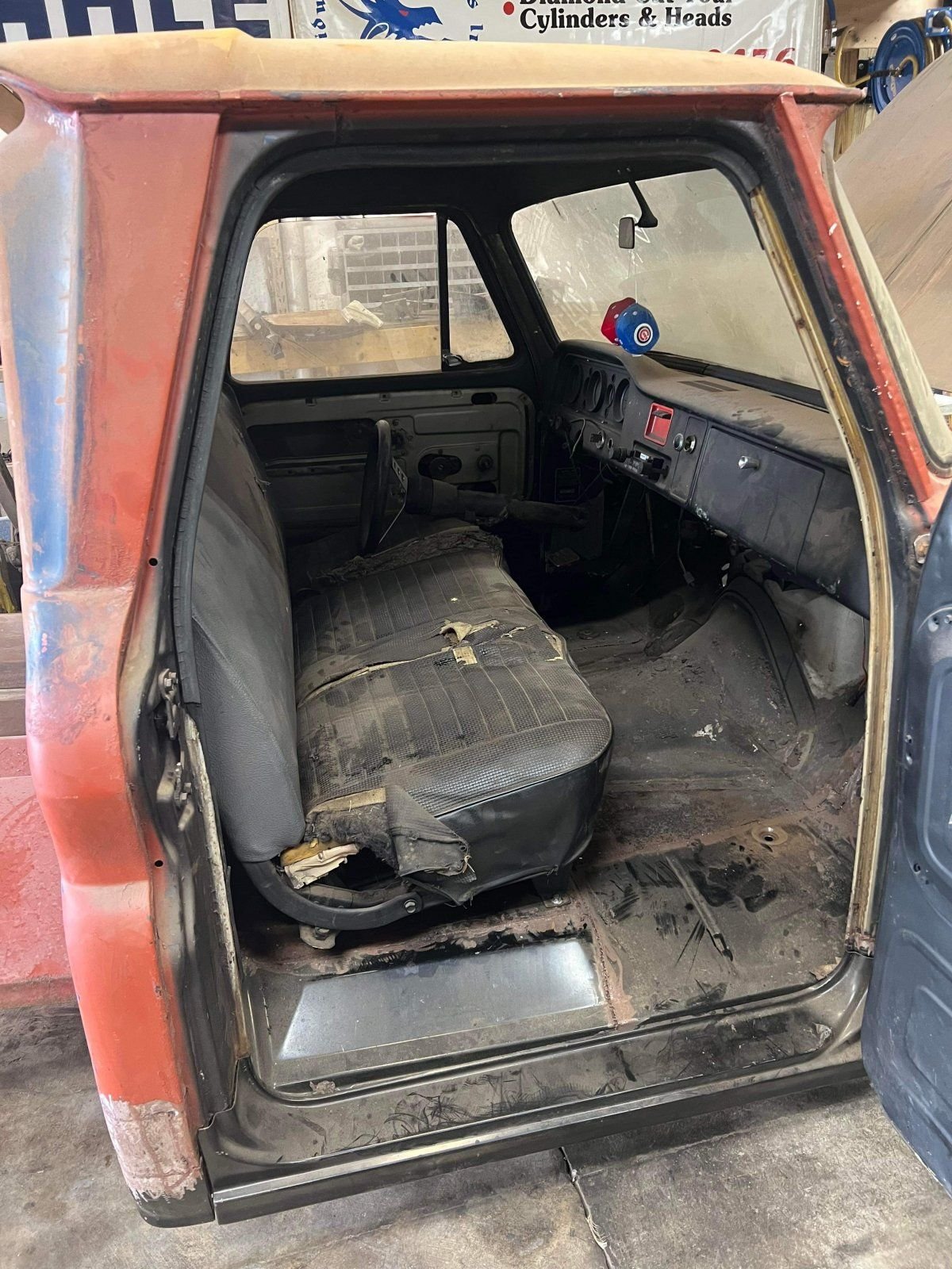

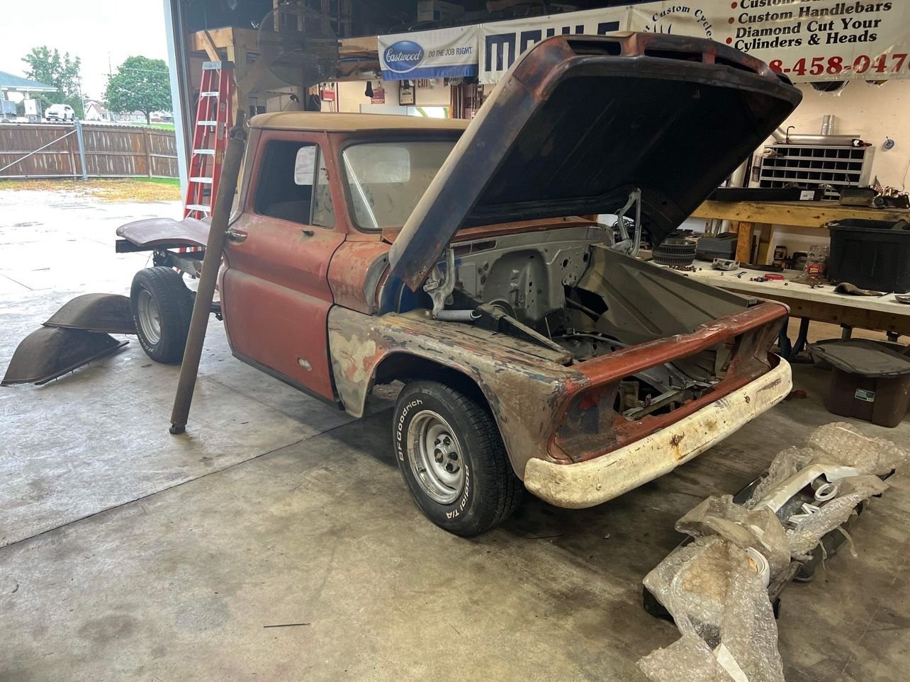

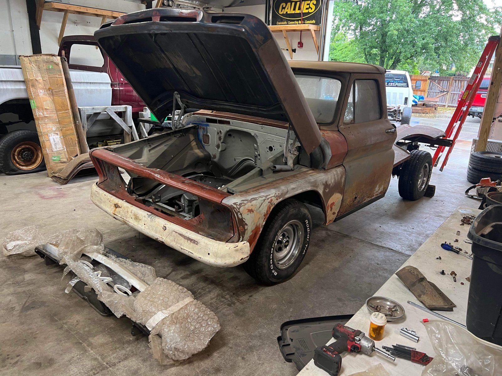

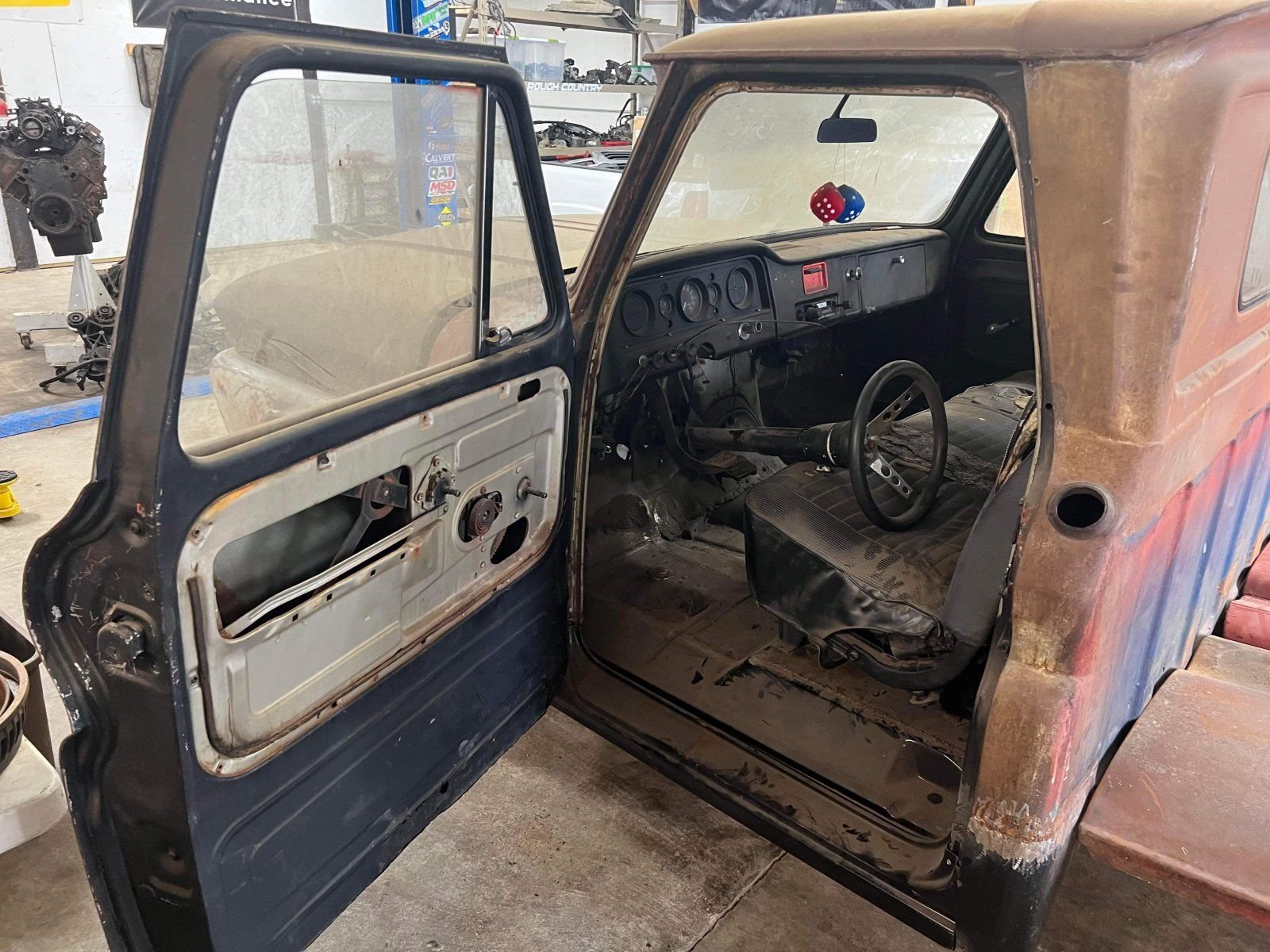

Here's some pictures of the truck when I bought it. I've done nothing with it yet as my oil burning LB7 has been my primary focus. That project is nearing it's completion so this is next on the chopping block.

Do you know if some one swapped the suspension, i notice it has 5 lug when it originally came with 6….either way it looks like a solid foundation and will be a fun project!!👍👍👍
I do not but I'm guessing it's part of the CPP disk brake conversion on the front that was done by the previous owner. I did order the Borgeson power steering conversion, CPP "street beast" hydroboost brake kit (front & rear disc prop valve), CPP brake lines etc.
