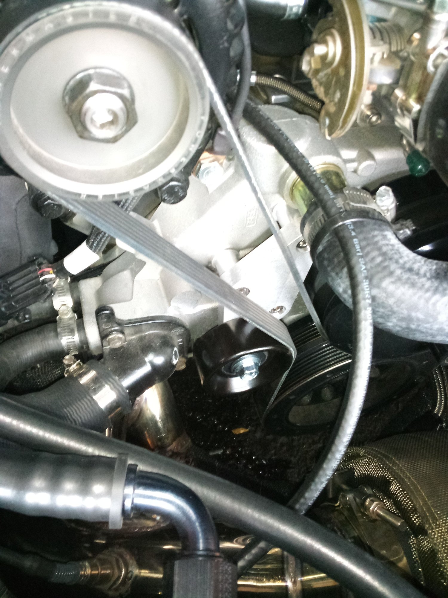

Cold weather has arrived in Michigan, so it's time for winter mods. One thing that became apparent very quickly with my engine is the front accessory drive was lacking belt support between the balancer and the top mounted alternator. Spinning 7500 RPM had the belt whipping so badly that it left witness marks in the paint on my thermostat housing, and on one occasion, pitched the belt and tore it in half lengthwise. Not to mention, looking at datalogs showed erratic voltage readings from the alternator at high RPM. I needed an idler pulley, but I couldn't figure out anything that would work. That is, until I found a small company that made the perfect product for what I needed. ( PM me if you'd like the name, I don't post non-sponsor info. ) It's a bracket with idler pulley that bolts right to the front of the water pump. Can't test the efficacy yet, but judging by the additional belt wrap on both the balancer and alternator pulley, it should fix all of my issues:
