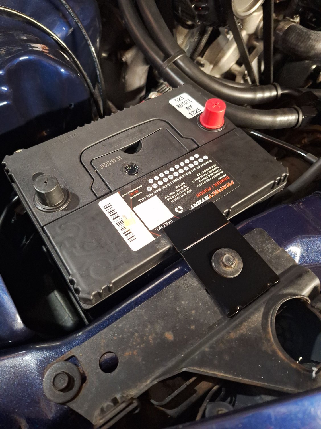

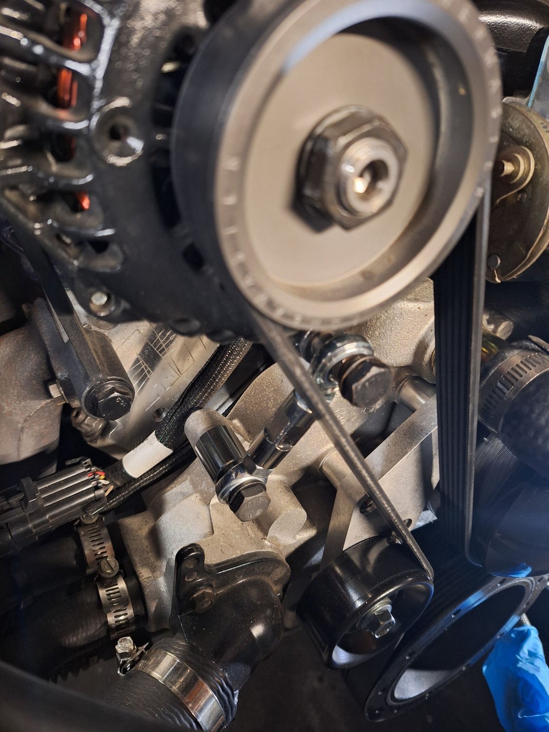

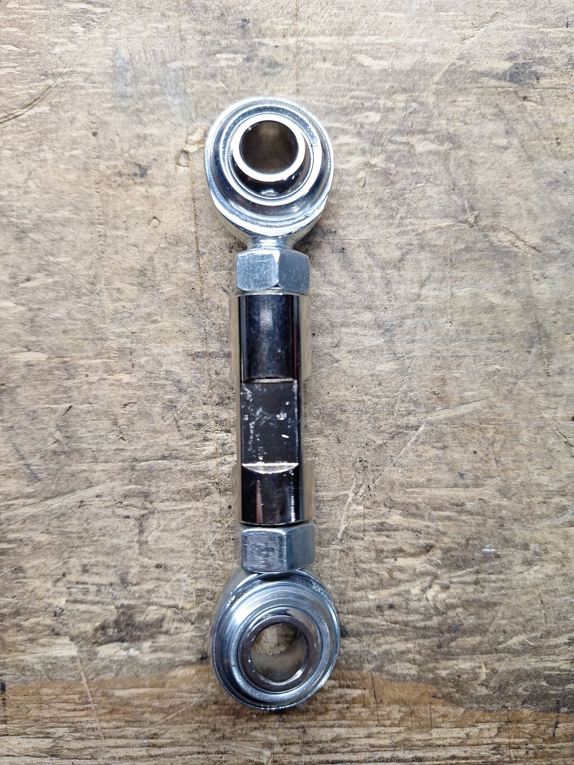

Haven't updated this thread in a few months, so I figured I'd add a bit to it. Every time I think about doing an upgrade, either something breaks or wears out and has to be put on the back burner. So no Hitmaster for me this year. Mostly due to my unfortunate miscalculation of running M/T ET Street R's on the street. $900 a pair, and 900 miles until cords were showing. I figured they'd last me until next spring, boy was I wrong. So I replaced them with Nitto 555 R2s and I'm much happier with them. I'll eventually get a dedicated pair of track wheels/tires and stick to the Nittos for street driving.
Another miscalculation I had was spinning my alternator too fast. This engine pulls like crazy up top, and I've hit 8000 RPM more than a few times, especially on the 1-2 shift. I originally just slapped on a 165 amp Powermaster alternator with the stock 2" pulley. Wrong move, as that got the alternator spinning close to 30K RPM. I went to a 3" pulley after that, but recently I found that it was dropping voltage over 5000 RPM. Ended up sending it in to Powermaster and they found that the voltage regulator was fried, likely due to the overspinning. Had them replace that and install a 3.5" pulley, along with a flat back plastic cover, as I had to modify the vented F-Body cover to fit up top on the passenger side. They have a pretty nice repair program, no labor and all parts are at cost. I just got it back yesterday. Prior to sending it out, I fixed an issue with the Huronspeed alternator brackets. The brackets are pretty beefy and work well, but there's no triangulation which allows the alternator to flex downward under tension. I remedied that with an adjustment rod and rod ends. Had to add a couple spacers to get enough angle to make it work. After install, I had zero flex from the alternator:
Another failure, but this time with a simple fix, was the coolant overflow/battery hold down snapped off like they tend to do. Hard launches with a heavy battery makes it inevitable. I didn't want to replace the coolant overflow without beefing up the battery mount somehow, and stumbled upon a perfect fix. My work had a huge amount of extremely strong brackets that were leftover from a long completed job and were just going to send them to be recycled. I looked at one and realized it would be perfect to chop up to make a holddown bracket for my battery. The steel is thin, but it's so strong it's nearly impossible to bend by hand. I had to drill a hole in it, and it was impossible to drill through it with a hand drill. I ended up using a die grinder with a carbide bit to put a hole in it. Lucky for me, the headlight mounting bracket had a bolt in line with the center of the battery, so I just used that. Looks pretty clean, and it's so strong I cannot flex the battery backwards, even with the original battery hold down broken:
Aside from that,I'm still working on my tune and figuring things out. My alternator problem was causing a fueling issue, as the voltage drop made the pump stop working as well. I have a Kenne Bell Boost-A-Pump on my secondary fuel pump, but when my voltage was dropping under 12V at high RPM, the primary fuel pump wasn't pulling it's weight. I am likely going to have to upgrade to twin 525 Hellcat pumps over the winter, as these Racetronix 340's seem to be tapped out and I haven't even started pushing the car yet. I have an issue with boost control as well, as it spikes on every gear change before settling flat. I'm using Holley's Boost VS. Dome control strategy, which seems like it should be able to tame the spikes down, but I'm still learning how it functions and have not settled on the correct settings to make it work right.

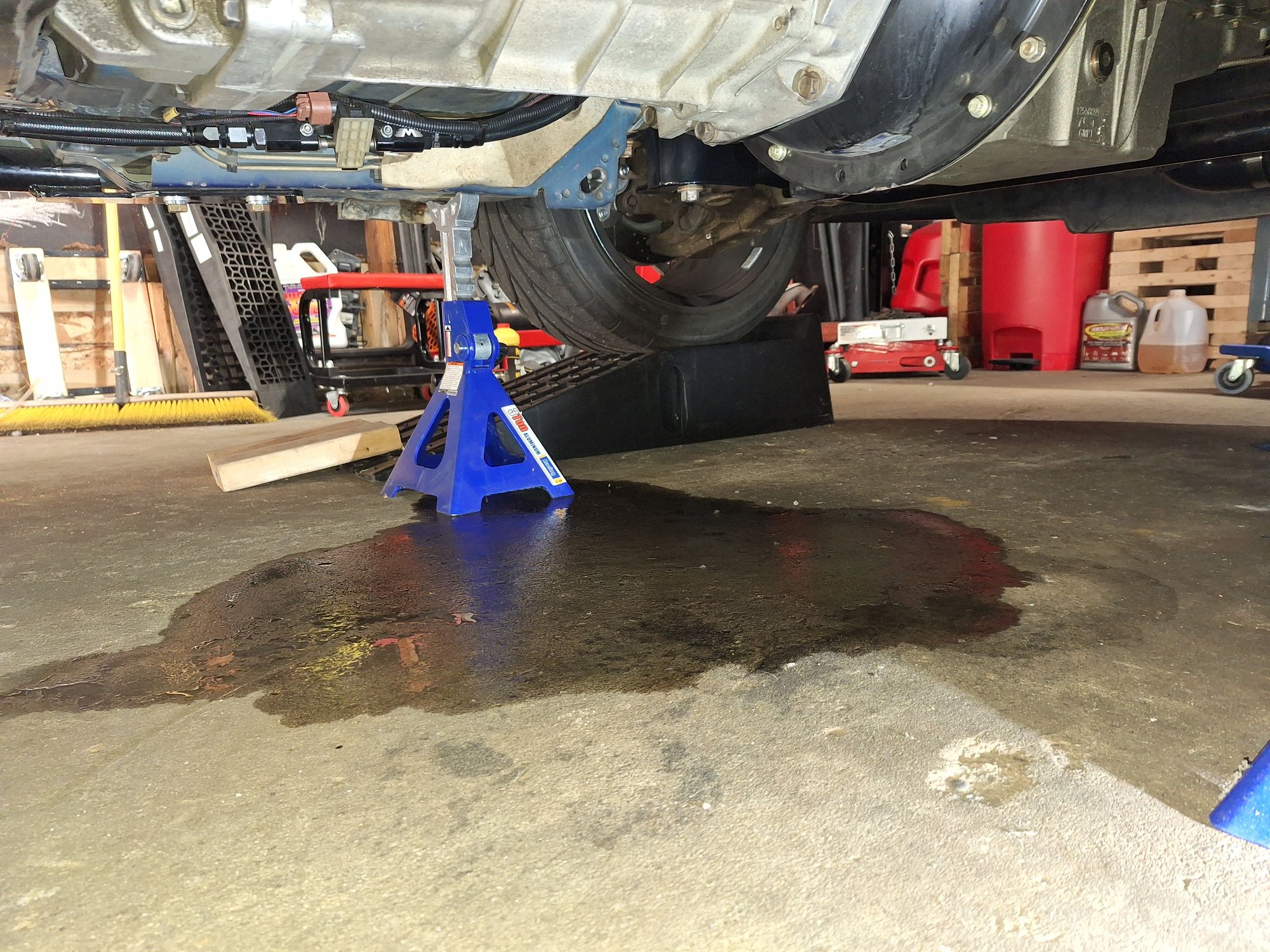

I did run a couple of PBs with the car about 2 weeks ago, even with the issues I was having with fueling. I did forget to mention in my last post that I'd went to 2 different tracks a month ago over 2 days, and each time I was having extreme fuel pressure drops that were shutting my car off ( so thankful for Holley's safeties! ). I thought it was just the voltage problem, but unknown to me at the time, I had a serious fuel leak coming from the # 8 injector O-ring. I had blown a collector gasket and got that fixed, and was idling the car on jackstands to get some heat in the exhaust so I could retorque the studs. I looked under the car to check for something and saw a huge puddle of fuel and fuel running down the bellhousing. I shut it off quickly and finally saw the fuel spraying out of the fuel rail. I can't believe I hadn't noticed it before. If you're having fueling problems, check for leaks! I am damn lucky I didn't burn my car to a crisp.
After that was addressed, I was able to take the car back to the track and make some passes. Prior to that, we had an event here in Grand Rapids, MI called Metro Cruise, which is like a smaller version of the Woodward dream cruise. They have a dyno available and charge $50 for 3 runs so I figured I'd slap the Firebird up there to see what it could do. I didn't want to push it, so I only ran 15PSI of dome which equated to 13.5 PSI of boost, but it still made 643 RWHP at that level, which is pretty good. I'm pretty sure it's over 700 at 18PSI of boost, which is what I was running at the track that night.

If I have to fix this one again, I'll probably do that, but I've already got it back and it's good to go. I added a 3.5" pulley so there's no way I'll overspin it. It loses some output at idle, but I don't really have a lot of crap running at idle so I'm not concerned.

So, with the new pulley on, I am seeing 13.1v at idle but as soon as I am above idle, it's putting out 14.5v. While I'm doing low speed cruising, it never drops below 14.4. I hardly ever sit at idle, except maybe at a stoplight. Once I swap my rear gears out, I am likely going to return to the 3" pulley because I doubt I'll have issues with overspinning the alternator after. I am consistently seeing 8000 RPM on the 1-2 shift because of how fast it revs, I apparently cannot react quickly enough to my 7K shift light to get a gear change made, lol.
@wlink14 , it's pretty likely you fried your regulator. That's what happened to mine. I took it in to be tested locally and it tested out fine, but they don't spin them very high so at low speed it was putting out 14.4v. I returned it to Powermaster and under their testing they found the regulator bad. I'd just upgrade yours like you'd said but add the bigger pulley. 3" seems to be the sweet spot for sub 7K operation.

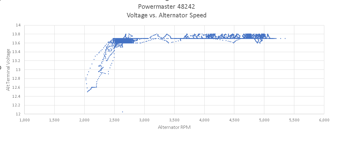

The powermasters have a voltage drop-out issues below a certain RPM. I f-ed with this for probably 6 months before getting fed up and just instrumenting the car up to dive in. The punchline is that you have to be particular about the larger pulley size and too big, you are just driving around on the battery. Min speed (at the alternator) I found needed to be 2,500 rpm. The downside of this is that it implies the operating window of the powermaster is not great - when selecting a pulley, either pick low-rpm voltage drop out problems or overspinning. I chose overspinning mine a smidge.
https://ls1tech.com/forums/wiring-st...tage-drop.html
