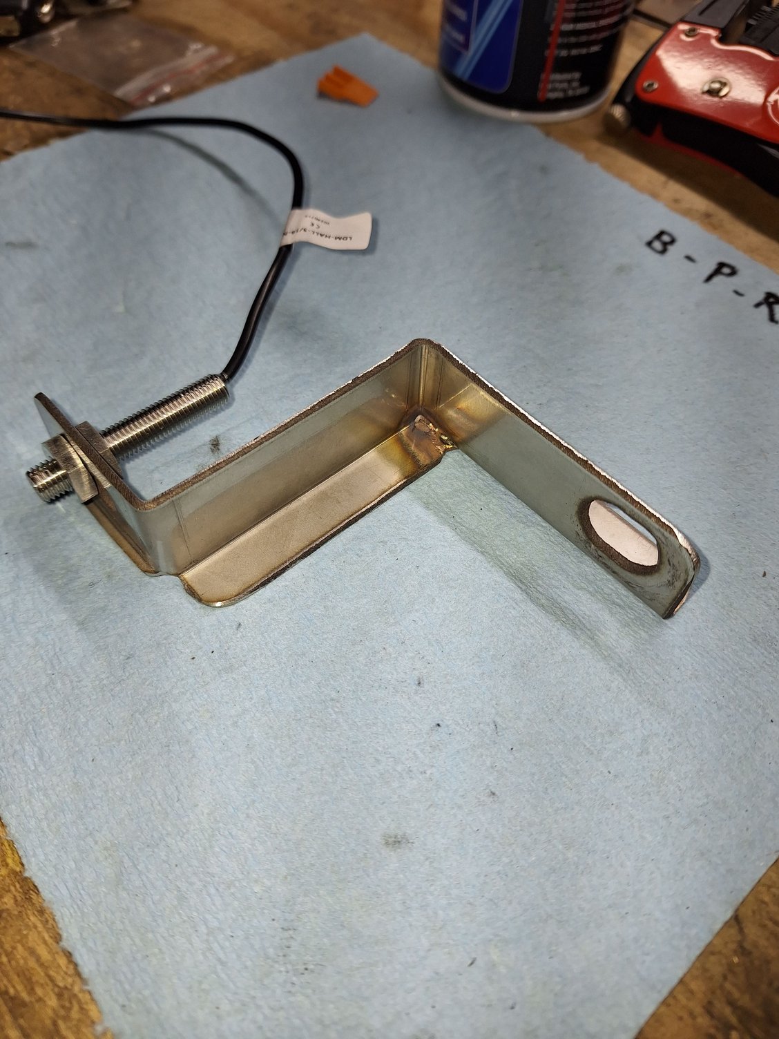

As for mods, I have a few planned. The first one, which I've just finished, was adding a driveshaft speed sensor. I just wasn't expecting it to cost me so much and be such a pain in the ***. I'd purchased a Strange pinion yoke with a machined step to mount a reluctor wheel. I installed it, tried to reinstall my driveshaft and found that I only had about 3/8" of travel until my driveshaft bottomed out. The Strange pinion yoke moves the U joint cap mounting surface forward about 1/2" from a standard yoke. So now I had to buy a driveshaft. Lucky for me, I knew a member on here was looking for a driveshaft to mate a T-56 to an S60, so I sold my old one to him. After that, I found another member who had an aluminum PST shaft for sale that was the correct length for my needs, so I bought it. It came without a slip yoke, so I bought another Sonnax slip yoke and installed it, and the new shaft fit perfectly. At this point, I purchased a Low Doller Motorsports 32 tooth reluctor wheel and sensor, and did some cardboard prototyping to figure out a mount. Took the cardboard "part" to my fab guy and he whipped me up a mount in about 10 minutes. That includes drawing it in CAD. Having all the right tools certainly makes things faster! I was lucky my prototyping was accurate, as the part just barely was within adjustment to get the sensor to pick up. It worked perfectly, though. I'd thought ahead and ran wiring this past summer for the sensor, so it was just a matter of adding a connector to the sensor wiring and pluggin it in. Configured the sensor in the Holley software and it was reading pretty close to what my dash speedo reads. I'll have to wait for nicer weather to determine if it's reading the same as my front wheel sensor. I figure it will take a bit of number juggling to get them to read identically.
