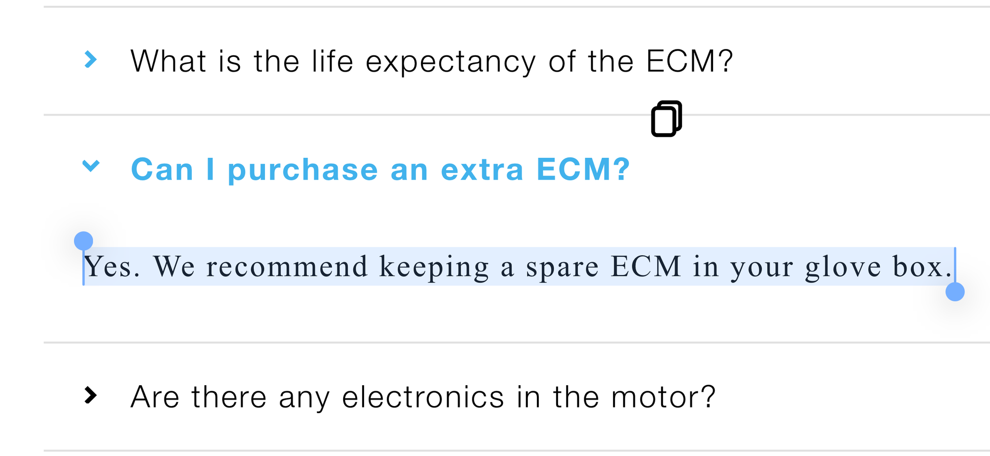

yea, they even recommend you to keep a spare ecm(s) in your glove box. For $150 each, you might as well keep 2 or 3. (Rolleyes).

Just playing devil's advocate, I think when Delta Pag recommended spare ECM's, he was referring to a race car application where the car is constantly being worked on in the pits when time is a factor, and you can't unhook all the grounds to weld etc.
At least that's kind of what it sounded like to me.
maybe. But I don’t see any other manufacturers recommending keeping a spare “whatever” in your glove box. Honestly threw up a red flag to me before trendsetter had his go out. Sounds like a problem part if they recommend keeping a spare. To me that yells stay away.
does holly say keep a spare ecm in your glove box? I could go on, but you get my point lol. Just doesn’t sound reliable if you have to keep spare parts on hand like that. Then when Trend had a problem, ole boy told him it was his fault and he could kick rocks.

Yup, that's exactly right. In racing and extreme hotrod world where people are always working on something, welding oops is a factor. Also, after +10k hours, if the fan fails, you could be up and running in no time, anywhere. Btw in 3k hours (avg life of a conventional fan), when another manufacturers fan fails, what do you do if you're on the road? $h!t out of luck. Or do you carry a spare fan and get it replaced on the side of the road.
The motors on the Delta PAG fans last for 50,000hours, longer than most cars. A spare ECM gives you peace of mind.

if i had a dollar for ever time I've welded on a vehicle building exhausts, turbo kits, mounts, suspension, brackets, frame connectors..... I'd be able to buy a set of those fans. In all those instances i've never unhooked anything, factory ecm or aftermarket ecms and never once had an issue. But I'm a professional jerryrigger though who likes to live on the edge I guess. In all seriousness, if I need at keep a spare $150 ecm for a $500 fan because its a common failure.... I'd have to say that I'll take a hard pass on that. I'd rather get something else that isn't so problematic that I gotta keep expensive spare modules on hand. Yikes!
